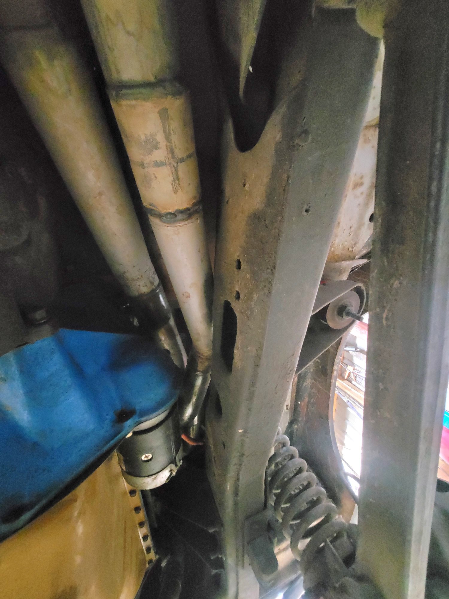

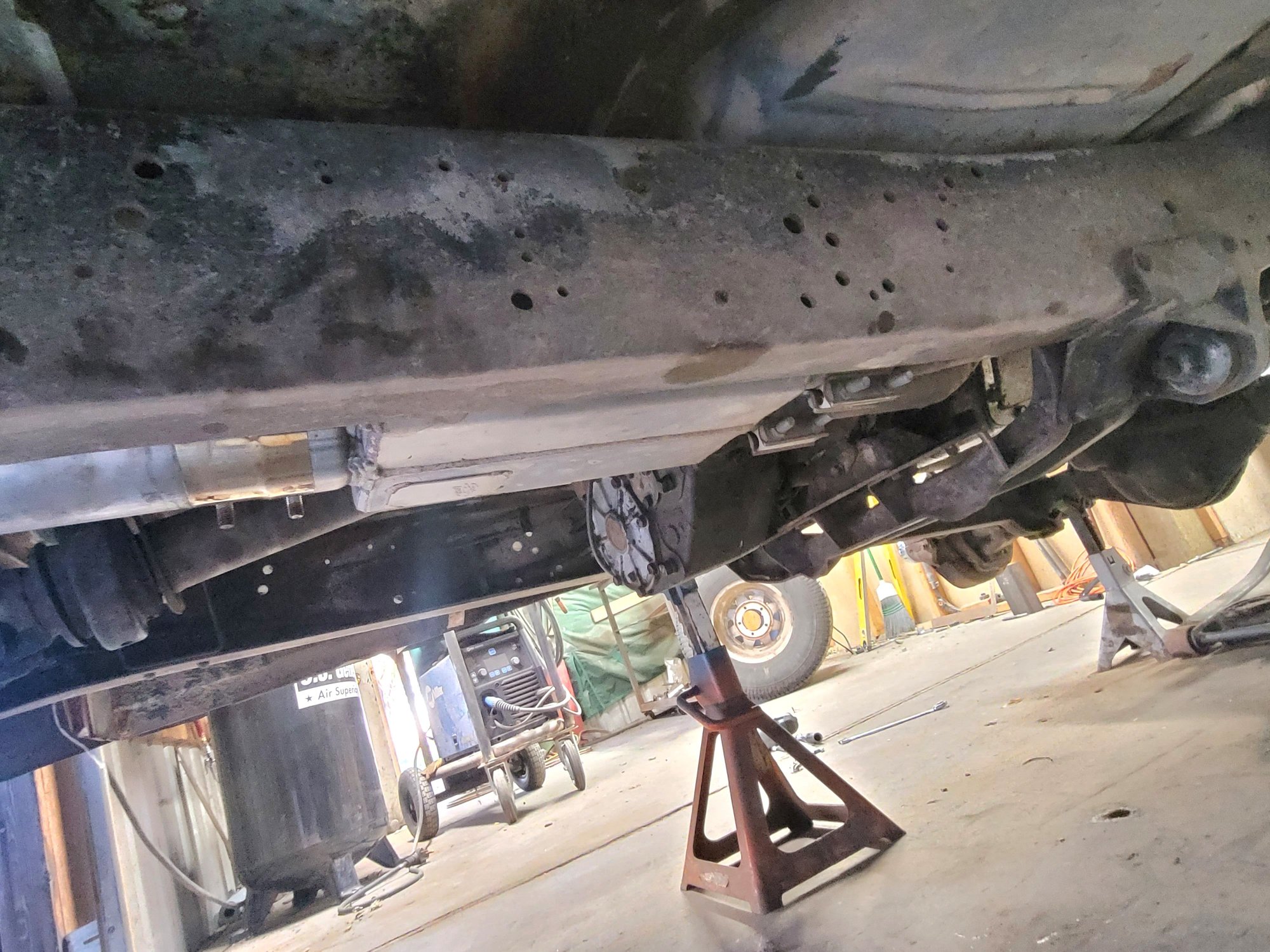

Looking for some opinions on exhaust options for my 1977 f100. Has a 5.0 high output/small c4 combo, no saddle tank just rear tank. Does have longtube headers that have 3" collectors. All the exhaust shops around me want anywhere from 800-1000 not including mufflers or tips. Been digging around for bolt on systems but am coming up empty handed, anyone have any suggestions?

Just saw your pics. In front of the tire is cheaper.

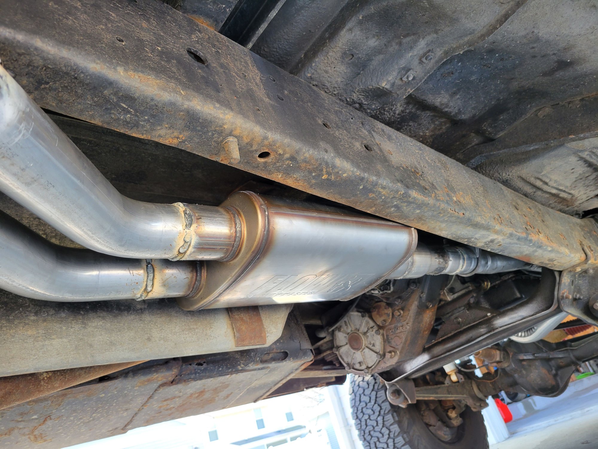

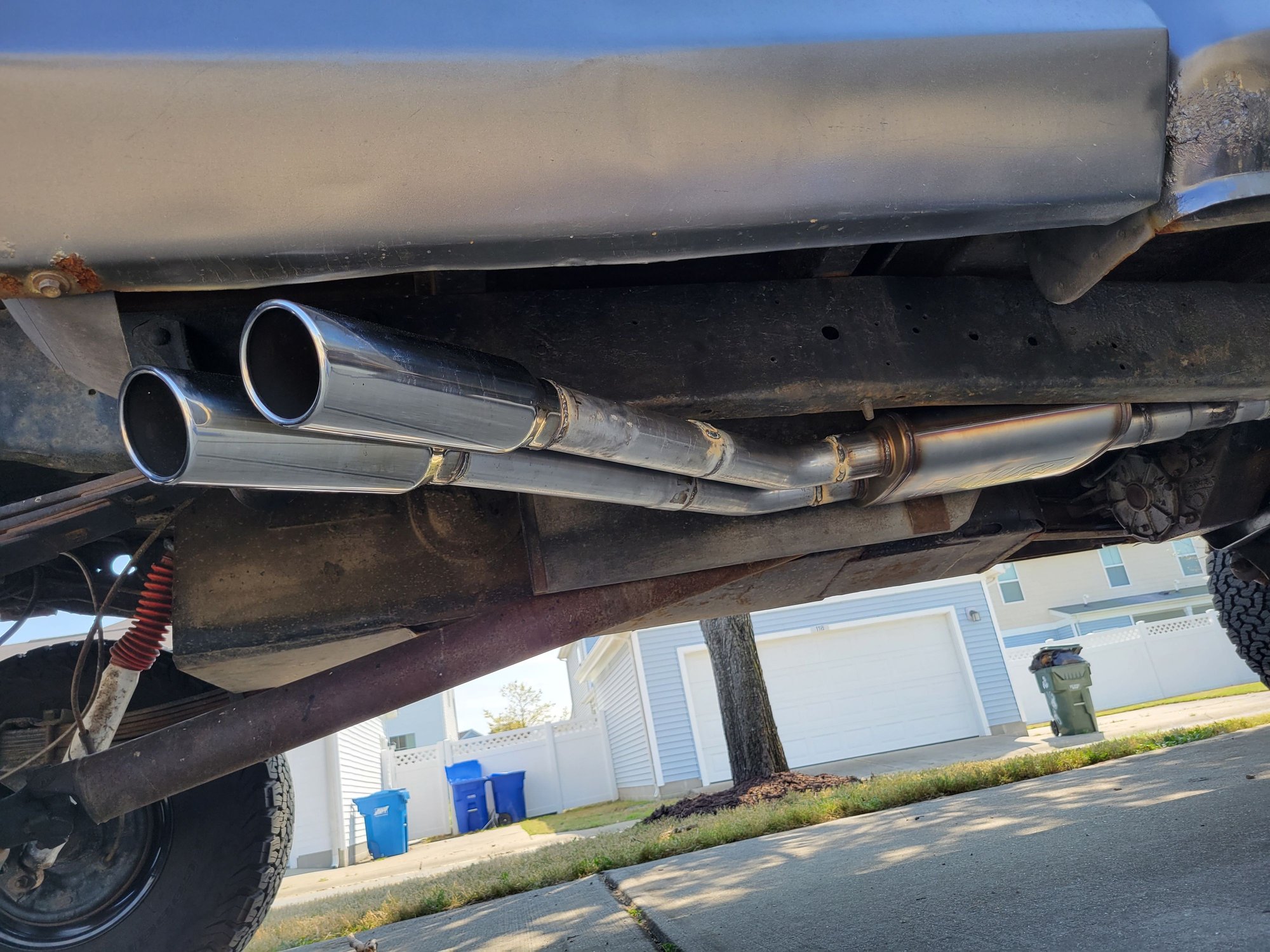

Heres mine.
Dual 2.5 to 4" back to 3" resisinator at axle dump.
I like ti follow the frame lines and muffler hanging down wad driving me crazy. Was a fair amount of work plumbing pipes from manifolds clear frame starter and fire wall.
This probly isnt the average exhaust job as modt will tie into factory crossover or into headers. Hanging down.
I do more Diesel stuff so this little 300 found 4" on it then a 3" resonotor cause its to loud lol. People think its a v8 im like nah a 300 6 is all.
