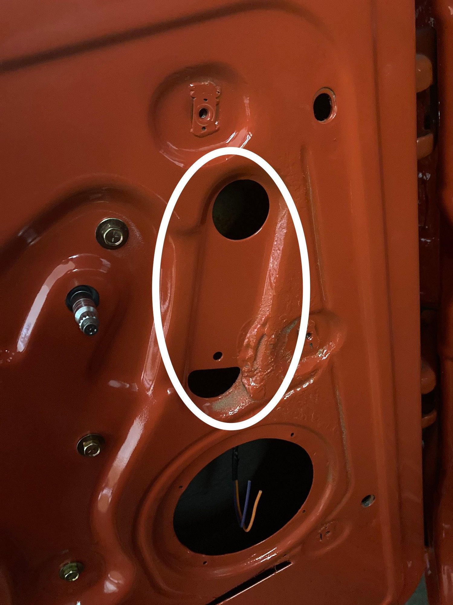

Before I continue reassembly I’d like to make sure I’m not missing anything obvious… Can anyone tell me what goes here? I’m guessing some sort of remote controller mechanism for a specific type of mirror. Thanks!

Unless power windows or remote mirror, not used that I know of.
I've not ever seen them used but puts me in mind of wire harness routing.

Reminds me of manual remote mirrors in the 60s, idk if ford did them like that in the 70s.

Yeah it would make sense for them to have multiple applications for that die. I’m convinced it’s nothing for me to be concerned with. Thanks!

It seems like the speaker wiring came out that big hole and back into the door in the half circle hole. With a little push in clip in the small hole. The original speaker wiring had several connectors in it and I think the last one to the speaker was in the area outside the door but under the door panel. Keep in mind most of these trucks used to have a tar paper type of weather barrier stuck to the door behind the door panel and I am guessing this is how they exposed wiring connectors for trouble shooting to save time.

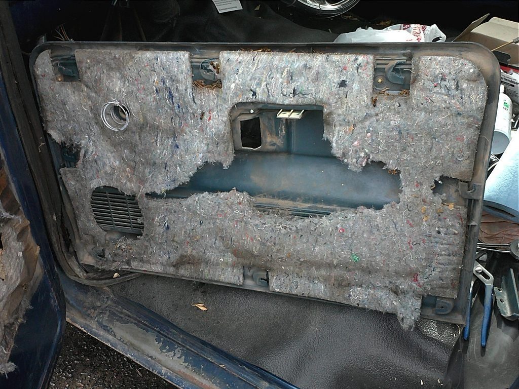

Posts: 530
Likes: 89
Something like this, in case anyone wonders if the contents behind their door have been gone through before. I'm pretty sure this truck hadn't been messed with prior to my ownership. If I still had it, I'd go see what was in that spot. Oh well! The only thing I know that wasn't OE behind the door panel was the mass of dead bees you can see at the top of the panel.
