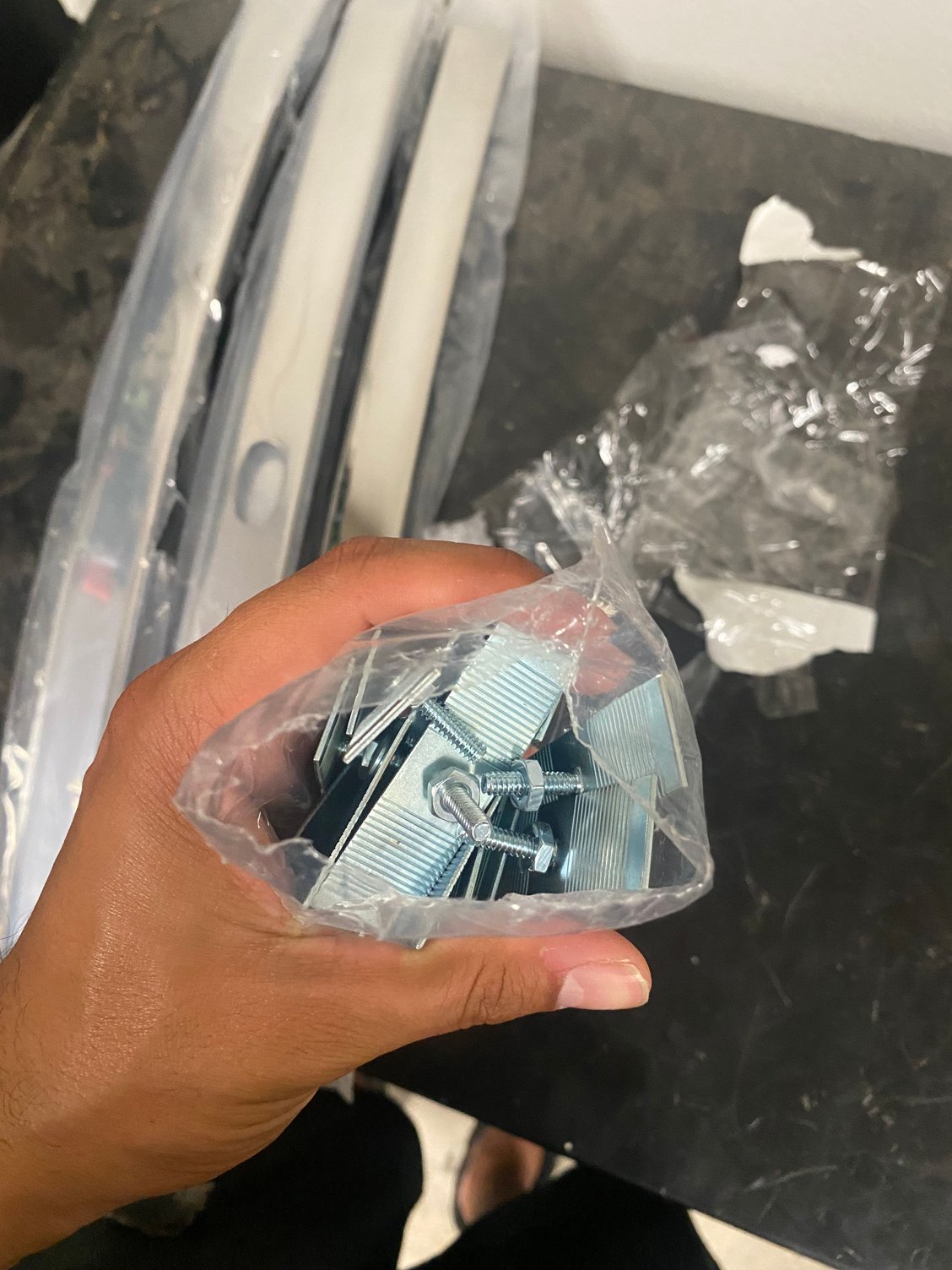

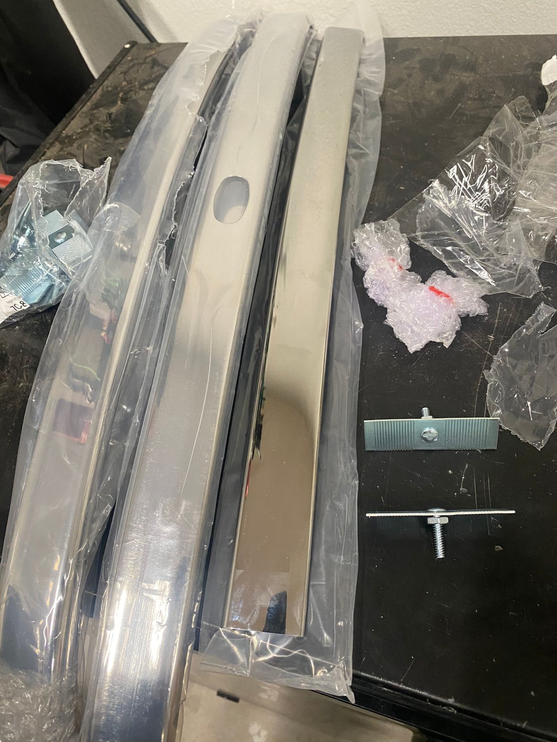

I just bought these and was wondering how you all have installed them.

It's been 20 years since I did a set but from memory, you drill the original grill bars for the bolt diameter in the center of the bar.
Break off tabs equally top and bottom on the scored lines so your bolt location matches the hole you drilled vertically. Don't break off too much or they won't stay in the cover. Then slide the clips down the length of the stainless covers to match the holes horizontally.

Just like Mtflat says, don't break off too much of each clip. Test each clip and number them if you'd like. Drill the holes at appropriate spacing to pull the bars in tight. And don't worry about making too many holes with trial and error, they will never be seen once the bars are on. Use just the ones that you like. The bars will probably have a slightly different contour than the grill, but that is probably normal. As long as they are centered and consistent with the others on where they 'lay' against the grille they will look just fine.

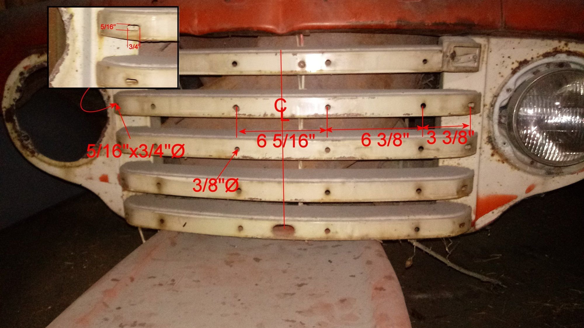

I just put a set on my 49. Here is the hole lay out.

I decided to drill mine because the bars where straight but had little dents all over them
