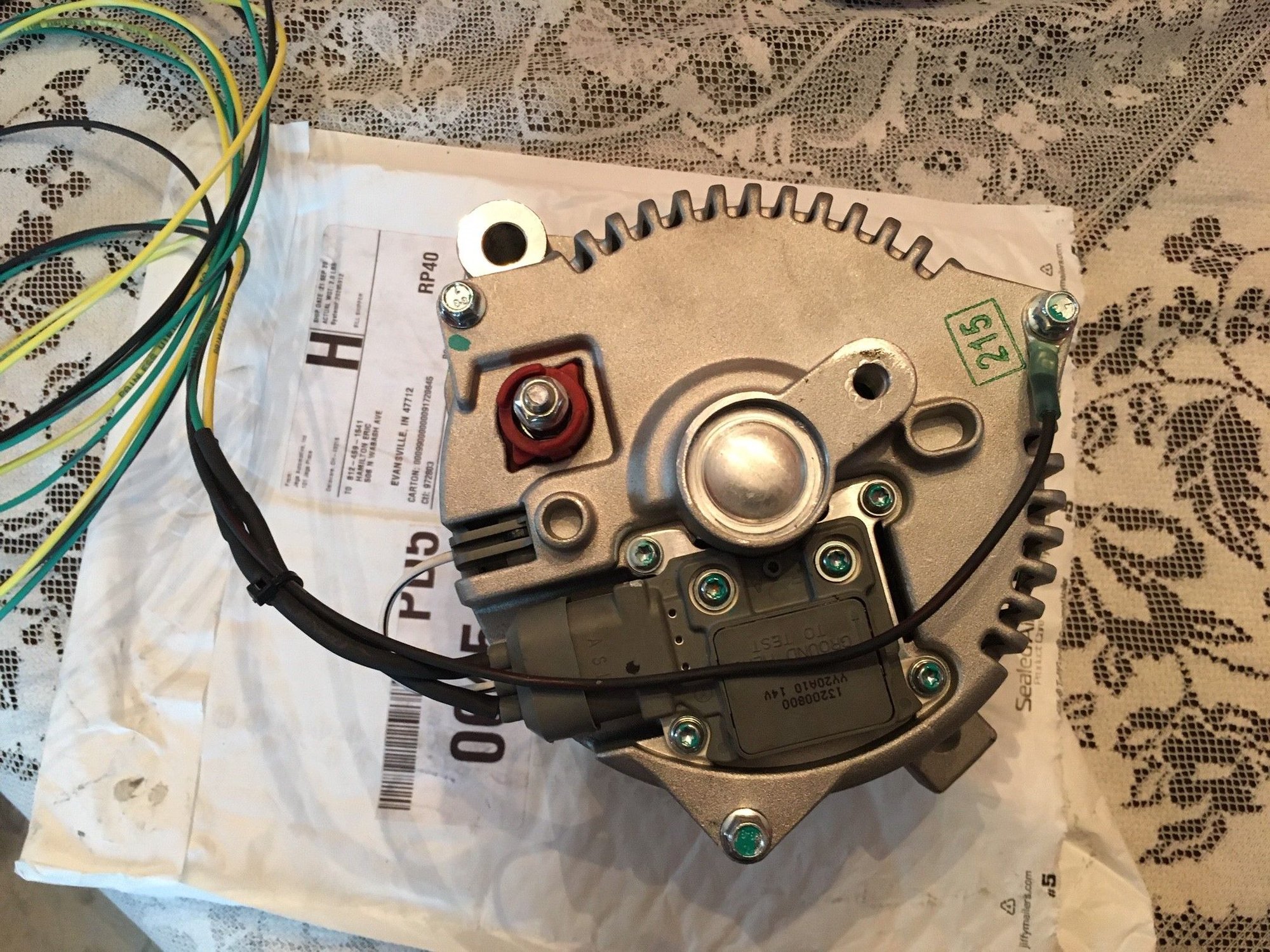

I got mine from Oreillys for a 94 Mustang with a 5.0. This wasn't the cheapest bet, but has a lifetime warranty. I also purchased the painless wire harness for converting to 3G. This came with good instructions and took out guess work and other misc. purchases. Check out this thread too that I did on the swap. https://www.ford-trucks.com/forums/1...isconnect.html
You'll loosen the 3 bolts and 'clock' the alternator so the plug is easy to install and not against the block. Not a big deal, but take your time and be gentle.
With the 3G upgrade I added a ground from the engine block to the frame. No more flickering lights and it charges perfect. I did disconnect the amp gauge as it's not made for 12v power. The only down fall to the upgrade in my opinion.
