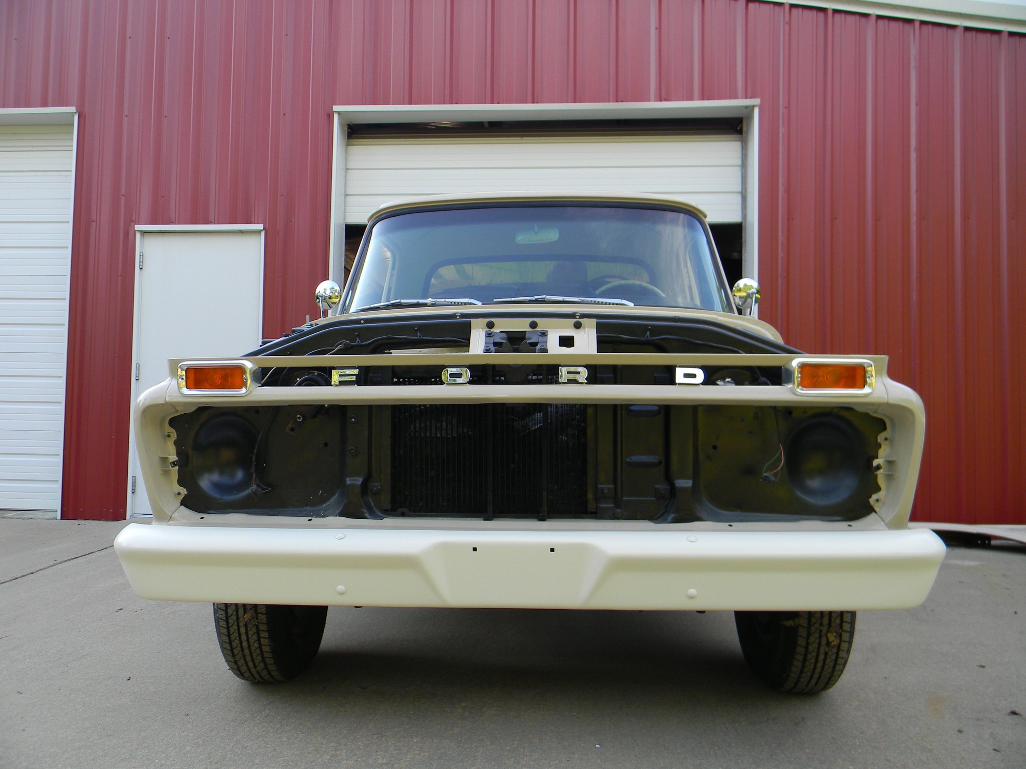

Hey, I have a 1966 F100, it’s Wimbledon White now but was a slightly darker cream color originally which is still visible on the interior No idea why the previous owner didn’t respray the original color.
Behind the grill it’s a mixture of the darker cream and the Wimbledon White as the the previous owner didn’t remove the grill and just sprayed through the grill even over the horn. It looks terrible. I want to paint it black but don’t know where to end the black as the engine bay is the darker cream.
Did a ‘66 ever have black behind the grill if the engine bay is the exterior color?
thanks

When it left the factory the firewall and hood underside were the only parts that were body color. Rad support, inner fenders etc. were all black.

Use a satin black, not high gloss.

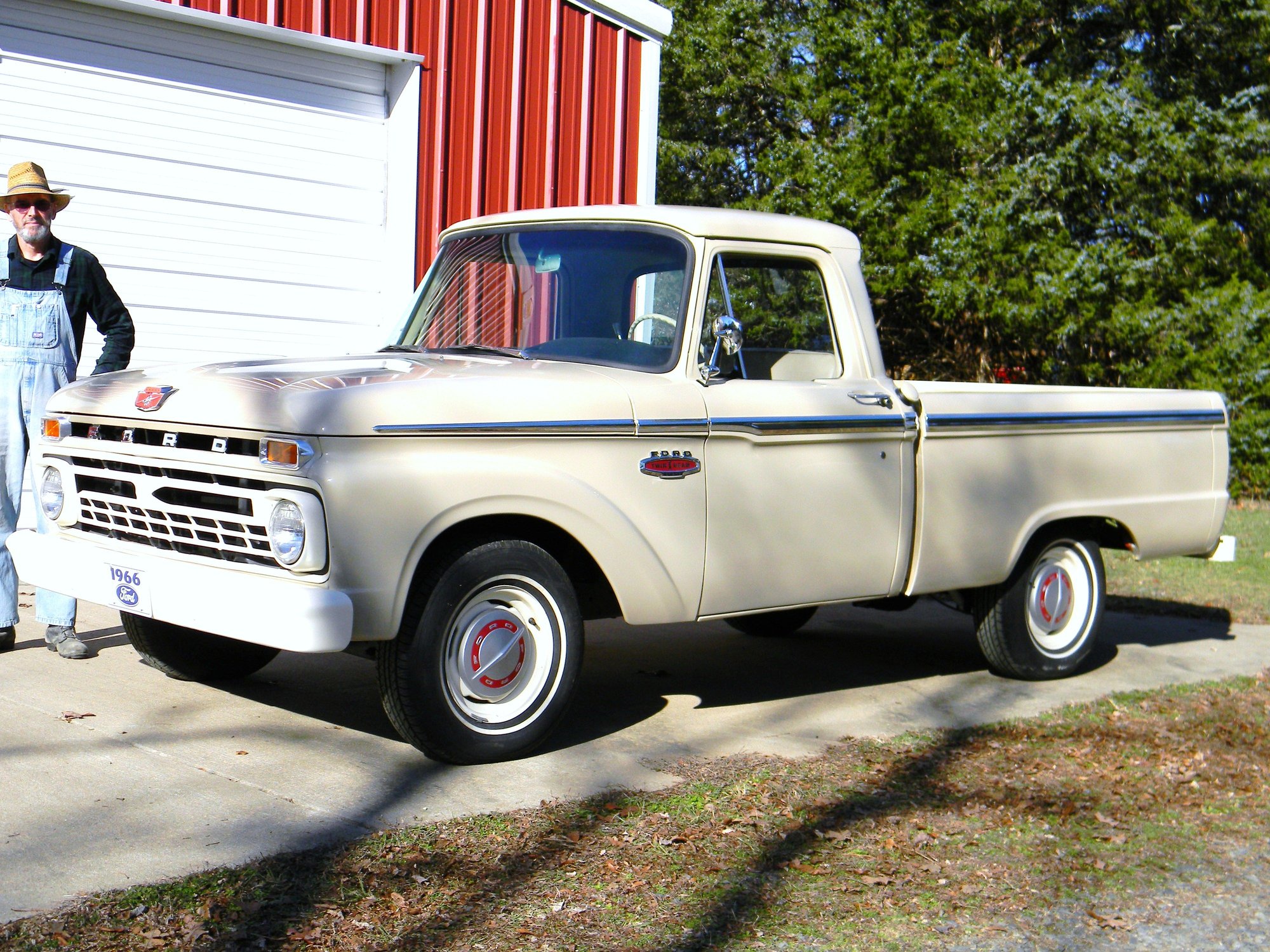

Originally Posted by stonewalljac
Beautiful, is the Cross Country the 4x4 and with a crew cab? Can you show me the bonnet catch please so I can work out what’s black? Thanks

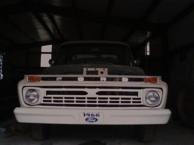

Couple more questions
Is FORD on the tailgate White?
White wheels?
Is your grill matt white?
I appreciate mine isn’t a Cross Country and wouldn’t haven’t been like yours originally but I love the white and cream.
White wheels?
The grill, bumper, and wheels are paint satin Wimbledon White.
