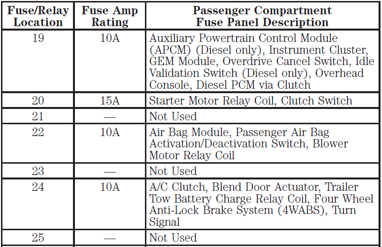

I took the images below from page 149 of the 2000 owners manual. It indicates fuse 25 is not used.

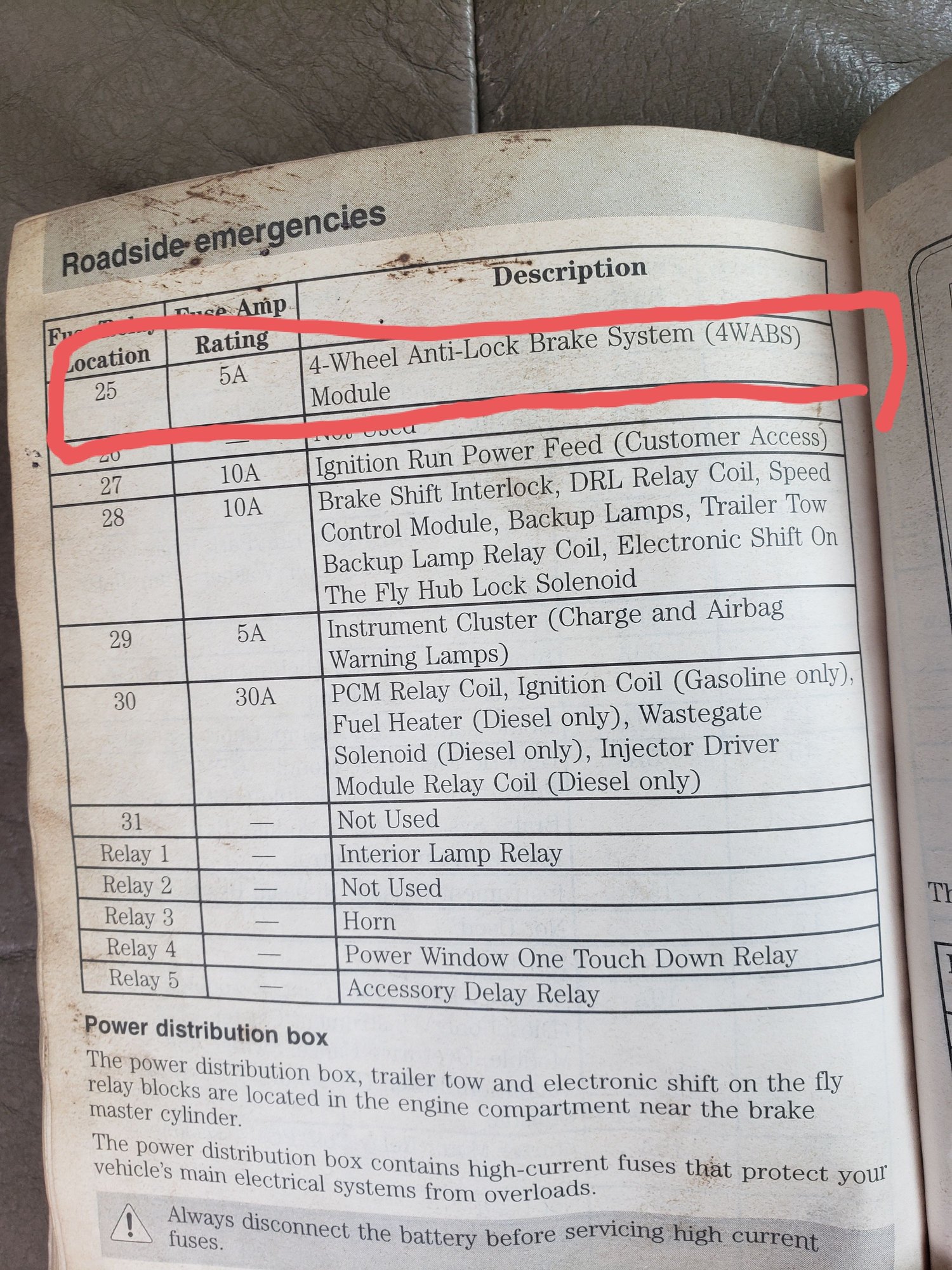

Interesting. So do i need to buy a new owners guide set from Ford now? I did pull the owners guide set with diesel supplement from an identical truck i had known for a long time, just a '99 vs my '00

Update, i just looked on Ford's website and looked at different owners manuals 99-01 and the 1999 model year does use that fuse location, 2000+ put the abs on fuse 24.
So I will be getting a manual for the 2k model year when i can, and NOT reference the 99 book for fuses!
I wonder if this another early 99 vs late 99 difference...

Between referencing the wrong owners manual, not getting things tight enough on the backside of the fuse block, and a random left over 25amp fuse that had no home, or location even calling for a 25 amp fuse, things are working again as far as i can tell.
