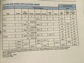

Are you sure it is in first and not in limp mode? Can you manually shift into different gears or are still only in the one gear? Manually selecting 1 and 2 engages different clutches than if you were in drive.

Placing the shifter in 1 has the same result as drive? I’m no transmission expert but that doesn’t make sense to me. According to the chart you should still have reverse since it doesn’t use the same clutches. I would test the MLPS before throwing the transmission in the scrap pile.
