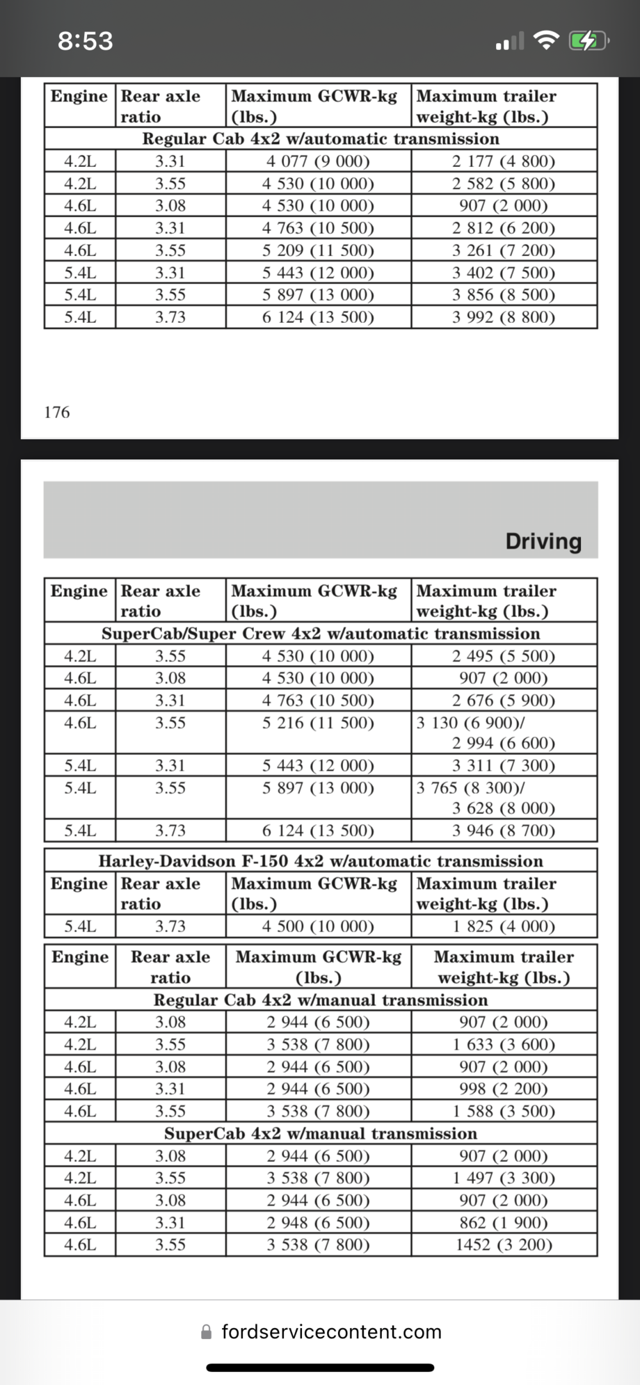

That’s not entirely accurate. A 4.2/5-speed/3.31 gears is rated for about 2,000#. A 4.2 with 3.55 gears as well as the 4.6 with 3.31s backed with 5-speeds rate for 3,500# if memory serves correctly.

My 02 4.6 3.08 rear end is only rated for 2000 LB towing.

He asked what was the towing for a 5.4 not a 4.6 lot of difference there

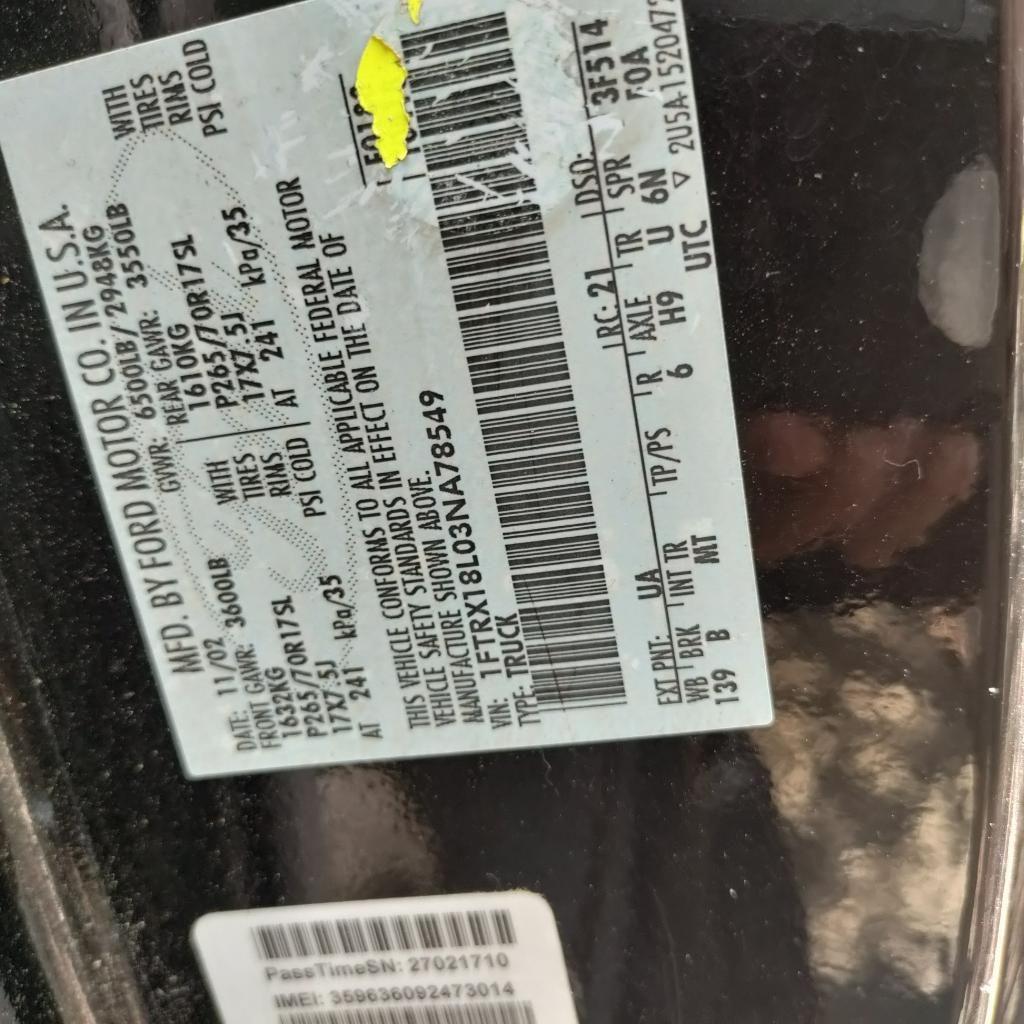

op also forgot to mention the
3.55 gears
automatic
as well
