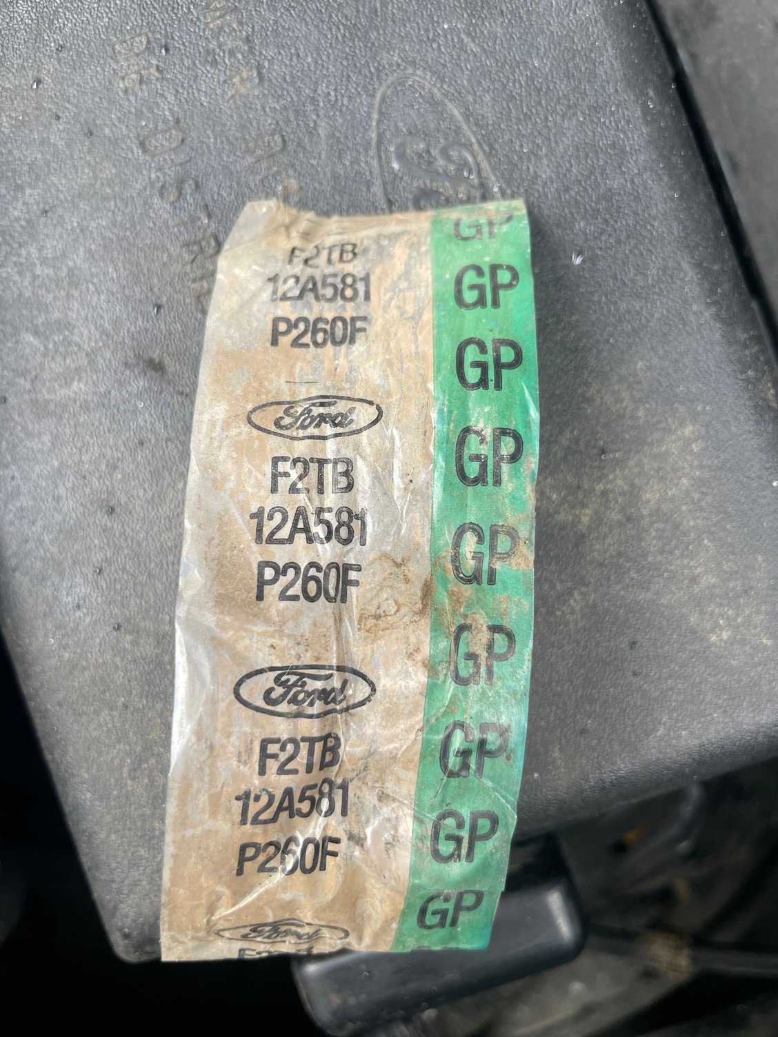

As mentioned above, a quarter horse can do the job, but if it is still Speed Density, you would be much farther ahead to just put the right cam in it. If it is MAF, you probably have a bit of research to do before doing much of anything. One thing you really need to be sure of is the computer and it's current tune/strategy.
There will/should be a tag on the connector of the computer with everything you need to know.

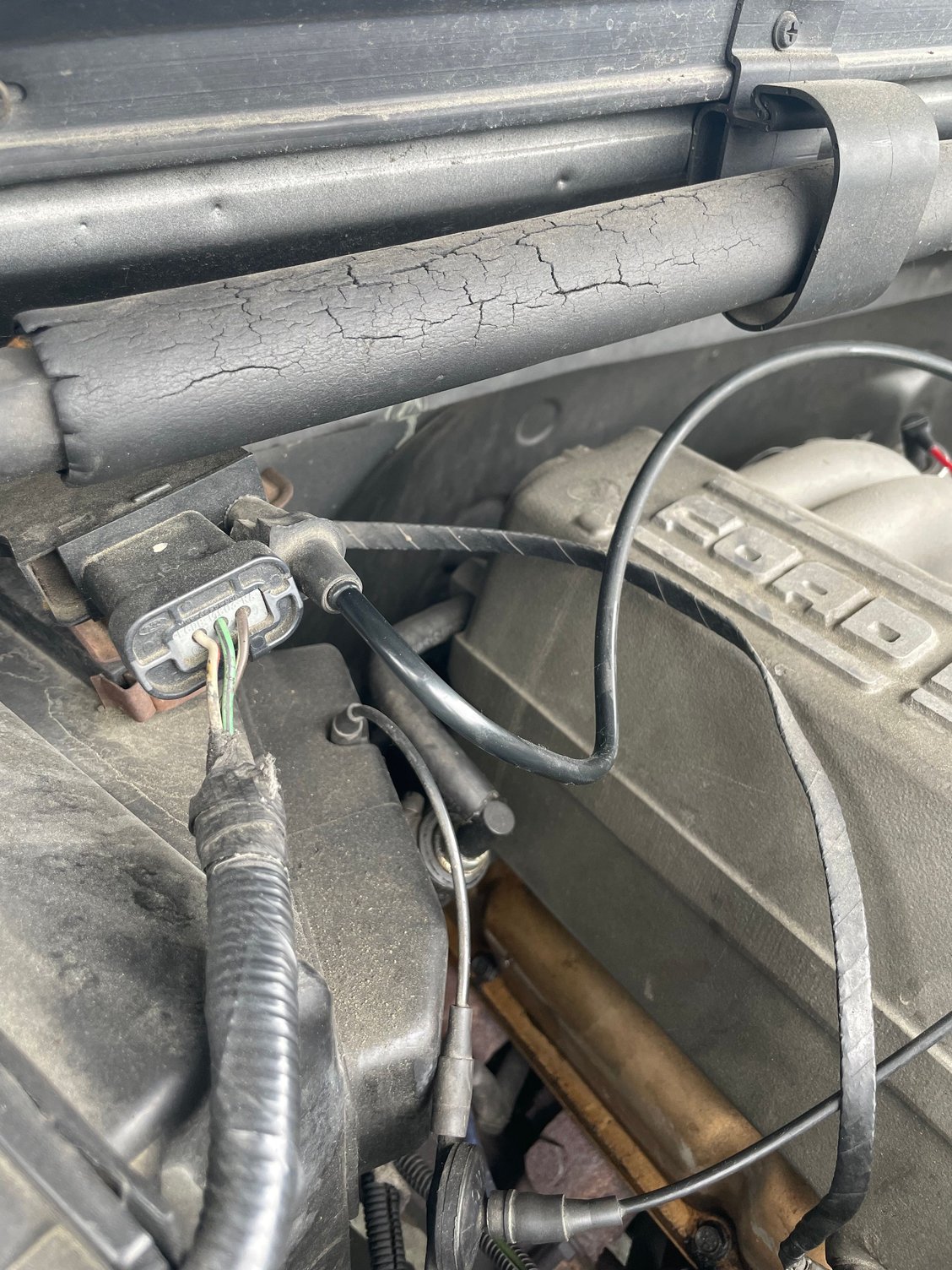

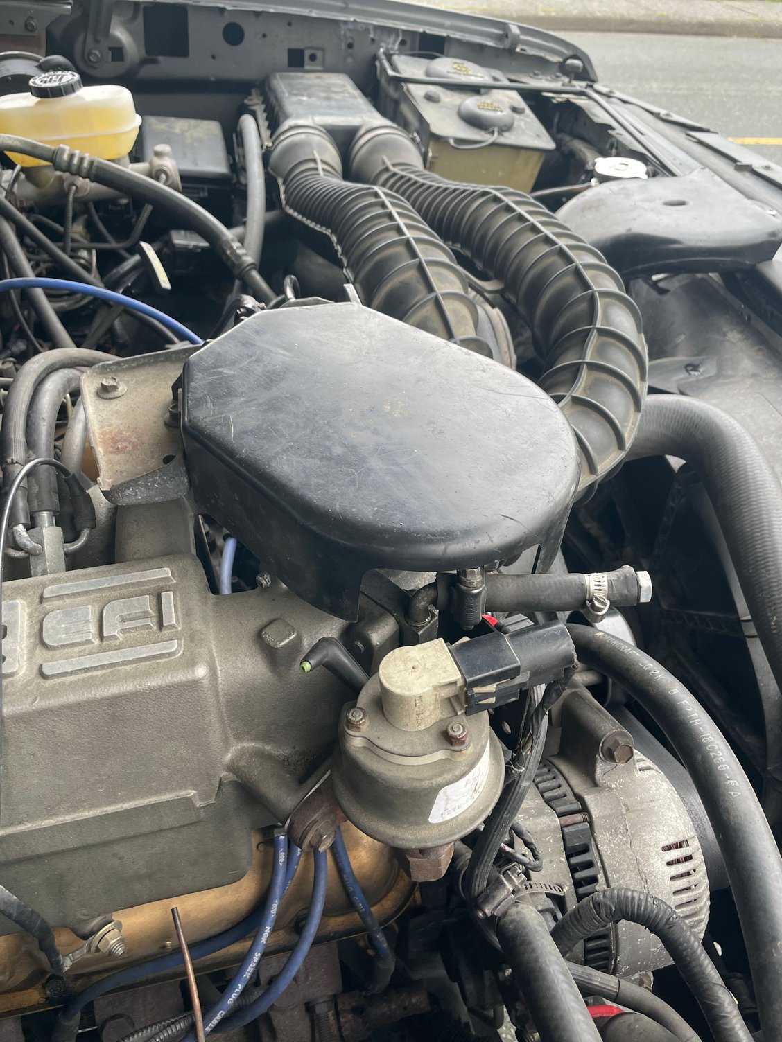

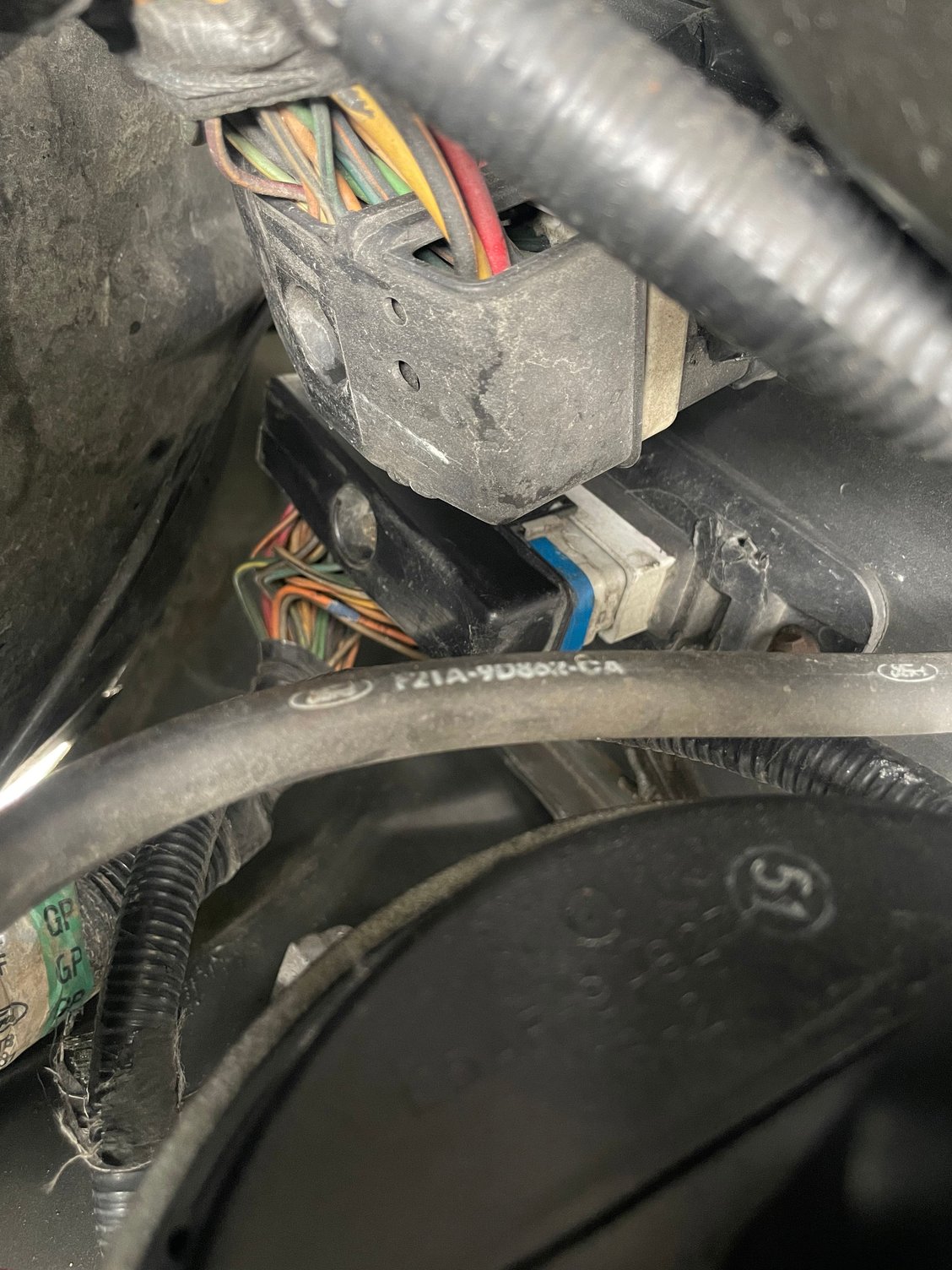

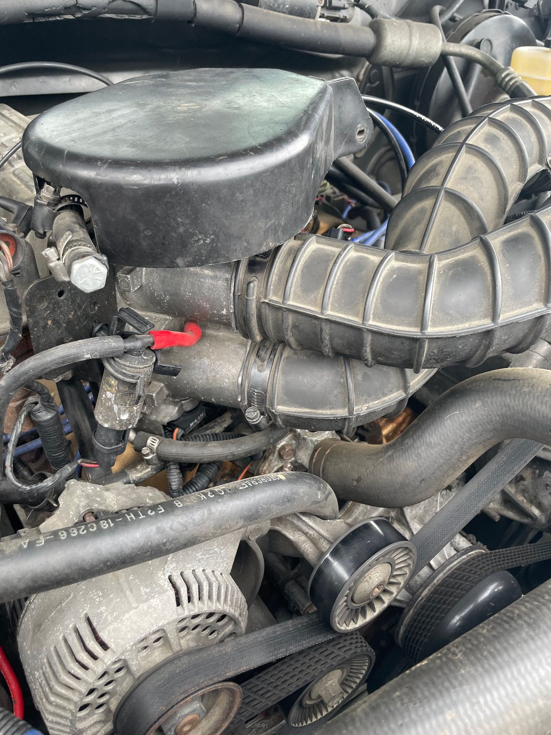

I see it has been MAF converted. Almost looks as if this 92 with 93 engine already had it. I’ve attached a pic of the MAF. also, the connector has a few #’s. Can you guide me which I should reference? Thank you!

Oh, I don't see a MAF Meter anywhere in any of those pictures. I do see a MAP Sensor, which is what I would expect to see on a Stock Speed Density EFI setup, which was stock on a 92 or 93.
The MAF will be in the intake tube between the Air Filter and Throttle Body, if it exists.

HA beat me to it SFaulken, They may still have done the MAF, but I am doubting it with the way the harness looks to be stock. One more photo of the intake from the filter box to the throttle body will tell that story.
