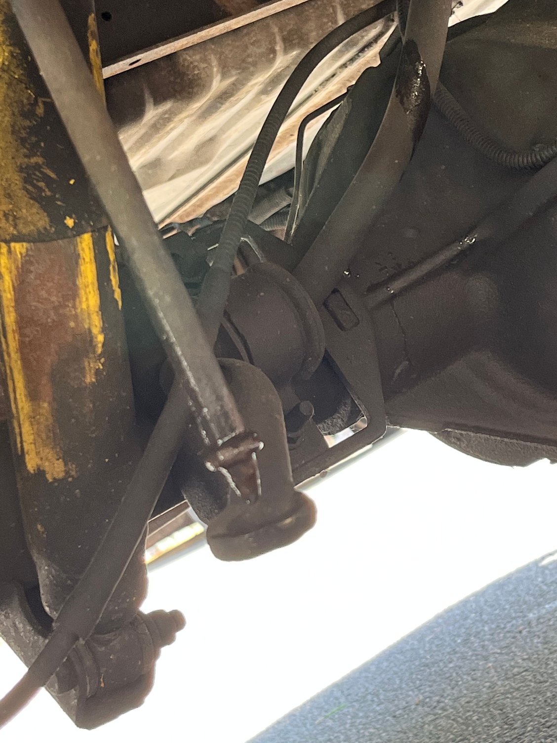

Whats this called?
Hey guys, I’m missing a bushing here (see photos) whats this bar called? Thanks
Rear end. Driver side bushing is intact.

Sway Bar Link bushing.

That end link is broken off... you're missing the section that bolts to the sway bar, so you need to replace the whole link bar.
Couldn’t figure out what I was looking at until I read what you said then I was thinking “Yep. The bottom of the link is gone.”
