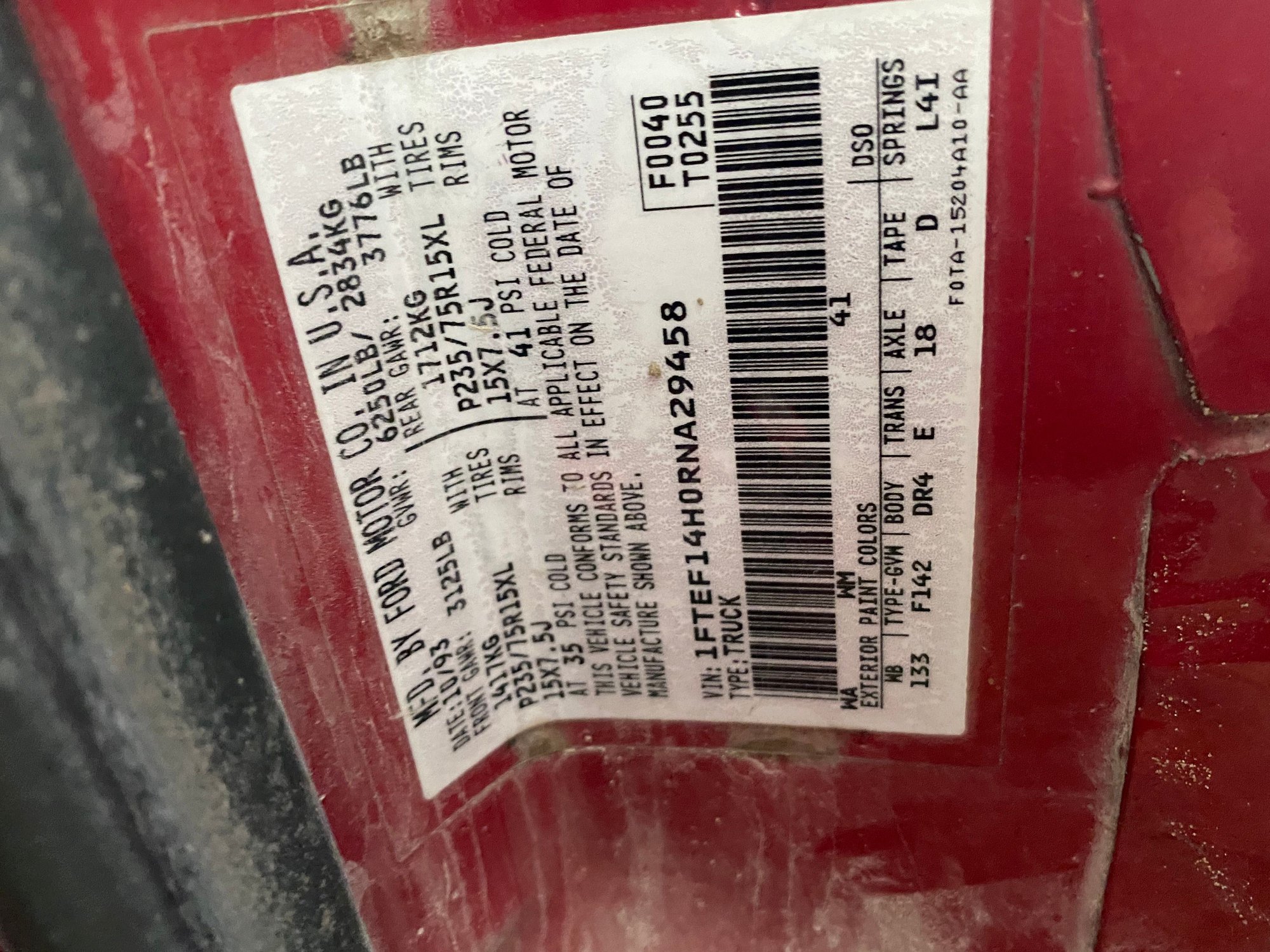

I’m new here and hoping I’m posting this in the right place. I’m needing help picking the correct ecu for my truck. It’s a 94 f150 5.8 e4od with push button 4wd, I don’t think it has MAF? I’ll try to add pictures but the number off my computer is f4tf-12a650-ta. Calibration code is 4-64h-r00. I’ve found several on eBay but the last letters are different. Any help is appreciated. Thank you

What is wrong with your computer?
Any EFI-SD48B hardware will work. LAW0 is the computer for that calibration code.
Other EFI-SD48B differences would be fueling for different altitudes, possibly torque differences depending on axle ratios.
If you want exact replacement, you must get a *-TA or LAW#.

Thanks for the reply! My computer has water damage. Bad capacitors and a couple burnt tracer wires which is more than I want to mess with.
