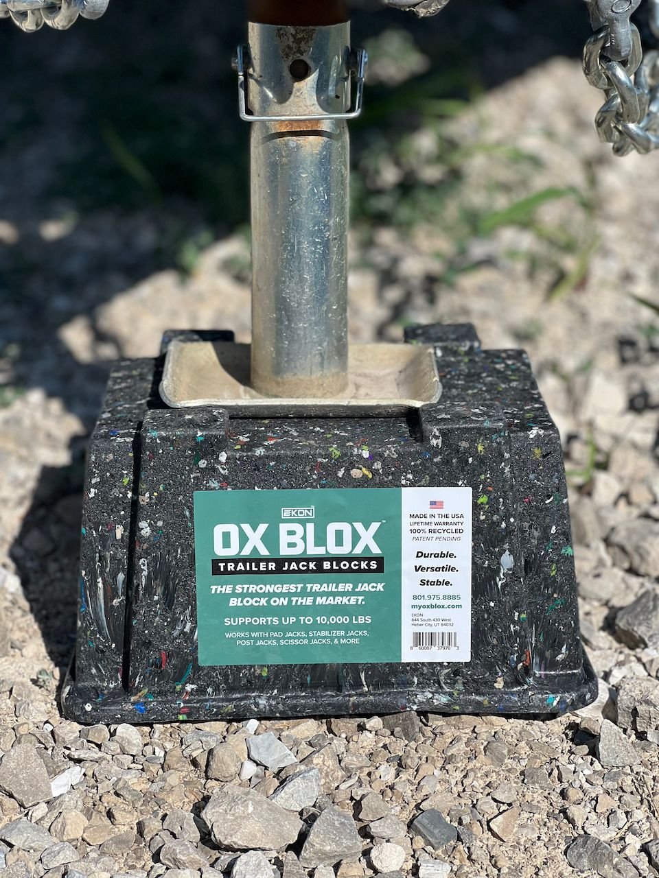

I saw another member post these somewhere here on the FTE forums, so I picked one up. Granted, it wasn't cheap... but it is heavy and feels quite sturdy. I like that it has the squares in the top that capture the tongue jack foot (even though I didn't center it perfectly). I literally just unboxed this today and swapped out the cut down 4x4 that I had been using for this... so much better! I doubt the likelihood is very great, but being that the 4x4 was the same size as the tongue jack foot, I always pictured it rolling out from under the tongue jack... Plus, this does have a wider base so it provides more support, and it is taller, which is nice too.
