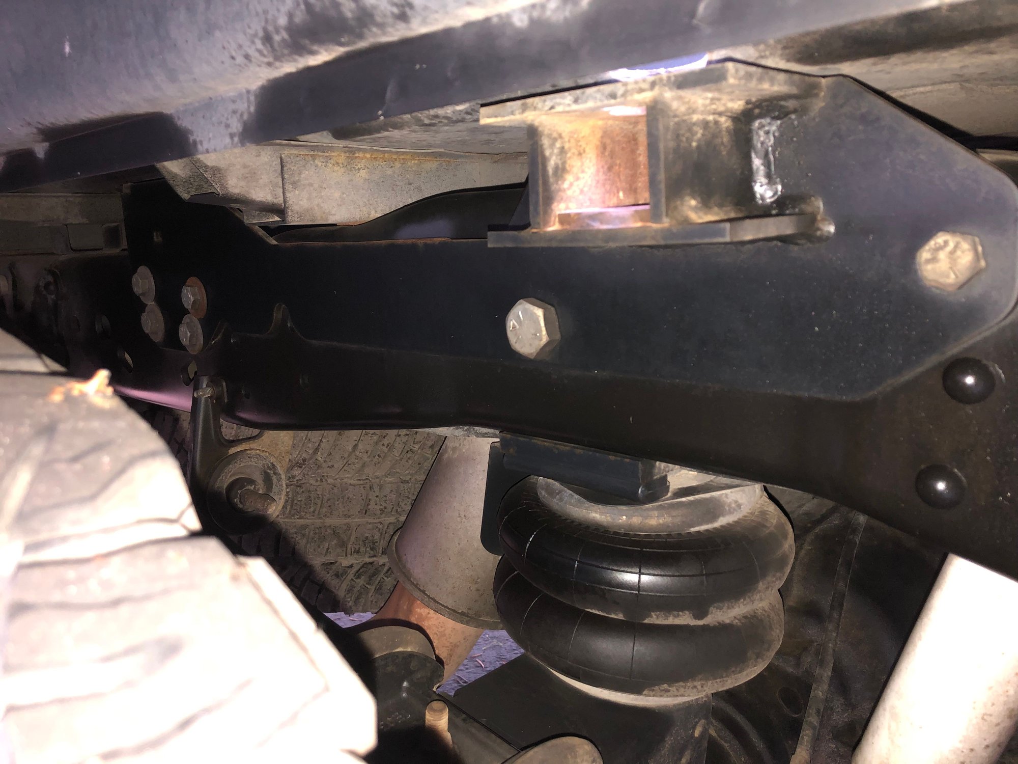

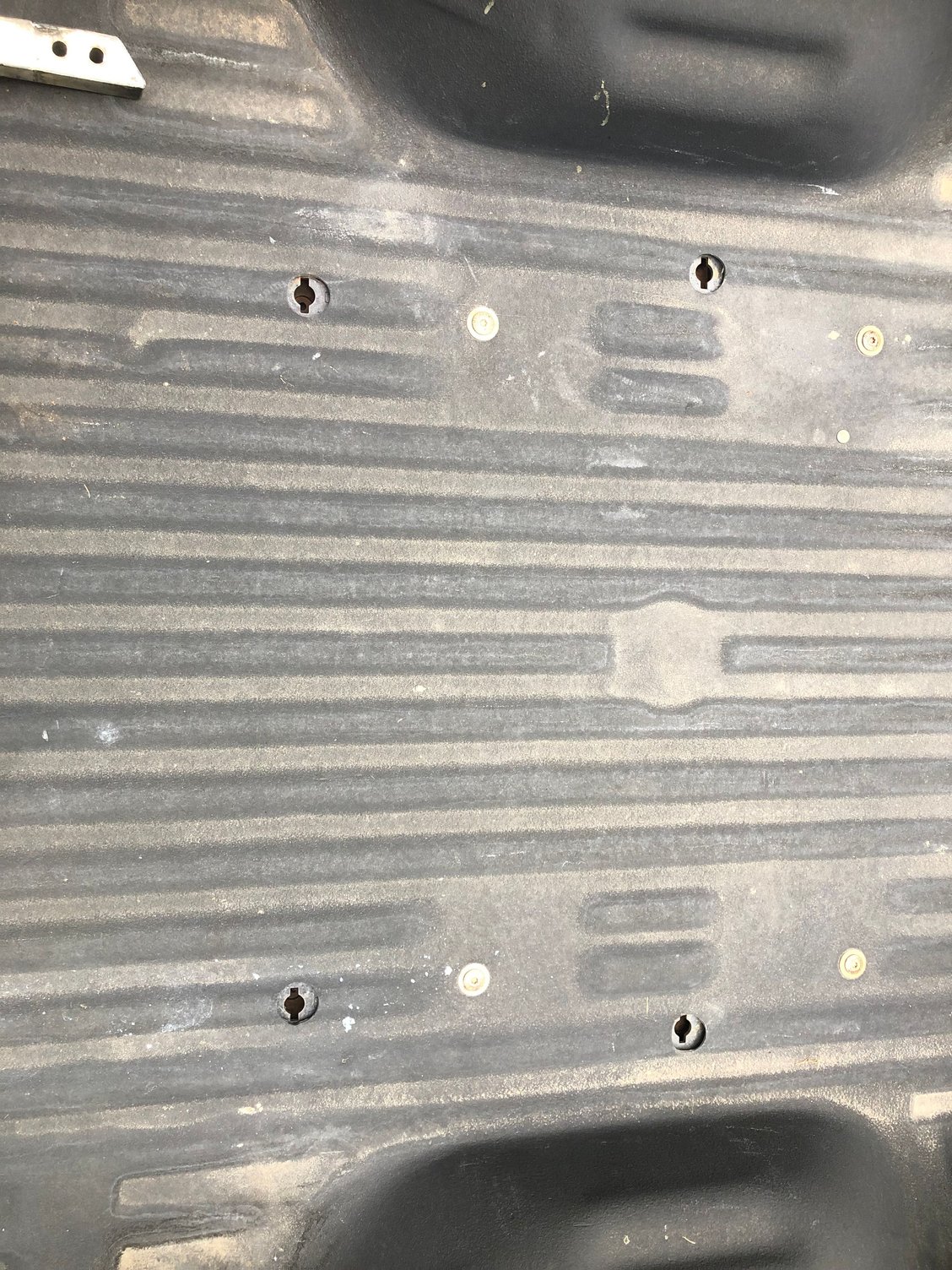

Hey all,
I just picked up this 2012 f-250 and I’m having a hard time identifying which fifth wheel system it’s got. The key holes look to small for the factory system. Any help identifying this so I can get a gooseneck adapter would be appreciated.
thanks

Not Ford. Check with Curt and see if it matches. BW I think would have the ball already.

Pullrite I used a pullrite hitch in my 97 short bed with a slider hitch.
