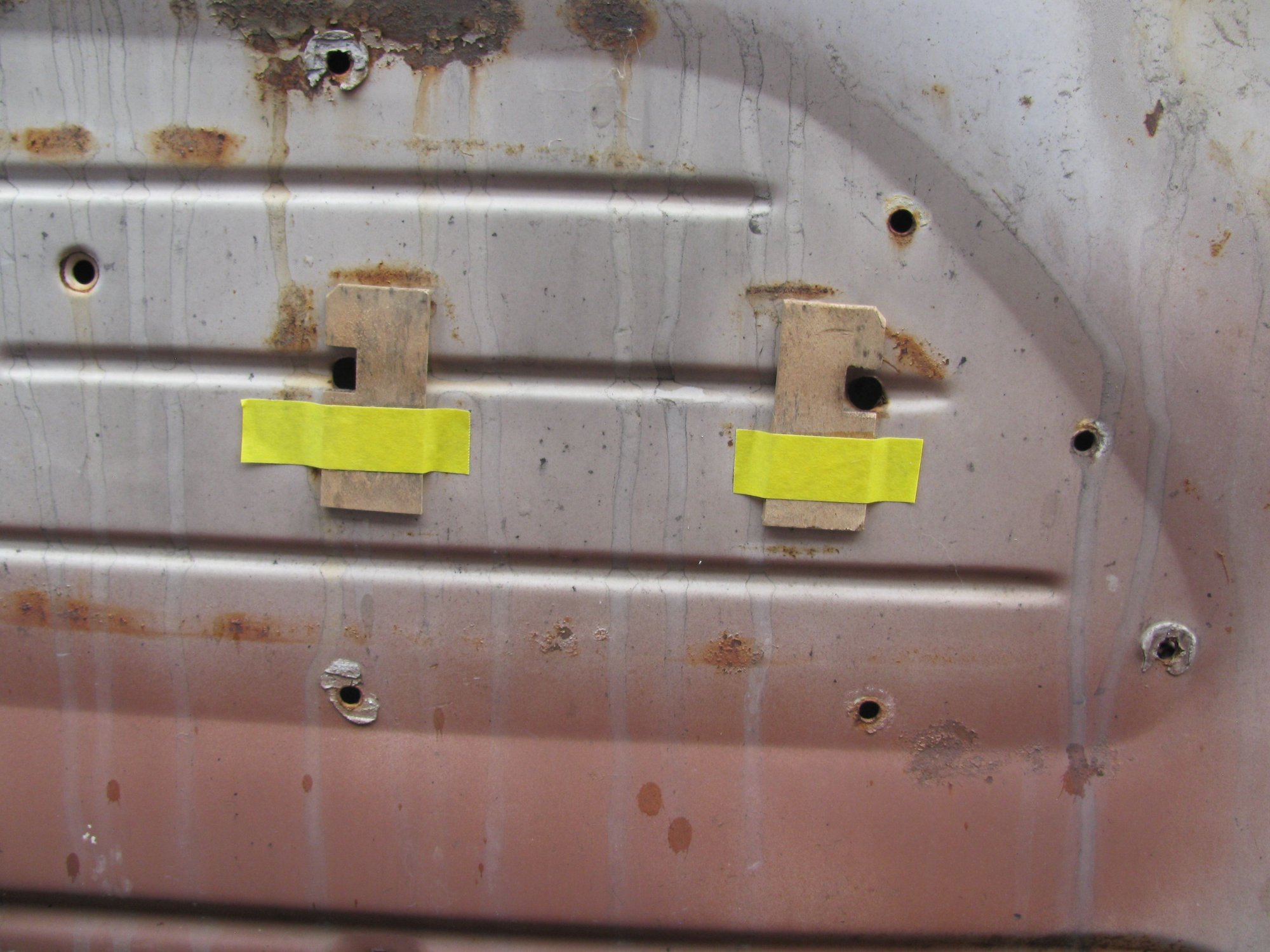

It has been awhile since I have posted anything, but here goes. I own a 65' F100 LB 2WD custom cab Pick up I purchased replacement door panels and armrests from CJ Pony ( they came in Dennis Carpenter packaging) They said that the retaining clips for armrests needed to be ordered separately, which I did. My issue is that it has been quite some time since I disassembled the doors. I see no place for the clips to fit into the door.. There are two screw holes that correspond to where the armrests will mount, but I see no evidence that there has ever been screws inserted into them.. So I am wondering do I have to reach up through the access panel and hold the clips on the inside? So I am appealing to you guys for some advice, as there is a wealth of knowledge represented on FTE.!

Yes, clips mount inside door skin and are held in place once armrest is fastened to it. Also, don't forget that there are wood shims that fill in the gap between the door panel and the door skin
Here's a picture from when I did mine

The clips that carpenter sells are not exactly like the originals. The original clips for the armrest were made from flat bar with machine threads. They were 12-24 thread which is hard to find but rethreading them to 1/4-28 is just a matter of running a tap thru them.
The wood spacers were taped to the door with masking tape at the factory.
