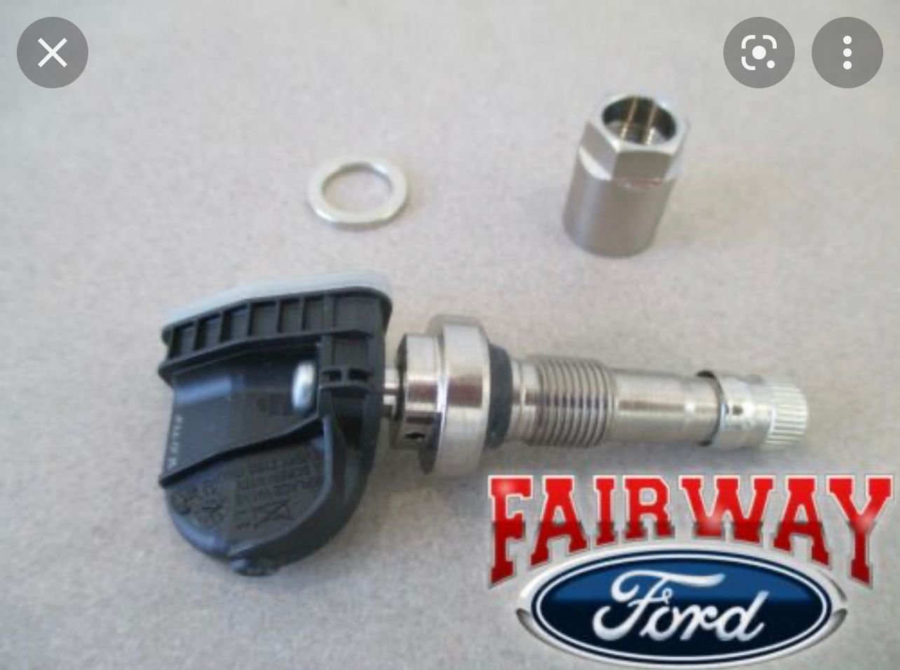

So the TPMS kit requires the sensors to be installed inside the tire? If so, I wasted $500+. I have a TST and thought these were screw on's and would save me a gadget in the cab. I'm not thrilled about the prospect of hauling the camper to a tire place.

Yes, they are internal. They replace your current valve stem. Tire shop charged me $75. They look like this.

I removed the tires and took them to the tire store. Easy peasy. I replaced my TST with these.
