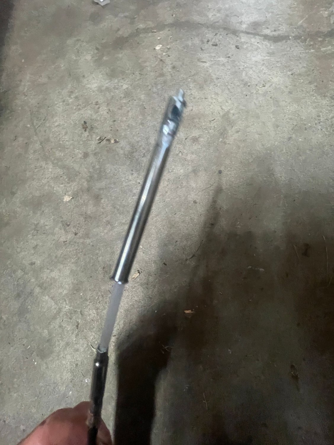

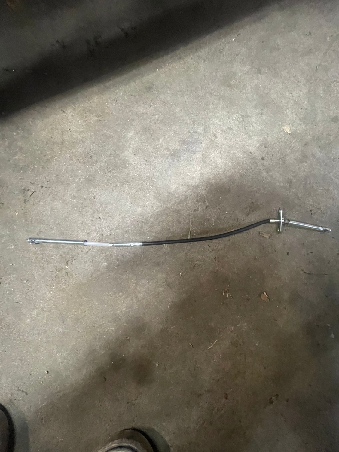

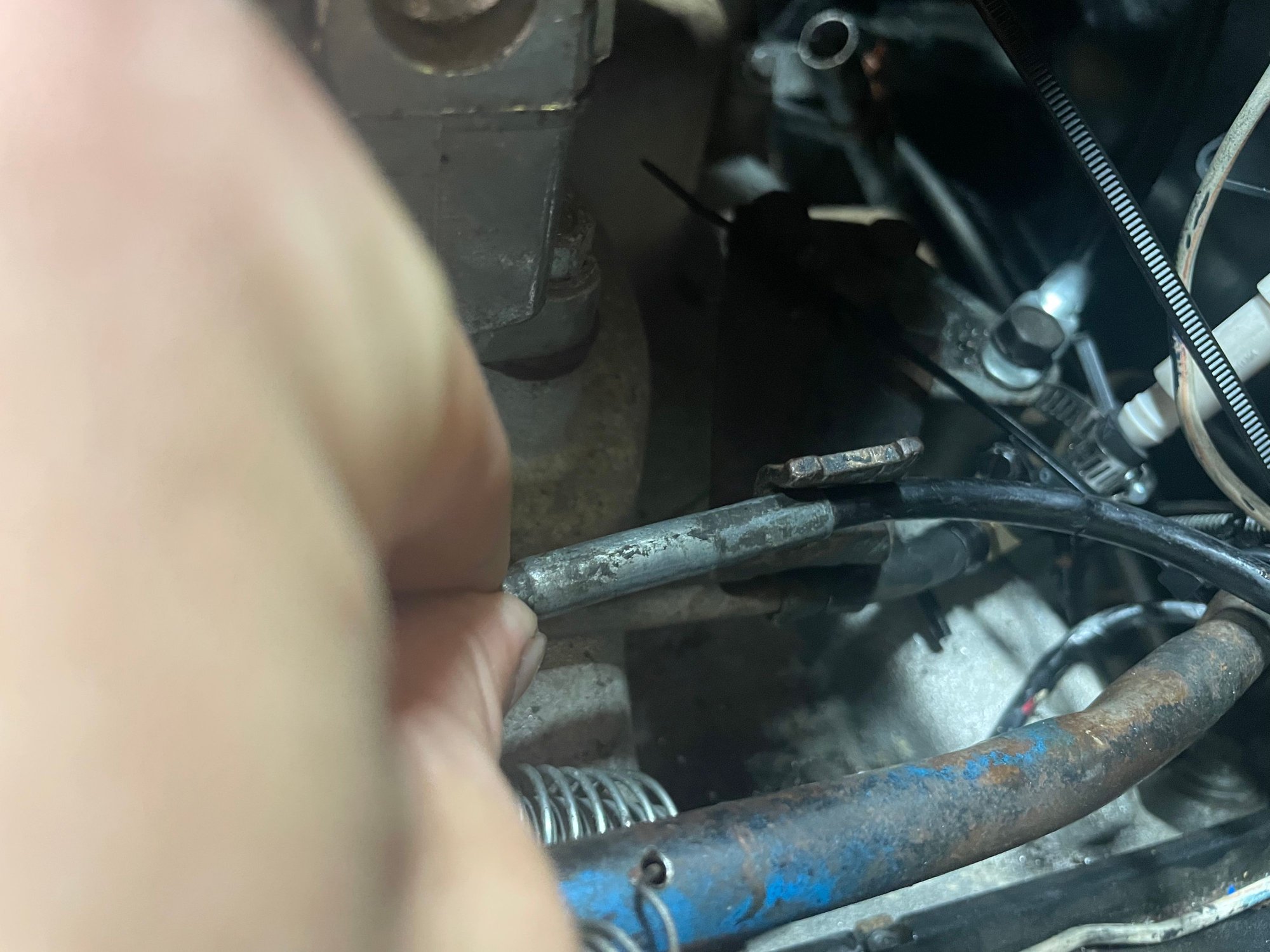

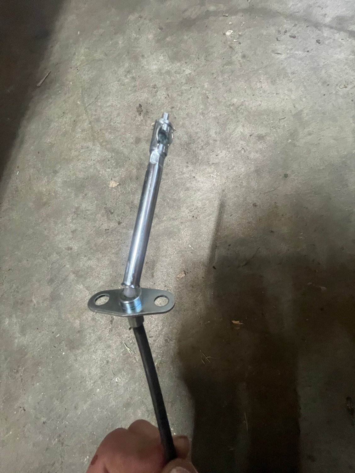

need some helping installing the accelerator cable. From what I remember, there is a clamp that holds the cable on the bracket that is on the intake manifold. Over time that clamp for the bracket is now lost. I can’t seem to find a clamp style accelerator cable bracket that my truck has. I can only find brackets that don’t seem to be able to work with my style throttle cable.
so basically I’m wondering what do I need to do to get this accelerator cable to work
and if anyone has info on install for the kickdown linkage that would be great to. I think I am missing stuff for that as well.
Kick down is a 1 piece rod and I have it connected to carb and to the trans.
truck is a 65 f100, 390, Mx-com trans, 4 bbl edelbrock carb(unsure what one exactly)

I would say that there is pretty much no way you are going to get the stock kickdown and throttle cable to work with a non-stock carburator and manifold.
You will likely need both the kickdown and throttle cables plus the bracket to attach them to the carb.
Automatic Transmission Kickdown and Throttle-Valve Cables | Summit Racing

The other half of the clamp for your accelerator cable is
C5TZ-9792-A - CLAMP - CARBURETOR - Clip (throttle cable to engine bracket)
NOS 1965 1966 FORD F100 F250 ECONOLINE BRONCO 240 300 CHOKE CABLE BRACKET CLIP | eBay
Same clamp used on 240/300 and 352 FE.
For the kickdown rod in a stock scenario there are a few related pieces. The carburetors on the Automatic equipped trucks were also set up to support the kickdown rod connecting to the accelerator
C5TZ-7A187-B - ROD - ENGINE MOUNTED ACCELERATOR SHAFT TO TRANSMISSION THROTTLE CONTROL OUTER LEVER - 1/2" diam. rod
C5AZ-7B146-F - SPRING - TRANSMISSION KICKDOWN CONTROL LEVER RETRACTING - 2" free length - 14 1/2 coils
C4SZ-7C484-A - BUSHING - TRANSMISSION KICK DOWN BRACKET TO TRANSMISSION ROD - 7/16" O.D. - 1/4" I.D. - 5/32" wide
353862-S8 (XX10) - Washer "C"
They also included the anti-stall dashpot and related items that help keep the engine from stalling when you let your foot off the accelerator.
C1AZ-9B549-A (CD-6) - DASHPOT ASSY.
B8AZ-9B550-B (CM-908) - BRACKET - DASHPOT MOUNTING
Plus some other hardware bits and pieces.
I hope that helps some.

With a 4bbl carb, the stock bracket on the manifold will not be long enough, because of the wider carb. You can modify the bracket, or go aftermarket. Crop Duster’s link is the right idea. You want a setup that bolts to the carb base. A site search will help. This issue has come up before.

I have also lost the small piece before. It might be difficult to duplicate the "hook" on the top, but you can make one from a piece of scrap with a couple bends in it. You want to be able to clamp the cable without crushing it. I did it and it works with a 4V carb, (it's on an angle) but I don't have the auto kickdown.
Some guys have adapted the later (earlier?) rod and bellcrank linkage which is probably more reliable; if you break the '66 cable linkage you'll find there's no easy roadside fix.

I just found a large washer. Put it in a vice,pounded a slight curve in it with a ball peen hammer.. bolted it over the cable.. 7 years later still working.

Thank you for the accelerator clip information, I made one with a hammer and dremel. mzurko
