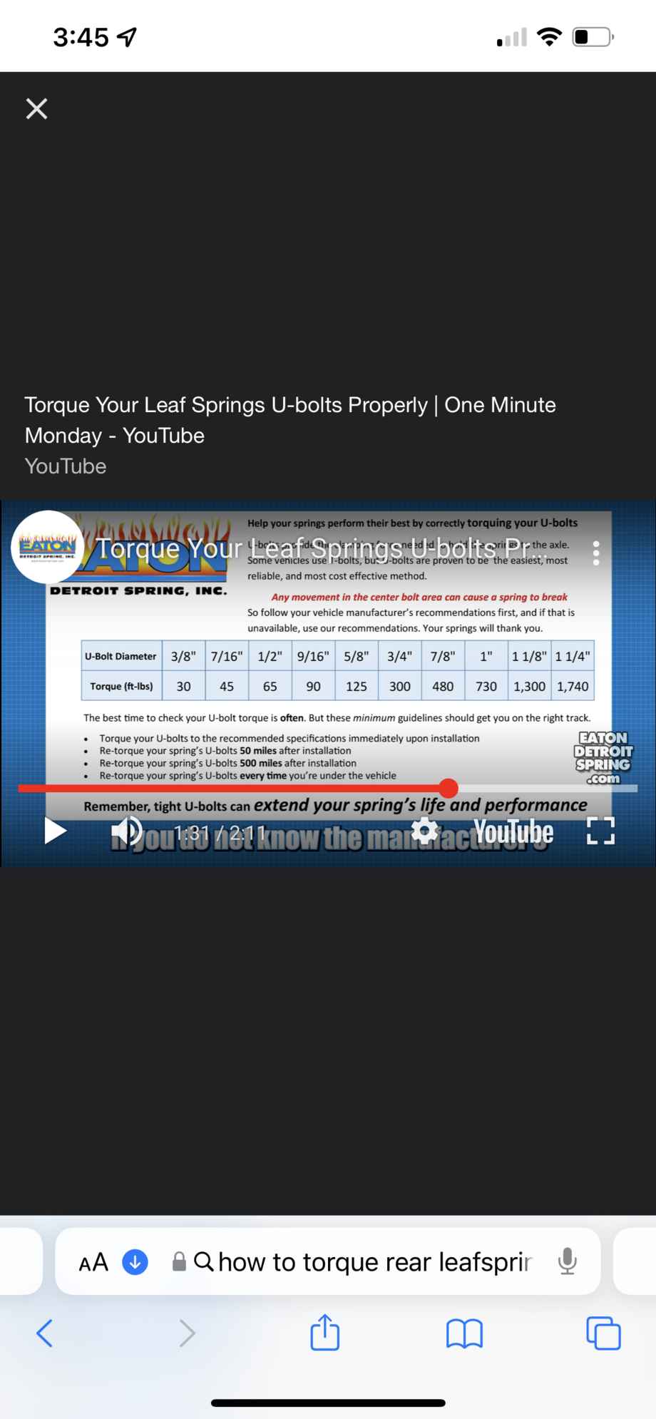

that would make sense as the squeaking started after I had the new suspension and lift put in. I keep taking it back to see if they could help me fix it but they kept brushing me off. The Ubolts should all be new so I’ll just torque them down again. I found the specks online.
thanks!

super optimistic about this. I’ll give it a shot and see what I can do. I had suspension done at a shop so I don’t have access to specs. I found a video with some specs.
