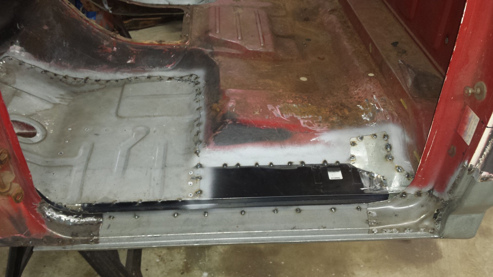

Plug Welds (suggestions)
Plug welds.5/16
18 gauge
Increase Amperage? Hands that tremor are a pita.
From top to bottom
~55A,17.2+4V
~56A,18.2+4V
~54A,16.8+2V

Mig with gas welding or flux core?
The welds look fine to me. In the top and second row it looks like you need to hold the trigger a bit longer, not enough filler rod. You are getting full penetration. The bottom row looks nice to me. A bit of grinding and done.
I normally follow the amps based on the chart on my welder, for plugs go one step hotter. Then play more with wire speed.
Looks to be gas as I dont see a lot of splatter.
I also like the bottom row right the best.
I also go by the welders chart on the door and adjust from there as needed.

Pretty messy -- are you using a two-hand approach and what equipment are you using?
