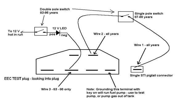

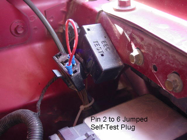

Easy Button
Attachment 277274
courtesy of Subford
Data Link Diagram
Attachment 277275
courtesy of Subford

Thanks for the picture and diagram, electrical not my best and i didn't know where the port was.

If that does not work try jumpering Pin 6 to ground instead of going to Pin 2. Pin 2 is Signal Return which is another path to ground, but sometimes that path is broken.
Attachment 277275
