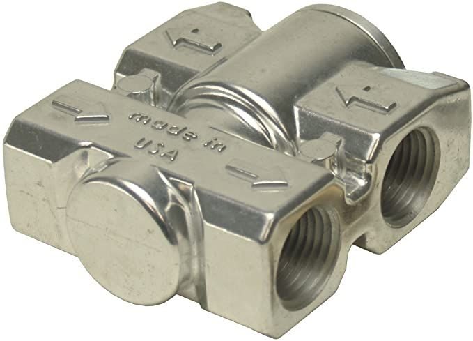

@Grape Nehi , Mark Kovalsky is the transmission expert in here and it is based on remarks of his like the one above that I installed a transmission Fluid Control Thermostat.
https://smile.amazon.com/dp/B004XOQ0...GHKPYDBXFGR0YE
