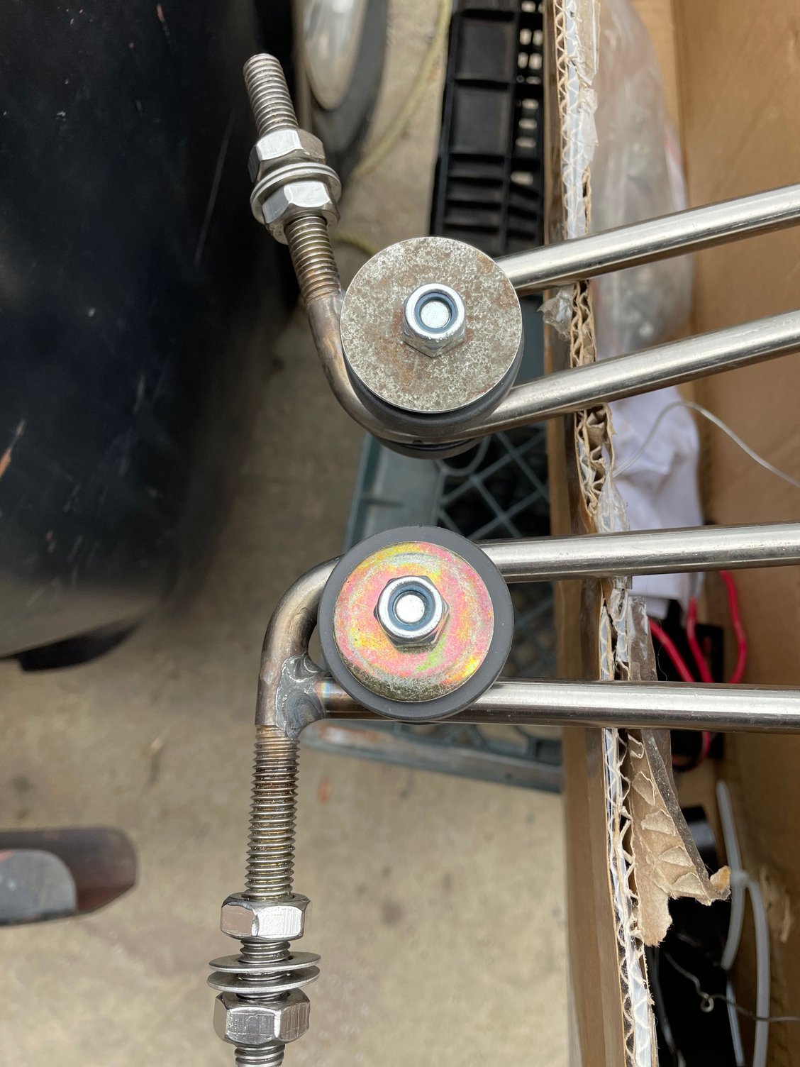

One of the rollers doesn’t seat all the way to the back like on the opposite side. Before I start tearing stuff up. I was gong to assemble it and see how it works. What do you all think?

The upper roller has a parallel top and bottom, the lower roller sides are at an angle to each other.

Before I installed mine, I had the same issue. But when the hood is closed the roller doesn't go all the way back. So it's not a problem.

Thanks for all the information. Like I said I was over thinking it. Paralysis by over analysis.

Good catch! No reason to fabricate brackets with that much variance. The upper rail is meant to contact the roller so that the hood does not bounce up...I might be a bit OCD but if it were me I would be sure that both brackets matched.
