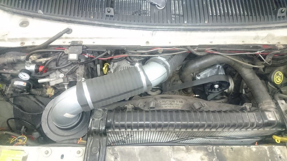

Originally Posted by PriusLover
Off topic but @FinnishStroker what's the purpose of that tube that comes out on your driver's side valve cover?
If you mean that 4" marine exhaust tube,it's part of my custom "6637" intake.
https://www.ford-trucks.com/forums/1...-on-a-van.html
