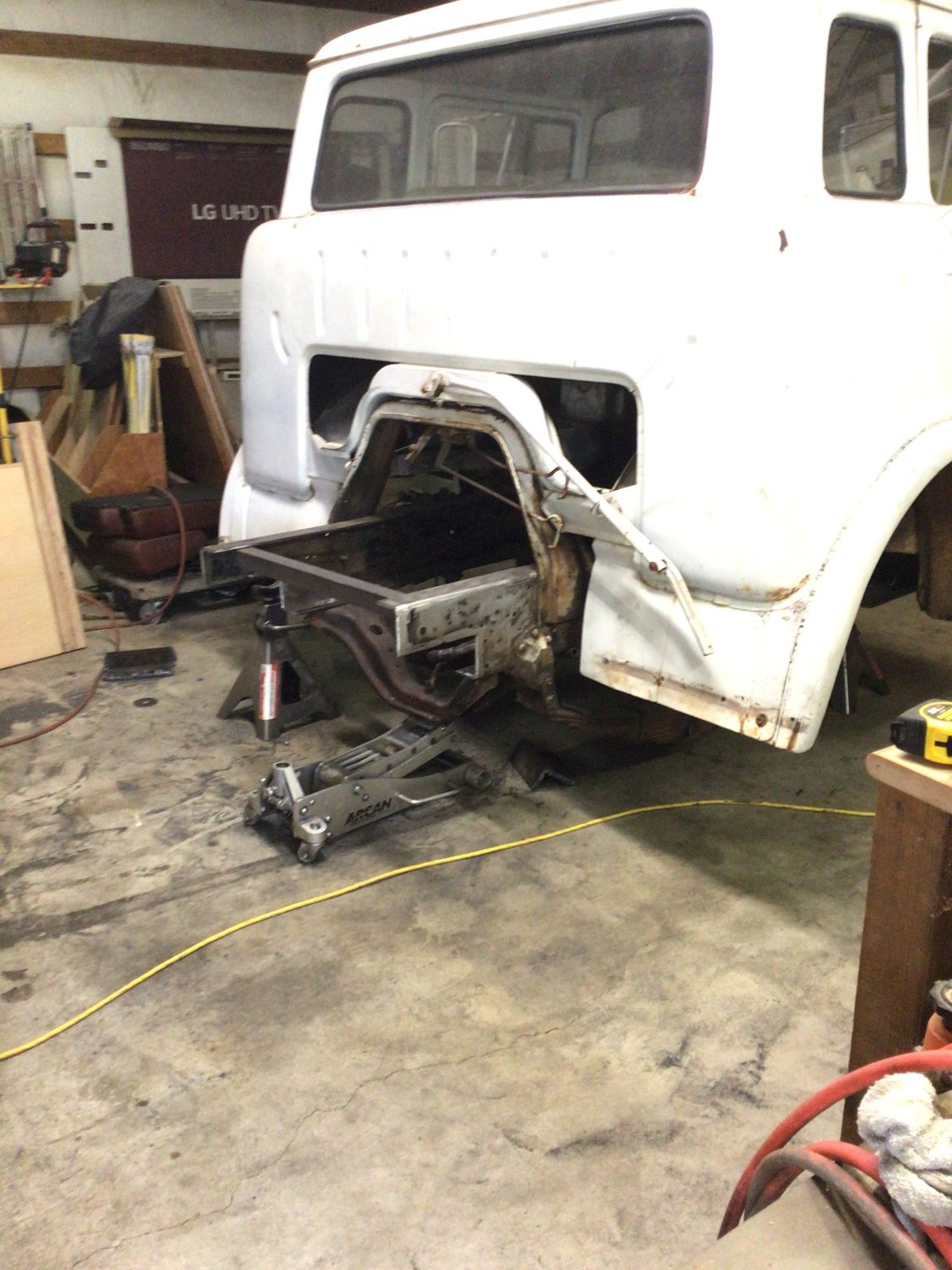

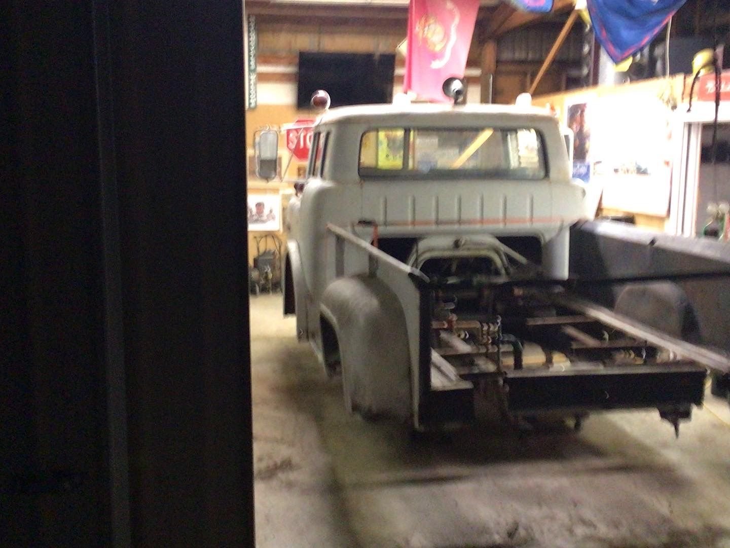

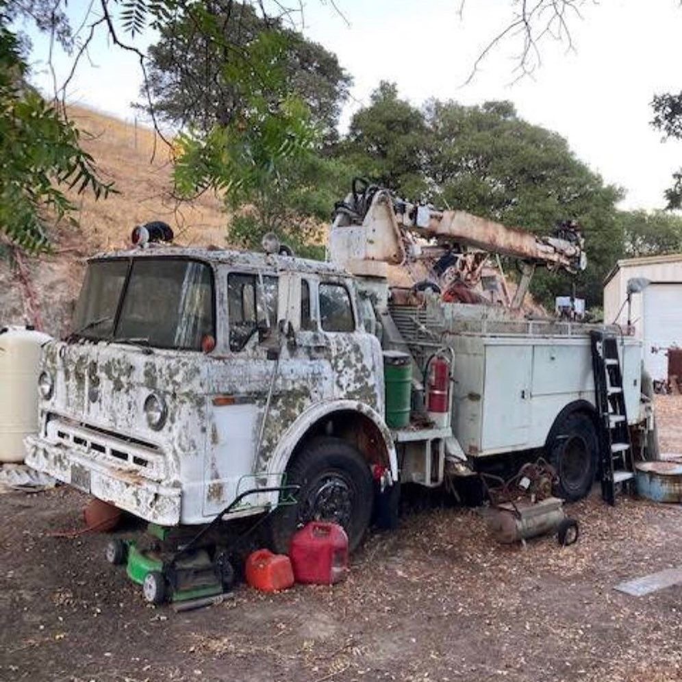

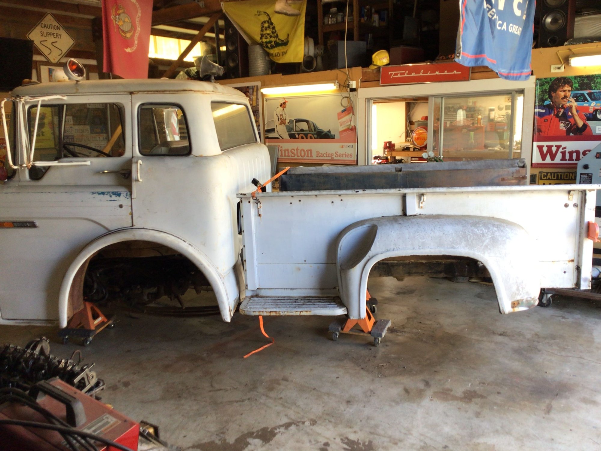

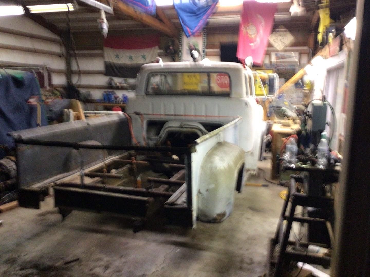

So I’m using the 86 f250 4x as a donor for my 75 c650 pickup project. It’s going to be a 2wd truck it’s got a triangulated 4 link rear on bags, 70s dodge 1 ton 2wd front axel with a 3 link. I’m not going to worry about the driveshaft I can make one in my lathe. I want to do it because I’m on a budget and the donor only has 60k and works well and I prefer the devil I know over the one I don’t. This is a “custom” truck and just trying to save a few bucks by scrounging for parts.
Bobbed frame
Mock up
Widened bed 1 foot
What I started with
Pinterest pic inspiration
