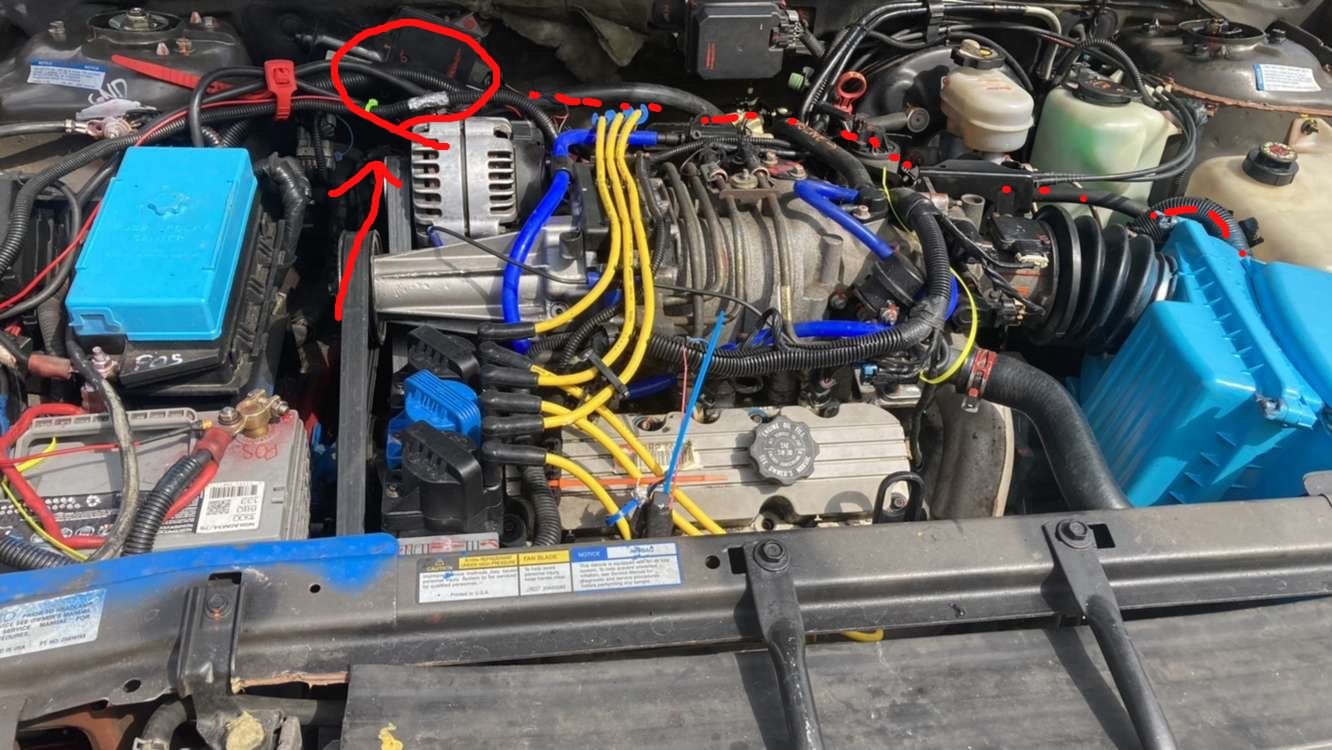

[QUOTE=M1A4ME;20413568
When we did my youngest son's 91 RS Camaro I had him paint the bottom of the car and the rear axle gloss black and then we bent the brake lines, made sure they'd fit and painted them gloss red before installation. Different colors make even small parts stand out some.[/QUOTE]
I have a little more conduit in use now(redid some runs) and I have some places elsewhere in the engine Ive done
This isnt a ford product but its my car, same concept applies.
I more or less allowed myself to express more creatively and since things up here tend to die from rust, there is no sense in leaving a turd unpolished (go down with a fight kinda thing?)
But adding color when I do stuff has been nice.
Felt like a moron when I did a trans mount on my car with john deere yellow and then stupid me painted the side that hugs the car, not the one you Seee!! lol... Should have just done both lol
