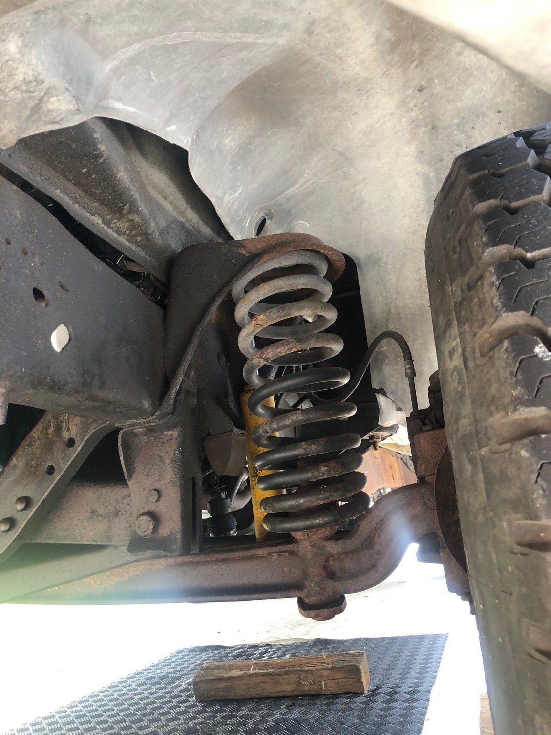

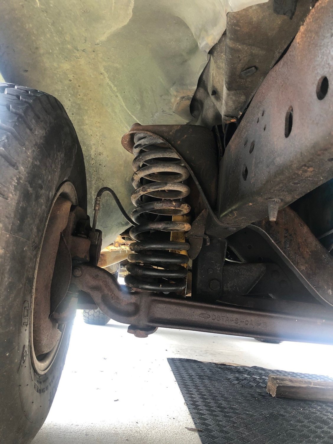

I haven't noticed any bearing issues really, but there is something odd now that you mention it. When we originally got this truck long ago it had the smaller (maybe 14's) skinny bullet hole rims on it. Then we slapped these suckers on it. Since we recently bought the truck back me and a mechanic friend were looking under the truck because it really "slams" hard on the right side on bumps and noticed the right spring is rubbing on the frame bumper and looks to not be correctly in it's lower perch. Can that have anything to do with the larger wheels/tires? Pictures below of both sides.
Aside from that could it being a Ranger "Explorer" have anything to do with maybe a slightly higher ride height?

Well, the right side coil bottom does look to be off center of the spring seat, and looks close to the bump stop mount bracket. Spring coils would be hitting the mount. That left side I-beam looks to have a curve in it ... more than the right side anyway ... so maybe it was bent in an alignment to kill some excessive camber I would expect to see if lifted. I think I do see Ford script in oval and item number on one I-beam, they made those I-beams to be tweaked for camber adjustments. They used chains on a rack and a big jack. I forget if heat is used.
I'd look at king pin wear too.
It may be that someone lifted the front with stronger or 4wd coils and didn't get the spring seated or didn't have a lower retainer and the spring jump out of it's seat, the right side takes a beating living on the right edge of a roadway with it's chug holes and broken pavement.
I don't have a 2wd to compare to, it just looked high in the overall picture.

OEM 2wd coils on a 73 (upside down).

Looks like either forango's springs lost the pigtail ... or they were cut off ... or they never had them because they are from another vehicle (I think likeliest they were swapped in as the truck doesn't look to be sagging)? Maybe they are 4wd springs?
I am definitely gonna look closer to see if they have the pigtails when I can(having back problems today). But i wouldn't be surprised if they are swapped. The guy I originally bought the truck from had a good amount of trucks and was a F-series "expert".
I wish I had a picture from when I first bought the truck on the smaller wheels. I have noticed in looking at pics for rim ideas that our truck does not seem to have as much "rake" or is more "leveled"
