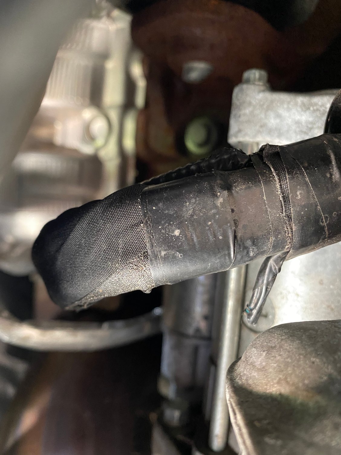

2017 f350 shows low oil pressure light and check engine light. Had auto zone run the code P0198. Looked and found the sensors, but there are NO wires to the sensors. They have been cut! Anyone know why that might have been done? I have attached a pic of sensors.

Unfortunately I think Smokepole was right and a rodent has eaten the through it. Found a cut/eaten wire on the back side (see attached photo). Now trying to figure out if it’s just one harness to both sensors.

I had the same thing done by squirrels.
Ford parts sells a replacement pigtail.
Ive hung a plastic bottle with holes in the bottle with moth ***** in the bottle and have not had a problem since.
