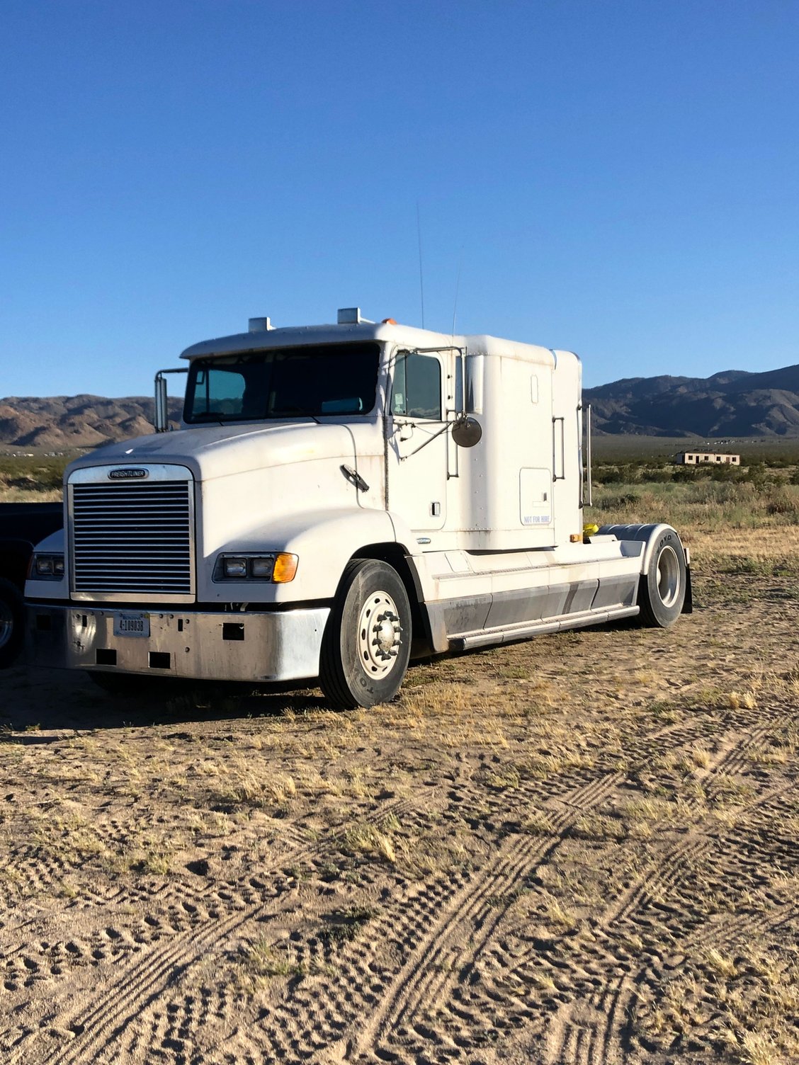

if you want a the best tow rig available while staying legal with a class C license get a f350 crew cab long bed dually to tow your 37’ sail, Errrr trailer.
Or do what myself and many others with 40-ish footers do and get a properly sized tow rig. i picked this one up for less than a 7.3 excursion cost. Just sayin
