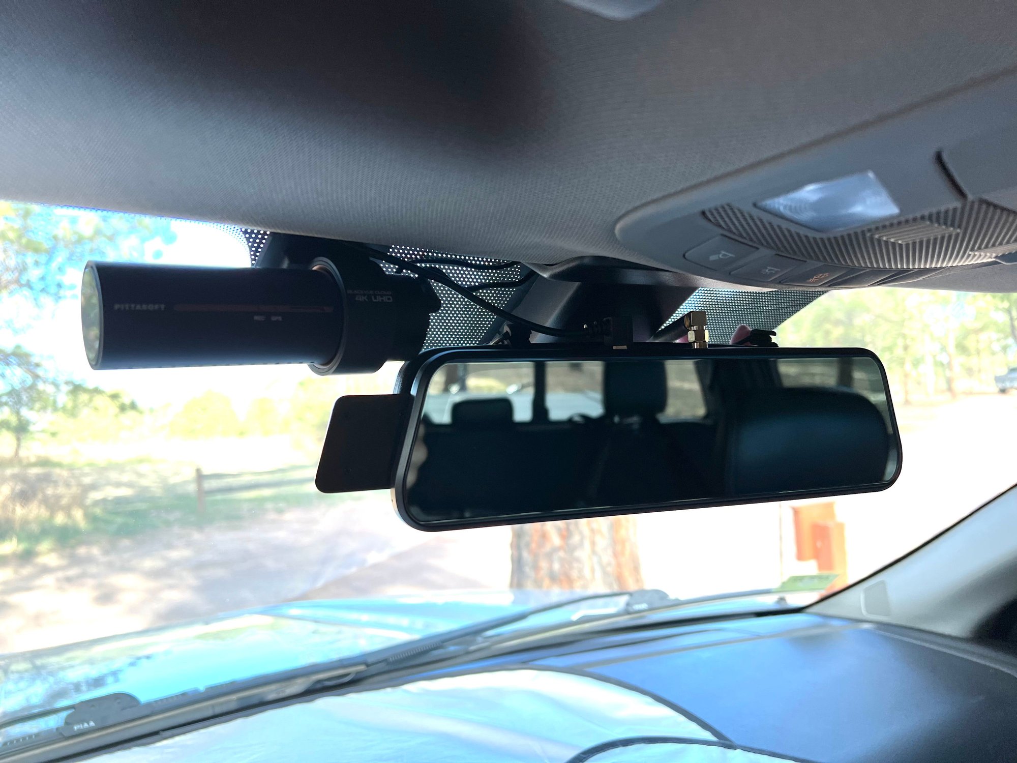

Here you go. Pic descriptions -
1. Rear view that you use when driving down the road. You can see the bed rails, so you know exactly where your rear end is in relation to vehicles in your blind spots.
2. Split front/rear, not sure why but apparently people use it.
3. Front only. Not really useful for me.
4. Underside to show the attachment clips.
5. Front camera. The front camera somewhat blocks you from mounting the camera mirror exactly centered on the OEM mirror. It's not something you'll notice because you can't even see the OEM mirror, but figured I'd mention it.
6. Wires get pushed up into the headliner and routed to where they go.
7. Rear camera placement. Some people mount this inside the cab but I wanted a 100% unobstructed view of the rear without the chance of getting window glare, tint making the image too dark, etc. I used some super short screws and some sealant to ensure it was water tight since it's mounted to the LED stop light fixture.
The camera mirror supports 4k front / 1k rear, or 2k front / 2k rear. I currently have it in 2k / 2k since I value the rear image more than the front. I've read that it doesn't make that big of a difference anyhow so it's probably negligible.
The camera also has a feature to sense movement/shocks/vibrations while the vehicle is parked. So if someone runs into your truck, the camera powers on and starts recording. It actually works pretty well but you're not going to get the leading up video, only video from after the crash occurred.
There are other common features, like push button to save/lock videos (to guarantee they don't get overwritten), but I think these are the most common I considered when looking for a DVR/cam.
