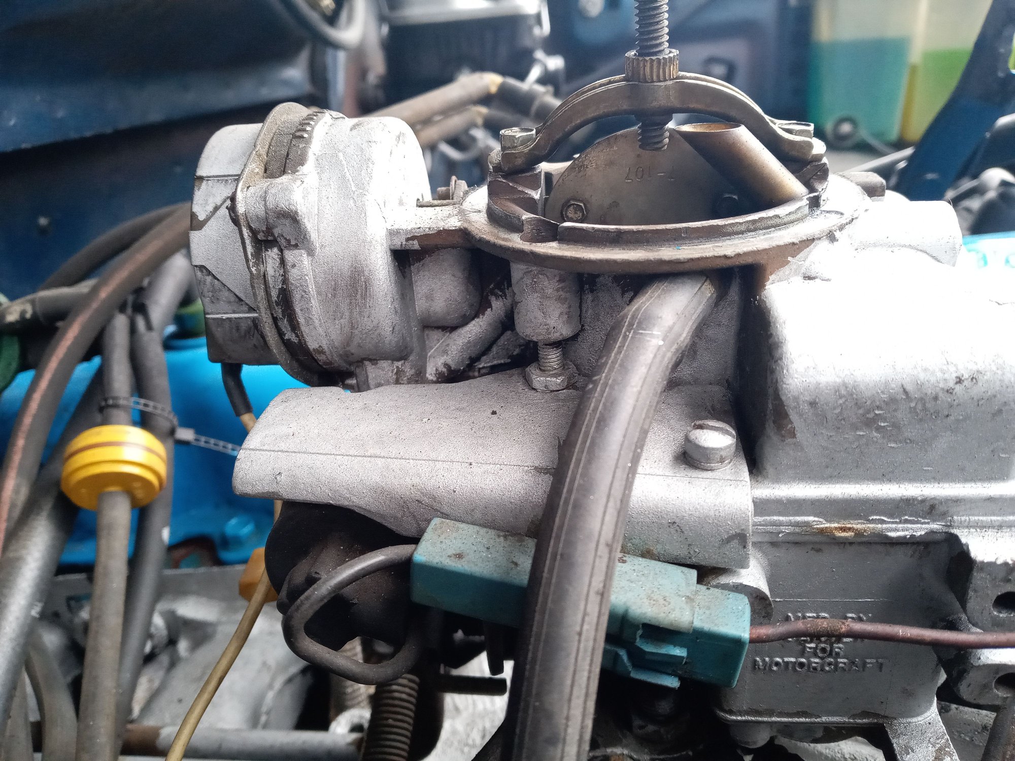

Just note besides the hot air tube coming from the exh manifold to the choke there is another tube.
It goes from the top of the carb by the air filter flange (nipple) to the bottom of the exh manifold.
The tube is the fresh (filtered) air tube for the choke.
I have some picture of the tubes and hook up to my carb on my site if you need to see them.

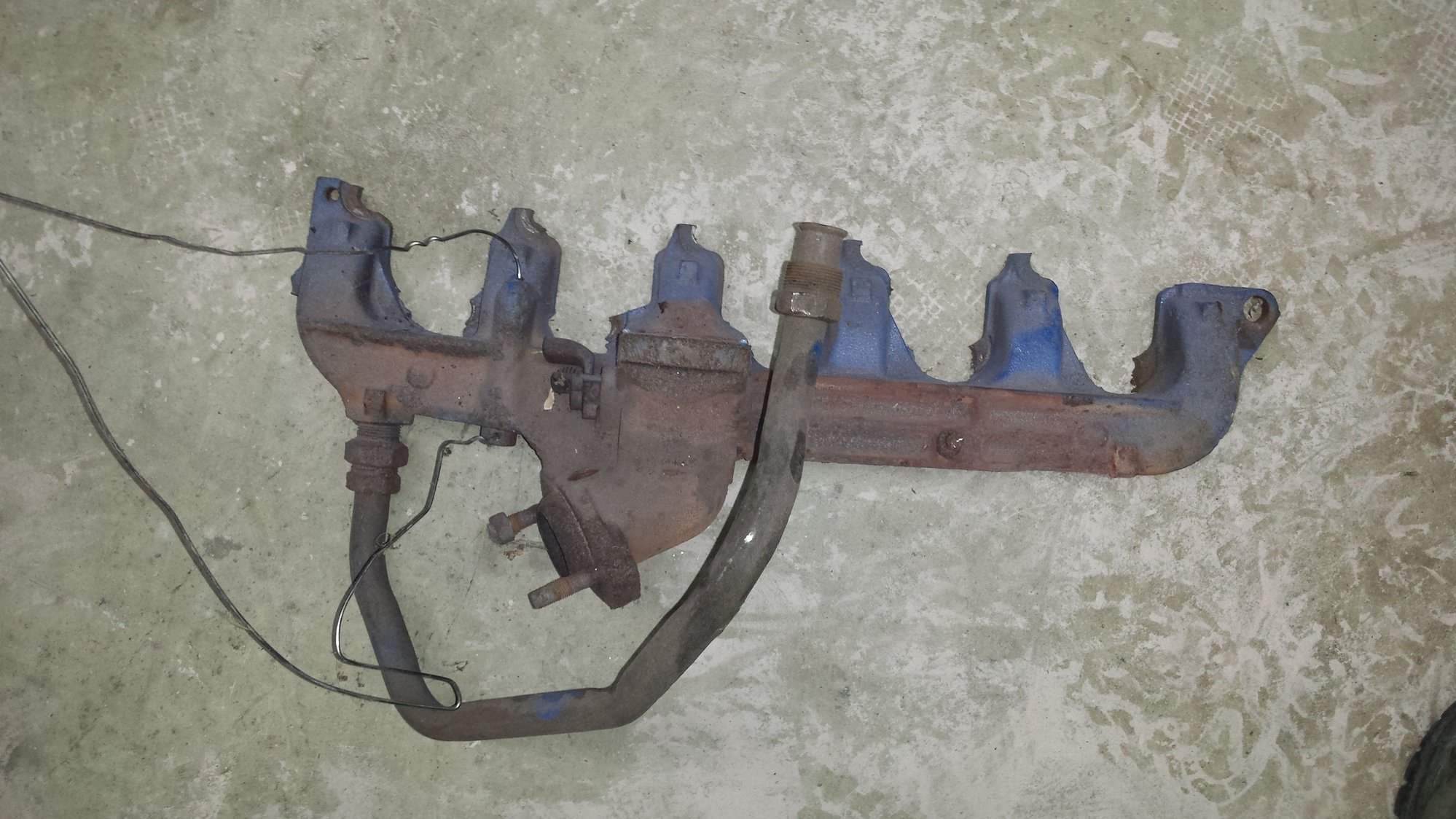

Here is the exh manifold showing where the metal tubes would be top & bottom.
Here is where the clean cool fresh air comes from for the hot air choke. This tube goes down to the bottom of the manifold.
It picks up heat and comes out the top and goes up to the choke. Here you can see it is on the same side as your old carb, has the white covering on it.
My choke also uses electric from the ALT "S" stud and between the hot air and electric it works pretty good.

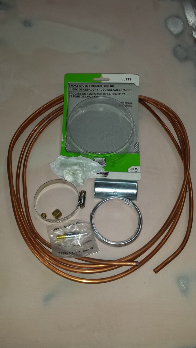

FYI Dorman make a repair kit if you are missing the metal tubes and no way to hook them to the exh manifold.
You dont get the copper tubing in the kit. The metal half cup gets put on the exh manifold and the metal line goes in 1 end and the other up to the carb.
I dont know how well it works as I have never used the kit.
Now I do have to say my set up is a little different because I am running EFI exh manifolds and they dont have a "pass thru" for the hot air part.
As you see I used copper tubing and put a few wraps around 1 of the manifolds to pick up the heat. Everything else runs just like the factory had it.
Now once I got the truck on the road and the weather got cold I found the choke would not open. It did not get enough heat from the wrapped tubing.
I had to get header warp and cover the copper tubing where it wrapped around the manifold and it now works as it should.
