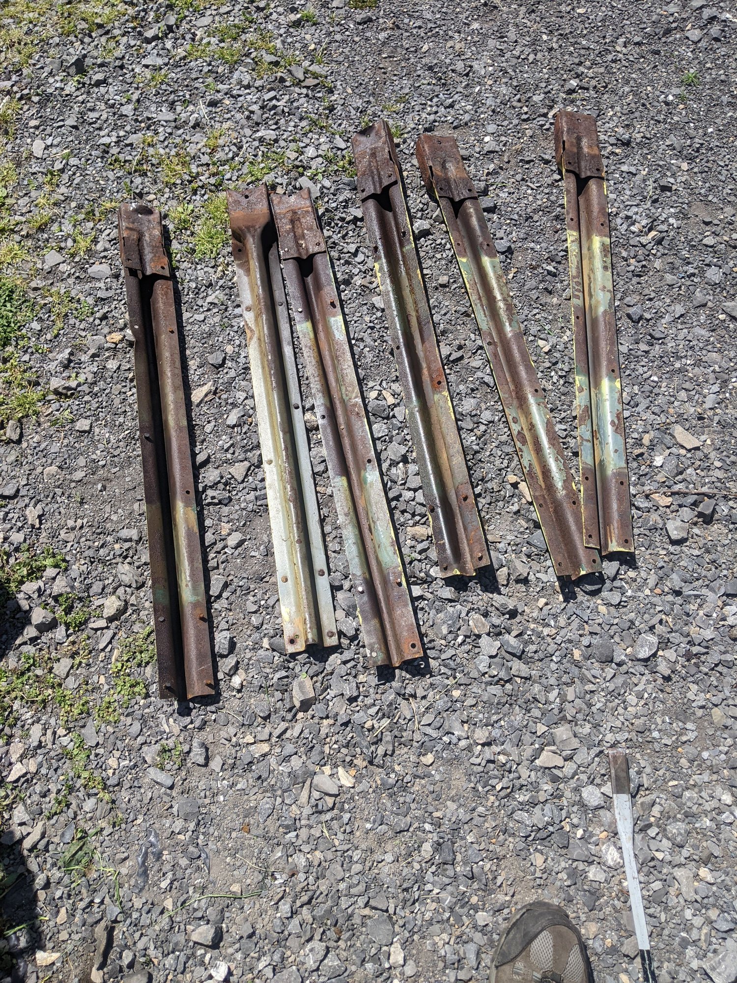

I got them out!
Today I got the 6 metal stakes out of my bed. I took John's (of Canada) advice and bought a MAP/Pro torch. The bed was upside down resting on a 50 gallon drum. I heated the pockets to 600°F. Then I held the iron bar while my buddy Bill stood on a step stool and pound with a small sledge. The iron bar was about ¾"×2”.
The two side stakes came out rather easy. The four front were harder. They were probably in place since 1955. There are two tabs in the back of the pocket. We pried them back to make it easier. We boogered the bottoms of the 4 front stakes from pounding them . But they're OK. Nobody sees that part.
So now set a date with the sandblaster and coordinate to get primer on within 3 days .
