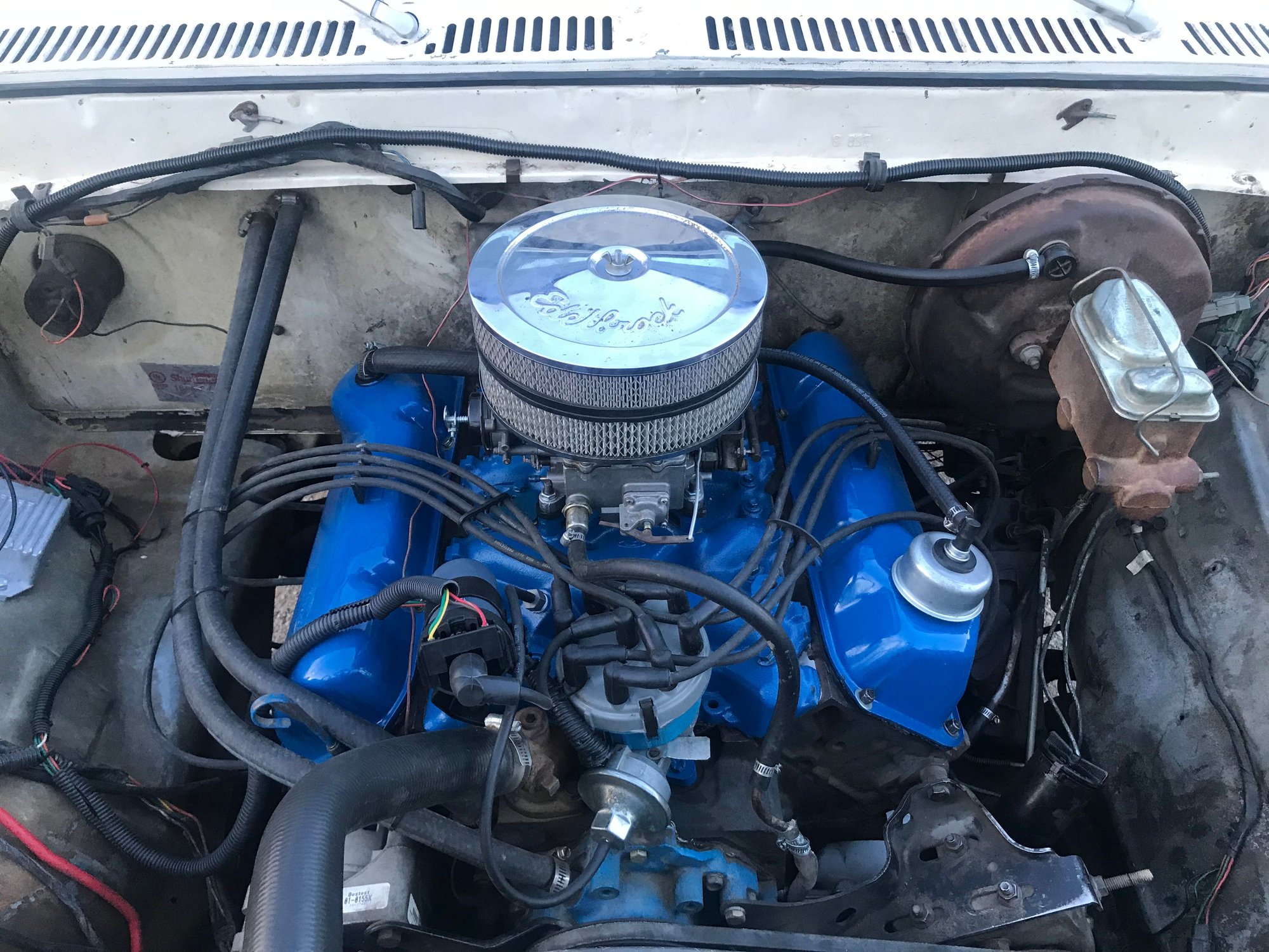

Did a compression test on my truck yesterday. Thr results are as shown
1-155 5-165
2-155. 6-155
3-155. 7-155
4-120. 8-155
the number one cylinder was covered in oil and crust. Not really sure it’s been firing like that. I know the plug gets spark. All 7 other plugs looked either regular or maybe just a tiny bit lean/advanced. I really just say that because I don’t feel like I’ve done enough tuning to get them looking how they should, but comparing to the color pictures in my Haynes manual they look pretty good.
i was gonna squirt some oil into the number 1 and recheck the compression to see if the oil made the rings seal up any more. If so then maybe the oil in the comustion chamber is coming up from the bottom. If the oil squirted in doesn’t make the compression go up I’m gonna assume it’s the valve guides/seals and I’ll pull the cover and inspect 1 but I’ve had it off tons of times I don’t think there’s much of an indicator to something going on with the seals. I could spray the top of the valve seals with some Wd 40 and see if they bubble or spray when turning the motor over.
The reason I was doing a compression check was because the truck keeps blowing the intake valley pan seals out.
Do my compression numbers seem like I have excessive blow by? I don’t think they say that. I think those are pretty regular and not that bad for a 44 year old work horse. I guess a leak down test would be the next bet. That could help me diagnose the valve seals too I guess.

What do you have for a breather set up ?

for years the truck used a 10 inch diameter edelbrock chrome 2 piece style with 2 inch tall filter. After getting tired of those gettin dirty constantly I now stack 2 10 inch diameter 2 inch tall filters on top of each other

I meant the crankcase breather, but I see you have something hooked up to the rear of the RH valve cover I assume it goes to your bottom air cleaner plate ,are you sure it's unobstructed ?
the pass side is unobstructed and yes running to the bottom of the air cleaner. Drivers side twist on cap has the foam under it but holding it up to the light without the pcv valve out of it I can see day light through easily. You can actually see what’s on the other side. I guess it’s possible that it is filling with oil vapor after the truck is running. I could pull that off after the trucks been running for awhile and make sure the foam isn’t soaked with oil.

It's been so long since I touched a 335 series engine I don't remember, is it baffled good under your breather cap ? if oil or anything else plug up your breather you're going to build pressure in any engine.
Remember it's all about the breather, because at WOT is when you have the most bypass and the PCV does virtually nothing when your vacuum drops.
