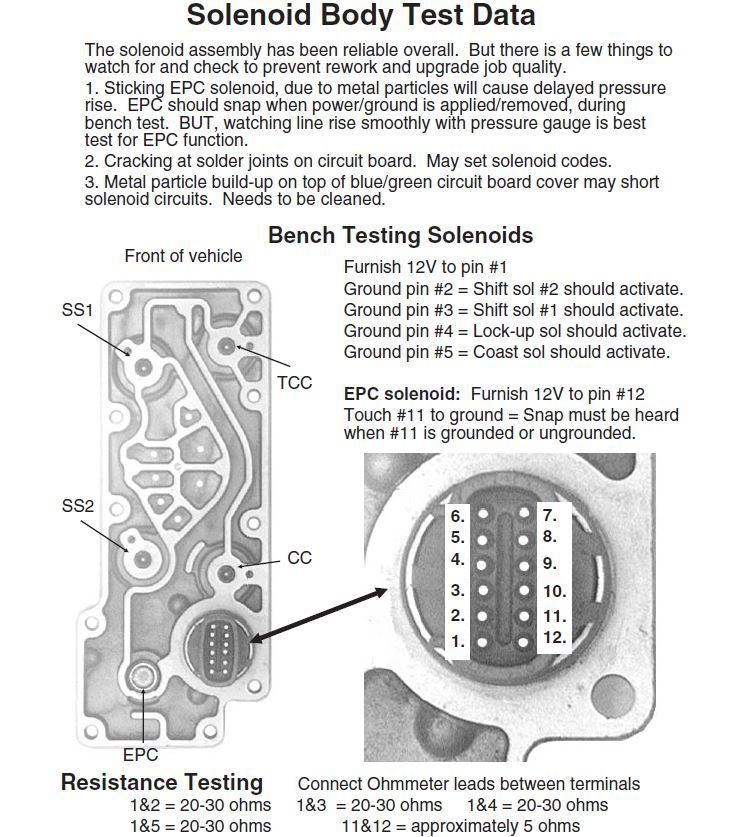

Another Update: Continued troubleshooting by removing pigtail harness to solenoid pack and inspecting all of the connector pins and wires. It all checked good so I hooked it up and rang through all of the solenoids with an ohmmeter. They all read 20.5 ohms except the TCC (Torque Converter Clutch) solenoid which read 14.4 ohms. I then used my 12 volt power supply to apply voltage across each of the solenoids while listening for a 'click' of them closing and they all did except the TCC.

You understand the solenoid pack you showed that you tested in this thread (post #5) was not within spec, right? The Converter would not lockup with that wrong/bad pack. You installed a pack after the one you posted about, that read 14 ohms, but just didn't post about it here? After replacing the one you tested, it read between 20-30 ohms? If I missed that, what post # was it?

It wasn't the solenoid pack. As I said we tried two new ones and the original, which was working before the tranny came apart. Also checked the valve in the pump and put in another rebuilt pump so it wasn't that either. I knew long ago it wasn't the solenoid pack as I had hard wired a ground switch to it and you could hear it actuating. If you've got any other ideas as to what it was I'm all ears but it wasn't either of those things, been down those roads and I'm certain of it. So, while I appreciate your concern, no I wasn't "taken" and you can stop worrying about me, or pitying me or whatever it is you are trying to convey here. I'm doing just fine thank you very much.
