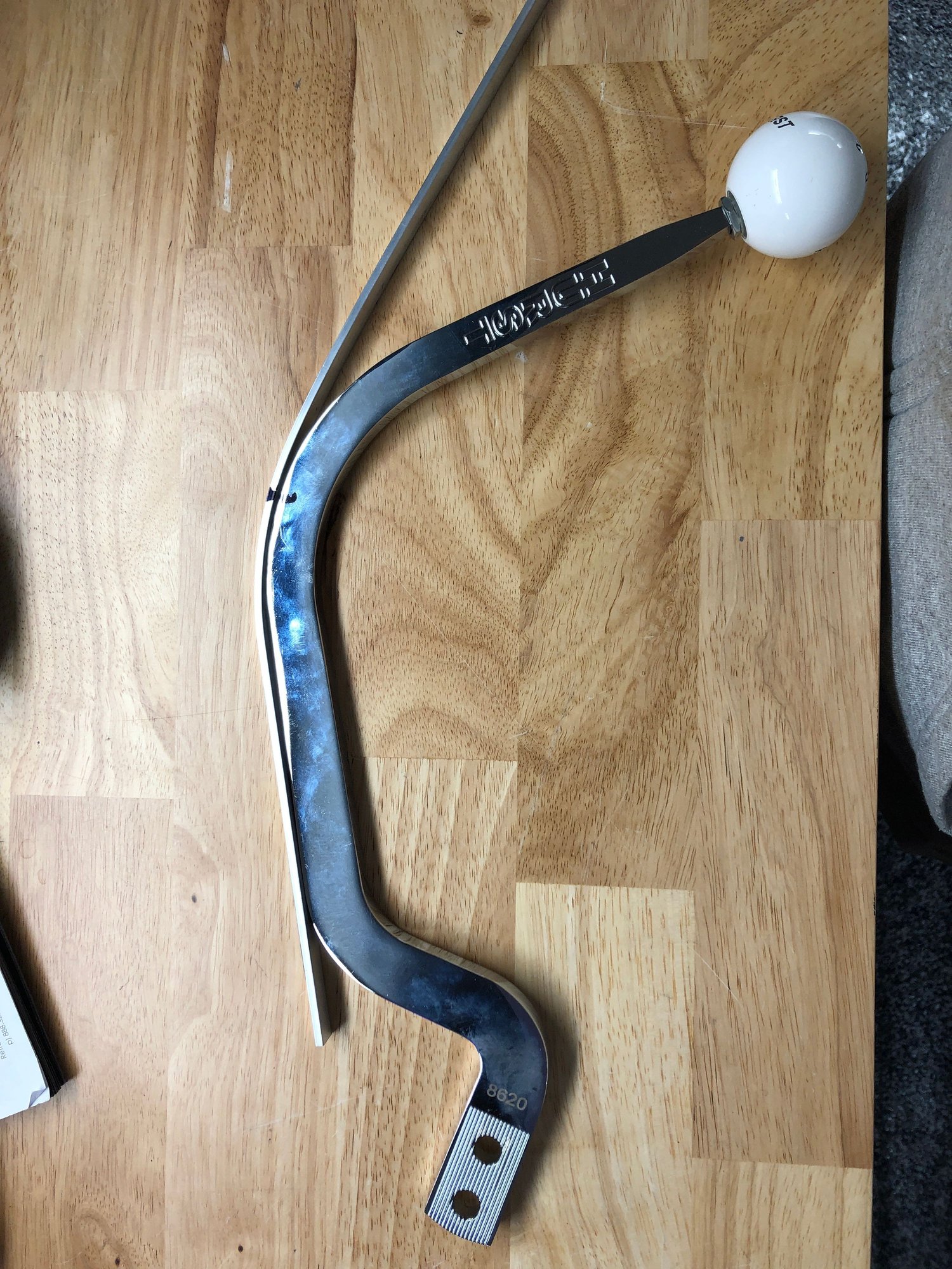

Also ordered a hurst bench seat shifter primarily for the 55 Chevy cars with bench’s, yet I still think I will have to move the shift mechanism forward. Anyone that has done this conversation if you would chime in and let me know if you had to move your shifter up?

As you can see the radius needs to be reduced to clear the bench seat.
I bought the same shifter and it won’t work with my bench seat. The angle that the shifter comes back needs to be reduced. I haven’t found a shop that is willing to try to bend it yet.
I have the 4 speed top loader.
The thin rod is the angle it needs to be to clear the seat.
can you not just heat and bend in a vice?

If I had a good vice and some metal working tools I would.
The shops I've talked to are too timid to try.
Here is the pic of the interior WITH A DIFFERENT shifter. The shifter pictured is in N. The Hurst bench seat shifter has too much angle to be able shift into 2nd or 4th. Look at the angle compared to the leading edge of the seat. Remember, the shifter in this pic is not the bench shifter. It's the only pic I have to illustrate the seat/shifter position. Does this help explain the issue?
