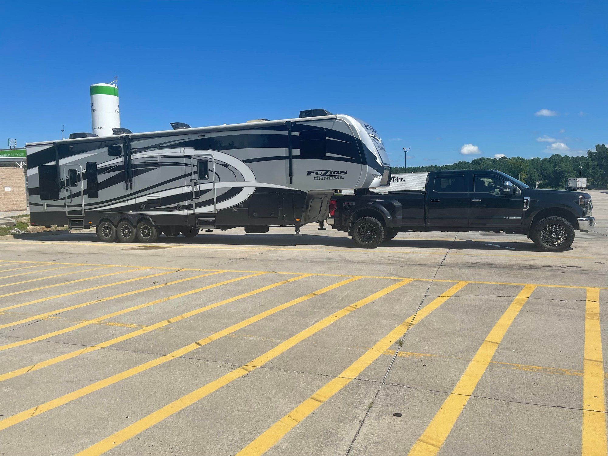

Howdy guys and gals,
I just picked up a 2020 F-450 Crew 4x4 Limited to pull my 2017 Grand Design Momentum 397TH and I need a 5th wheel hitch. When the RV dealer dropped it off for me, the driver was pulling it with an F-350 DRW and for some reason his setup couldn't tackle even a 6" rise over 4' without the camper rubbing on his bed rails. So as to not waste time or money, I'm wondering if you seasoned folks might advise me on what type of hitch I should get after.
The hitch weight on the rig is 3,400 lbs and the GVWR is 19,500 - that stuff I suppose is easy enough to figure out when looking for a hitch, but I'm lost on finding the right brand that will perform best, last longest and sit at the right height to avoid bed contact.
Any advice is greatly appreciated.

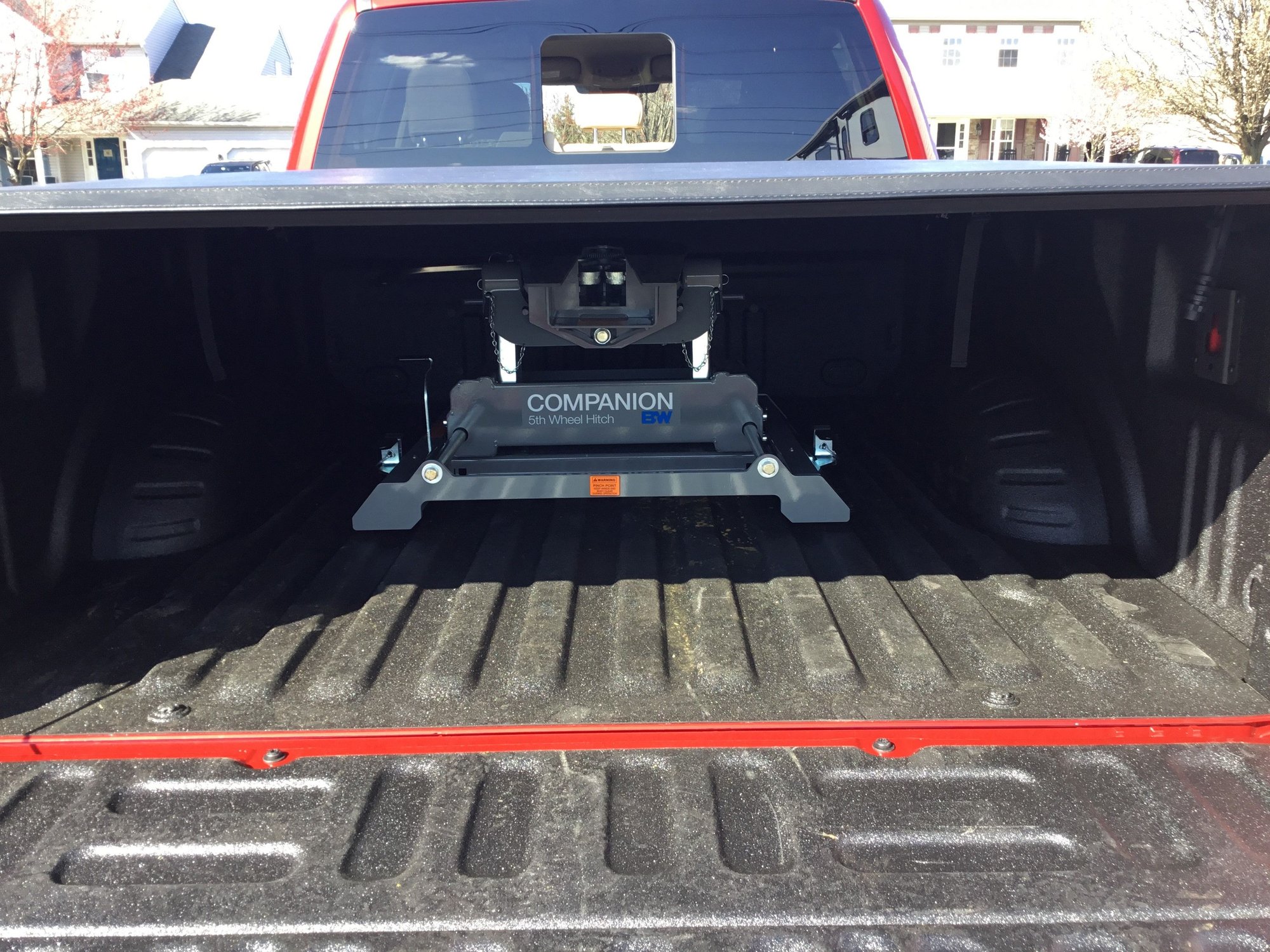

I run a B&W Companion 25K slider. I have a good 7 to 8 inches of clearance between the bed rail and camper.
