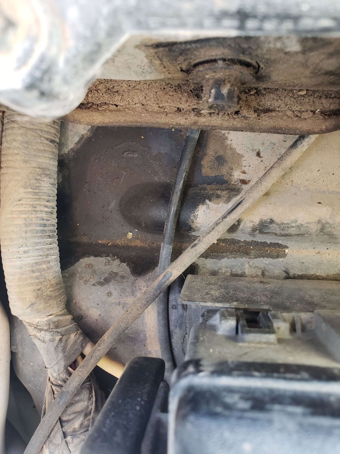

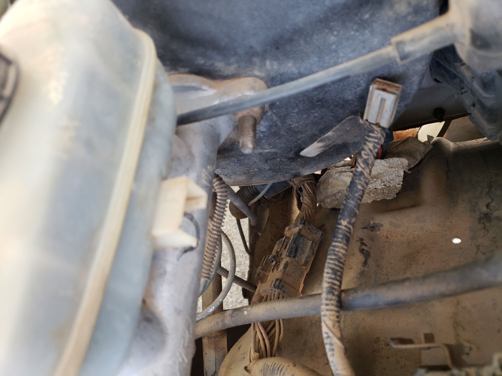

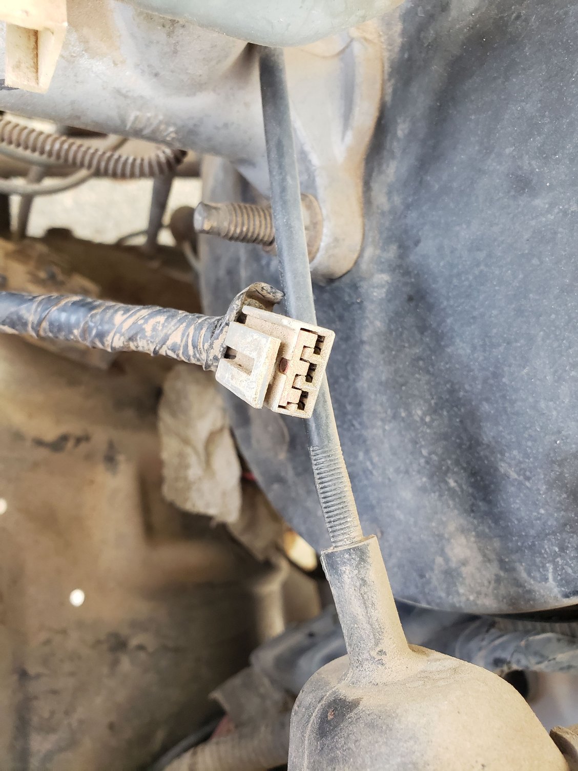

Was in the engine bay trying to figure out why my 92 F150's Cruise Control suddenly stopped working after I replaced the automatic shifter. Inside the engine bay, I have a disconnected 'car heater hose' and a wiring harness NOT connected to anything. Looking under the Master brake Cylinder, I see a space that looks like it should have something connected to it underneath? I don't know for sure.
I DO know the previous owner told me the original owner disconnected the A/C. However, he did not go into details about it. So, I have no clue what this stuff is???

That connector goes into the side of the Master cylinder and the hose connects to the rear firewall side of the air box.

But there is NOTHING for that wiring harness to connect to on the side of the master cylinder...Looks like something USED to be there, underneath it, but it's not there anymore.

Looks like there's a float switch in there to tell you when the brake fluid is low. I don't know if it's available on its own, looks like it comes with a new res though.

Yes it is a fluid level sensor. It would take a new MC to make it work since the connection is missing. Or just keep an eye on the level when you check your oil.

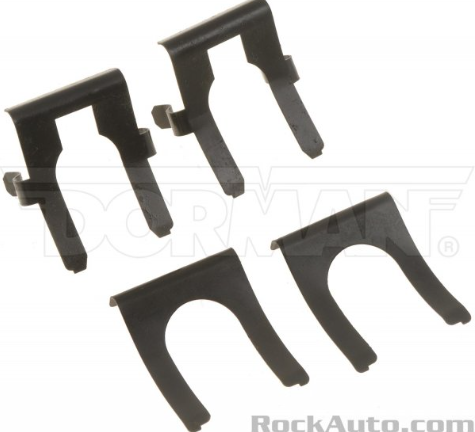

your hose connects to a small filter inside the air intake housing, its part of the PCV system.
these clips hold the hose/filter in place in air intake housing
Old Apr 23, 2022 | 08:21 AM
RA082222's Avatar
RA082222
Joined: Mar 2022
Posts: 85
Thanks. I am obviously missing those clips. I will get them.
