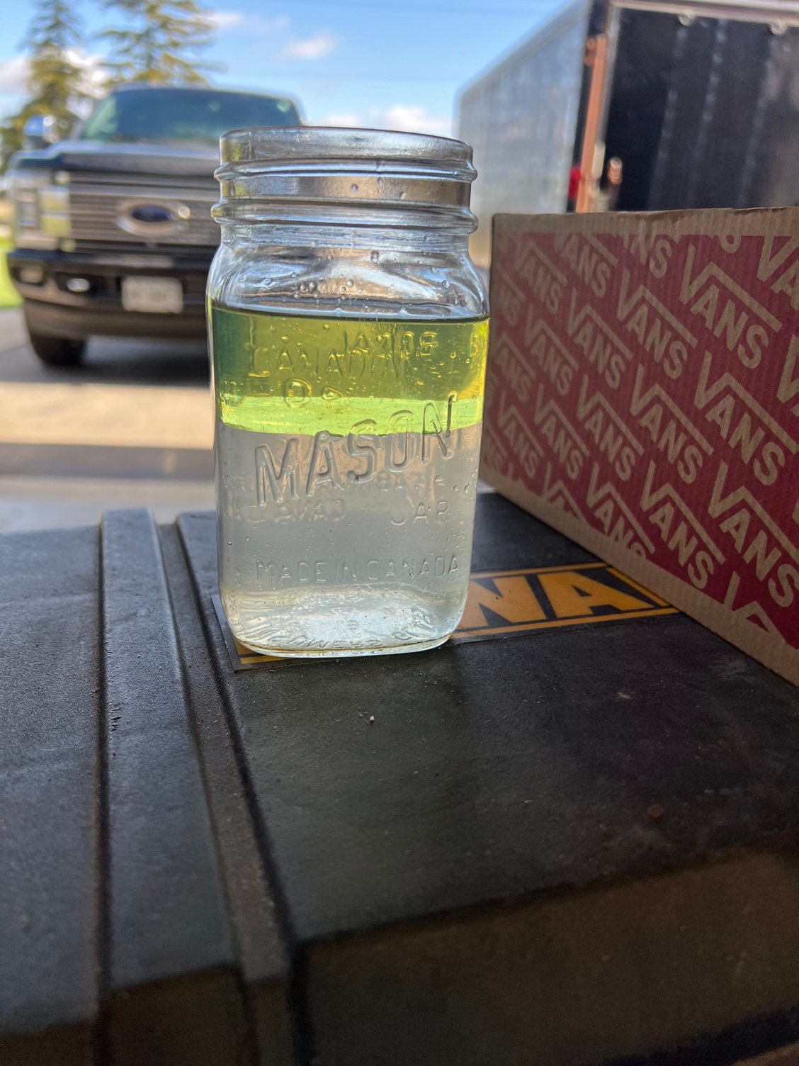

This is how much water I got from the water separator in two weeks…the dealer drained it last when I had the oil changed 2 weeks ago.

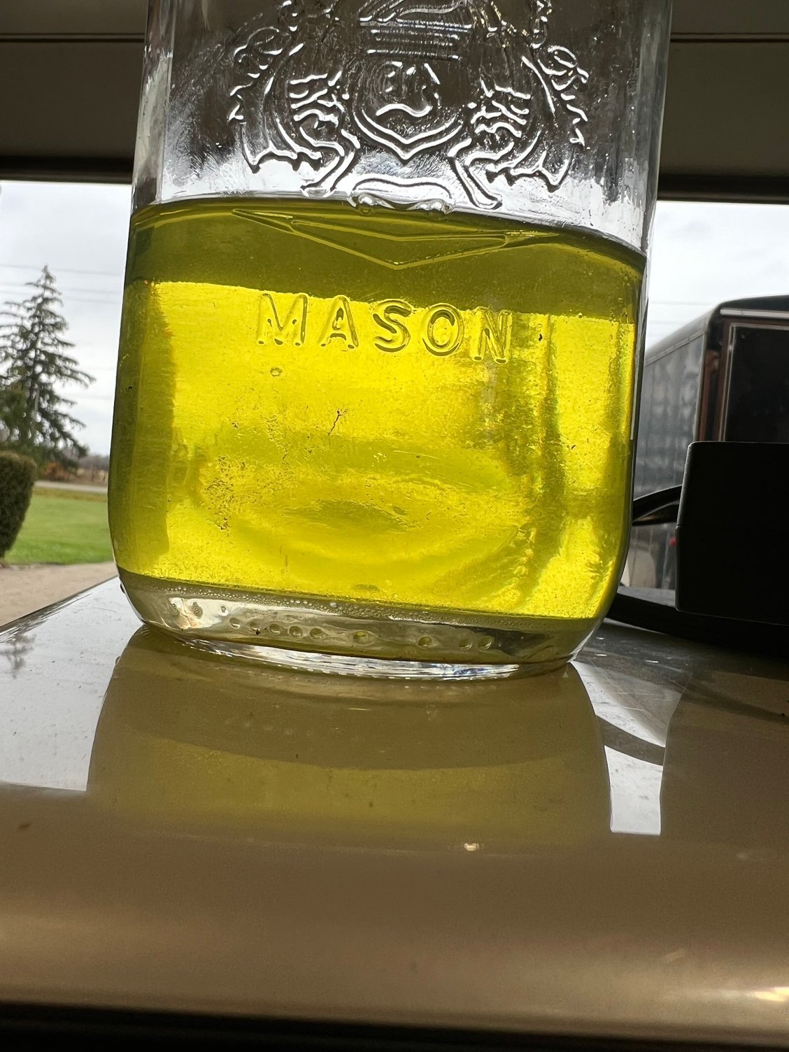

The last picture is what I usually get after a month or so. Which I find to be odd.

That's a lot of water to come out of the pumps and no one else be affected. You may have a special friend trying to water your truck.

Holy schitt that's a lot of water. I've never seen so much as a drop of water in my separator.
If I were you, I'd keep draining the separator regularly, and make sure you're running some additive. I like Opti-lube. I also recommend the S&S DPK.
Hopefully the separator caught it all and you haven't done any damage yet.

I’ve had a 06, 09, 12 and never seen water in any. Until this 17.. so I never thought to drain it until the light went off a little over a year ago. Since then I drain it every 6 weeks or so. Changed the separator filter 4 times.
Usually what I get is the bottom picture, which I thought was odd because I never have dealt with water ever before.

It doesn't look like DEF in fuel. There's a clear line where the water is.

Holy crap…. Your bottom picture “normal amount” would freak me out. The other amount….. IMO that much water is almost certainly from an external source - a leak or intentional adding of water to your tank by someone. You haven’t really ticked someone off recently have you??
