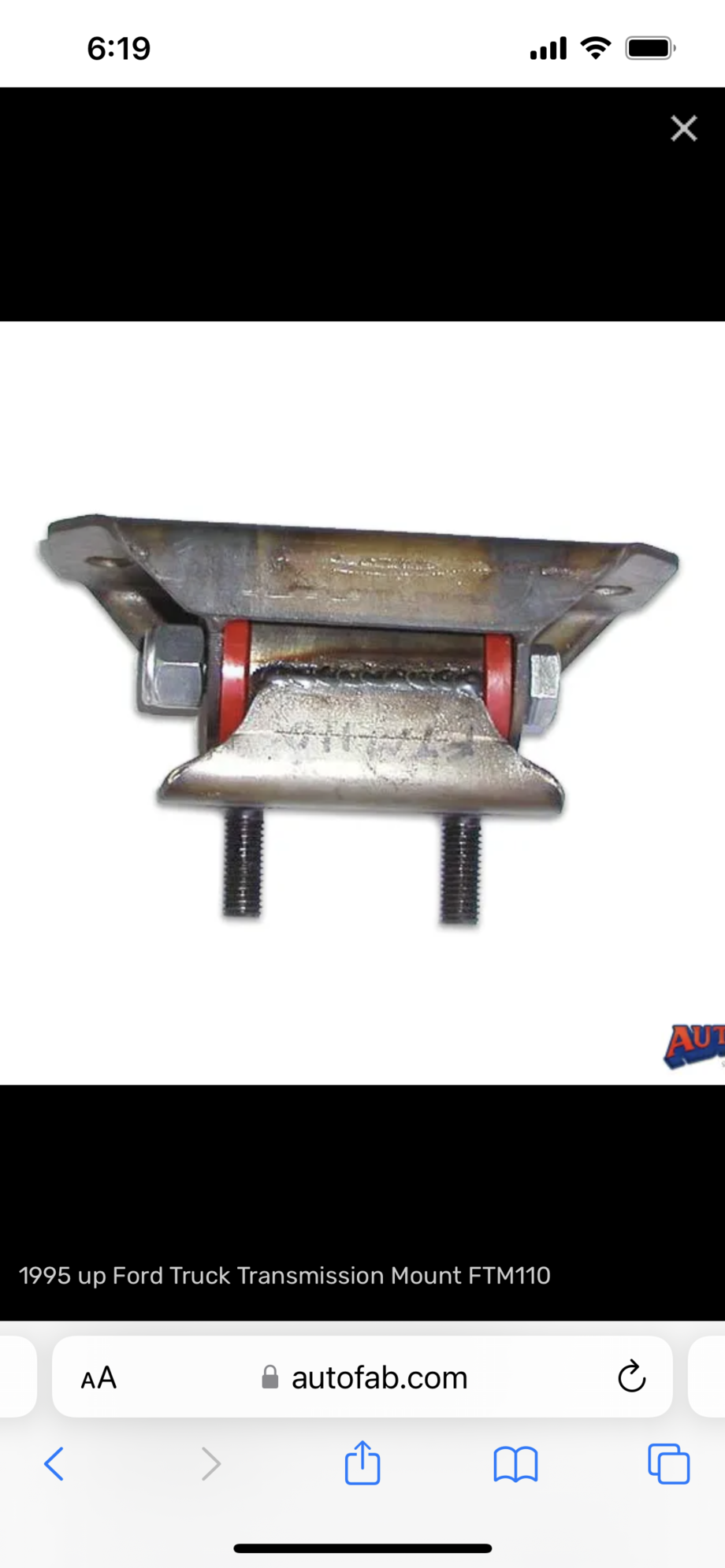

I’ve been chasing a bad clunking noise in my truck for a while and having already put a few transmission mounts in before I’m thinking I’ve broken another one.
The truck is 97 extend cab, 7.3, 250/100/s366 ( makes quite a bit more than stock power) has a zf5 4x4 with a south bend dual disk clutch(650hp), a custom single piece aluminum driveshaft, and a rear grizzly locker.
Even with traction bars the truck still seem to have a lot of axle wrap/ torque twist going on.
I ordered a solid style mount from auto fab, which is a two piece deal with a poly bushing around a bolt that connects either pieces.
Has anyone ran one of these before? Or a solid transmission mount? I am running brand new rubber stock style motor mounts. Should I be worried about damaging anything running a solid trans mount on the street?

I would be concerned about cracking the transmission bellhousing. When the motor torques, it is going to take something with it.

im obviously concerned something like cracking the trans case, but this mount seems to have a little play and I’m hoping it’s be okay especially since the trans will still have the play of motor mounts

By definition, that's not a solid mount, it clearly has a bushing. It may be stiffer than stock, but it should still have some give.
Solid would be, steel to steel, no give.
Either way, I agree, you're just going to move the stress to the next weakest component, and break it.

Well I’m hoping this is the last weak link, and a mount like this will hold down the transmission without stressing other components to the point of failure.

i Did get the the new solid style trans mount installed this weeken, and it is quite a difference. It really tighted up drivetrain slack, the truck takes off from a stop smoother and is really smoother in every situation. There is a little more vibration when I really lay into it but nothing unbearable. The mount had a a lot more polyurethane than I imaged and after talking to John over at auto fab I’m not worried about damaging anything with this mount. Very happy
