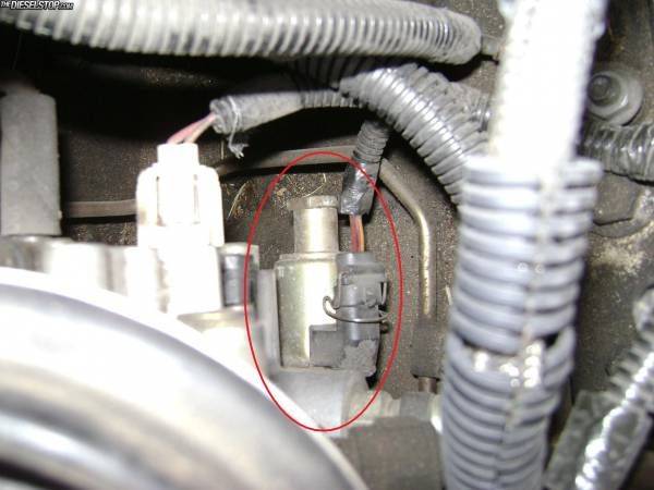

First thought is check the tin nut on the rear of the IPR. It can walk loose and the IPR will not work properly. Snug it up but don't crank on it, it's flimsy. I'll post a pic below.
Also inspect the wire harness where it drapes across the driver side valve cover at the 42 pin connector. It can chafe and cause shorts there.
