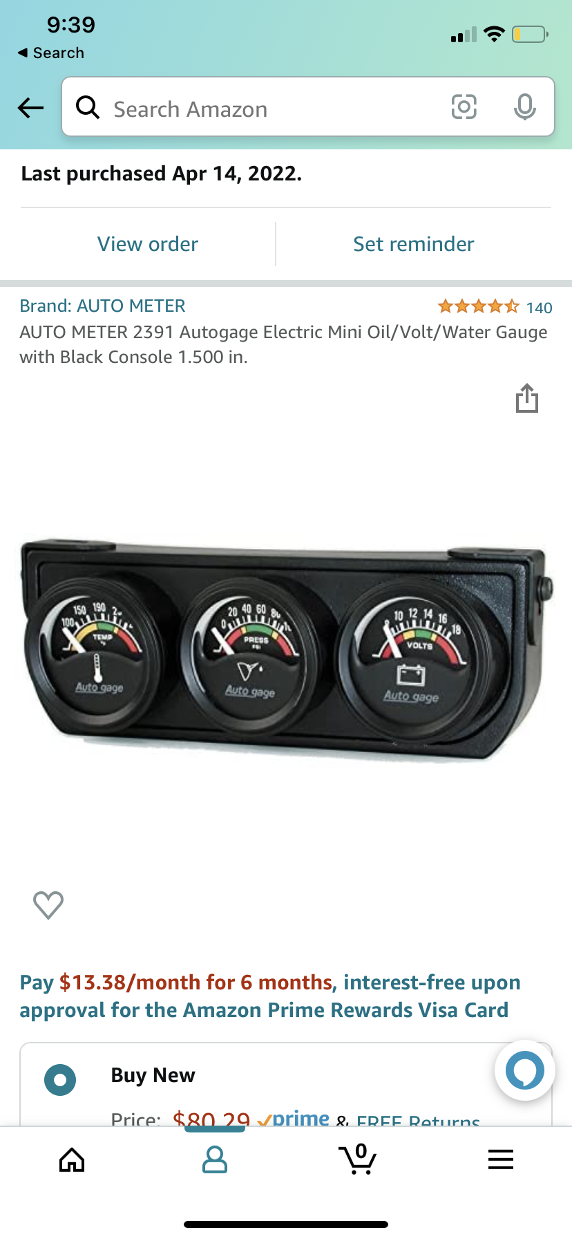

I’m looking to install some aftermarket gauges under the dash. I just bought autometer 2391 volt, oil pressure, and temp gauge.
I want to give it 12v power with the key on. I know I can hook into the radio wire. Is there any way I can put in a power distribution block like this that I can power and ground other things from in the future without going back into my wiring?
