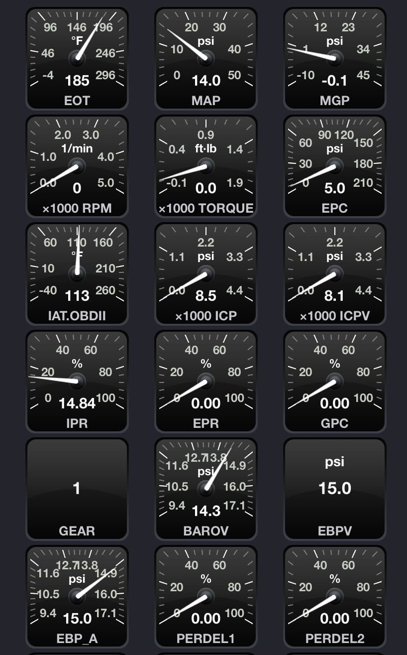

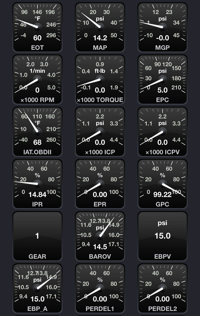

I have been having a slight glitch when at idle occasionally for the past few weeks. The only relevant code is the EGPV when running tests... But here is what I found engine warmed up (just some running around not normalized) and cold.
My thought is it is time for the new tube and sensor.
Any other tests anyone can think of please give some input..
Jimmy

It looks like it's stuck on 15. What's it give you with KOEO? And I wouldn't replace the tube if it's still good.

Both screen shots are engine off key on.
When running at idle it is about 1 psi higher than manifold and under load it does vary. I will see about a couple screen shots in a bit when I head back to the house when driving.

Changing the tube can't hurt and the difference between the MAP and EBP looks consistent. I'd say that the sensor is off.

That is what I was seeing.. Thanks for the confirmation Mark...
