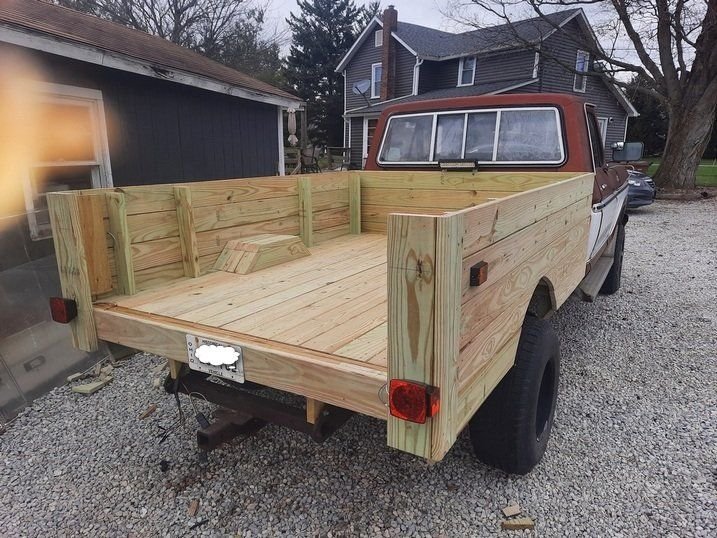

Now it you use to much wood to "protect the bed" you have to spray for termites.
