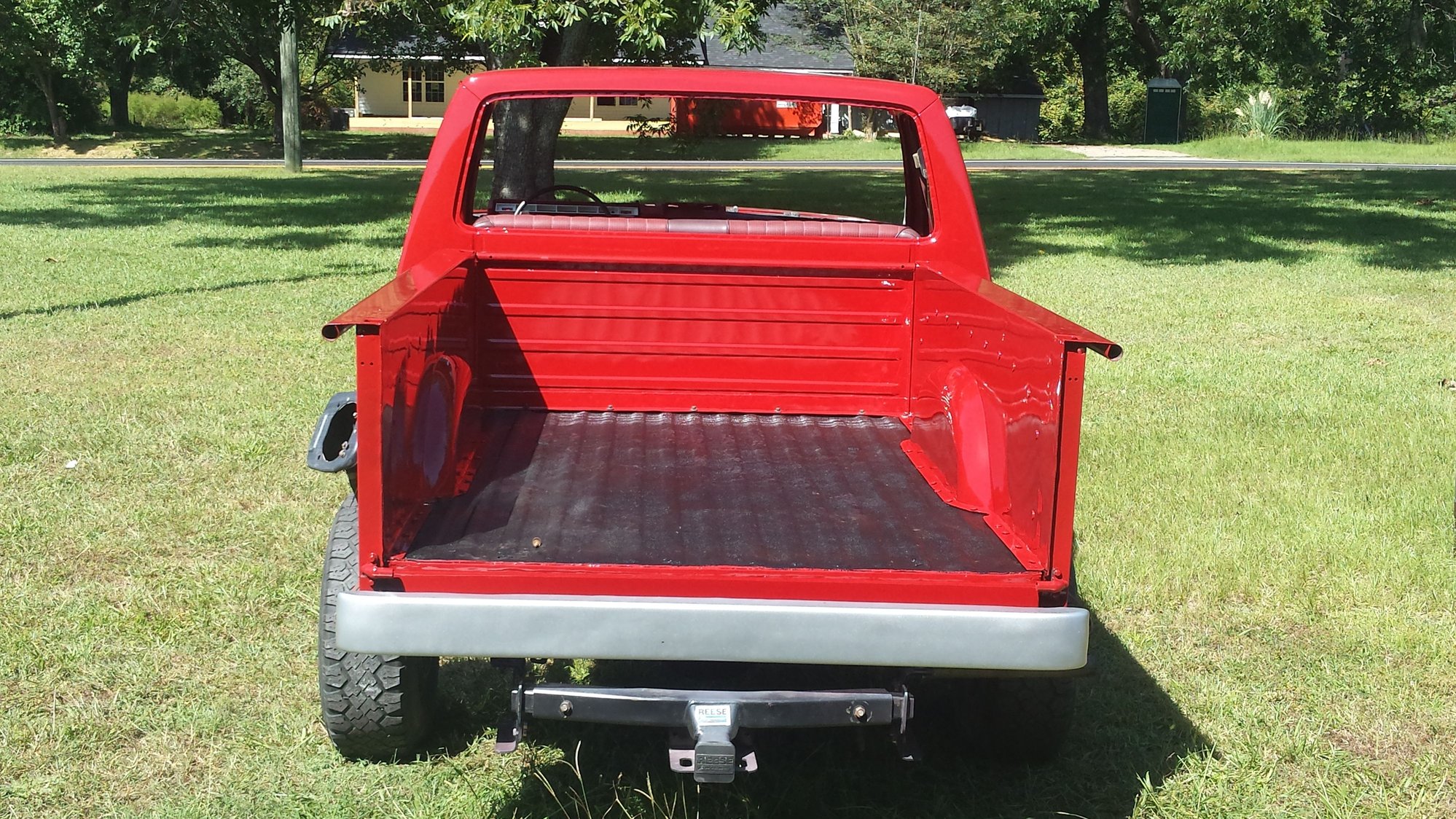

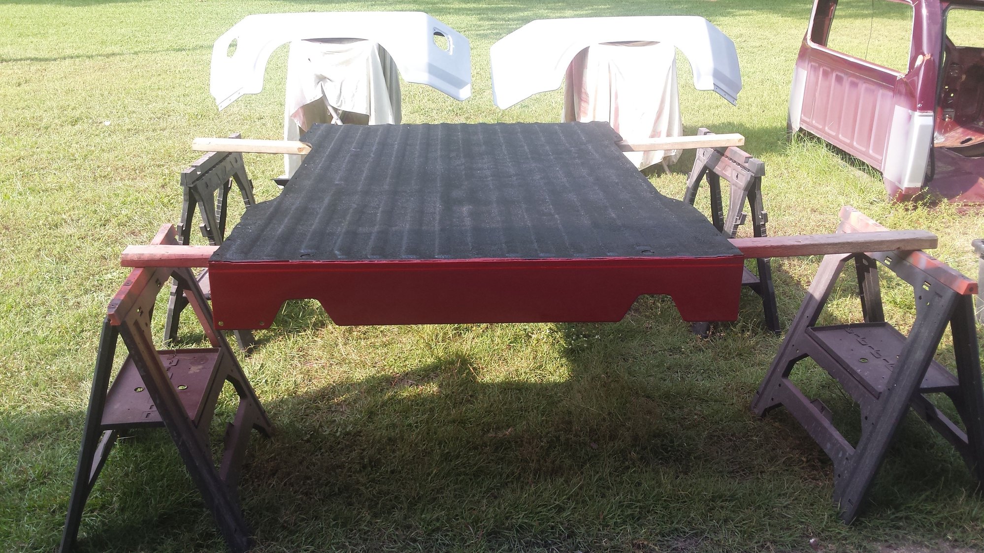

And for the hatters I have a metal ribbed floor in my 81 flare side and the floor from the parts truck was lined so I left it.
I am not afraid to put anything on the floor, walls yes, and if I had the wood floor it would get messed up and need treating every year.
