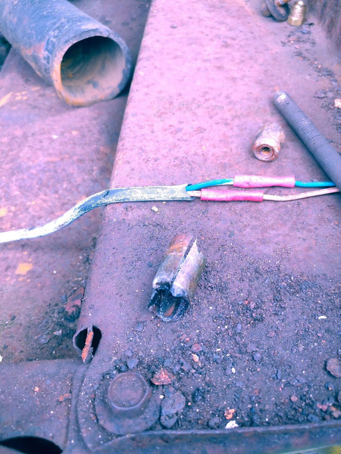

Here's how it worked out. Might help someone. Used hacksaw blade to groove inside of fitting. Applied torch to fitting. Collapsed it a bit and it came right out. Apparently it is not threaded at all, just stuck/pressed in. Will probably file one side of a 90 degree barb and maybe JB weld it. Way easier than expected.

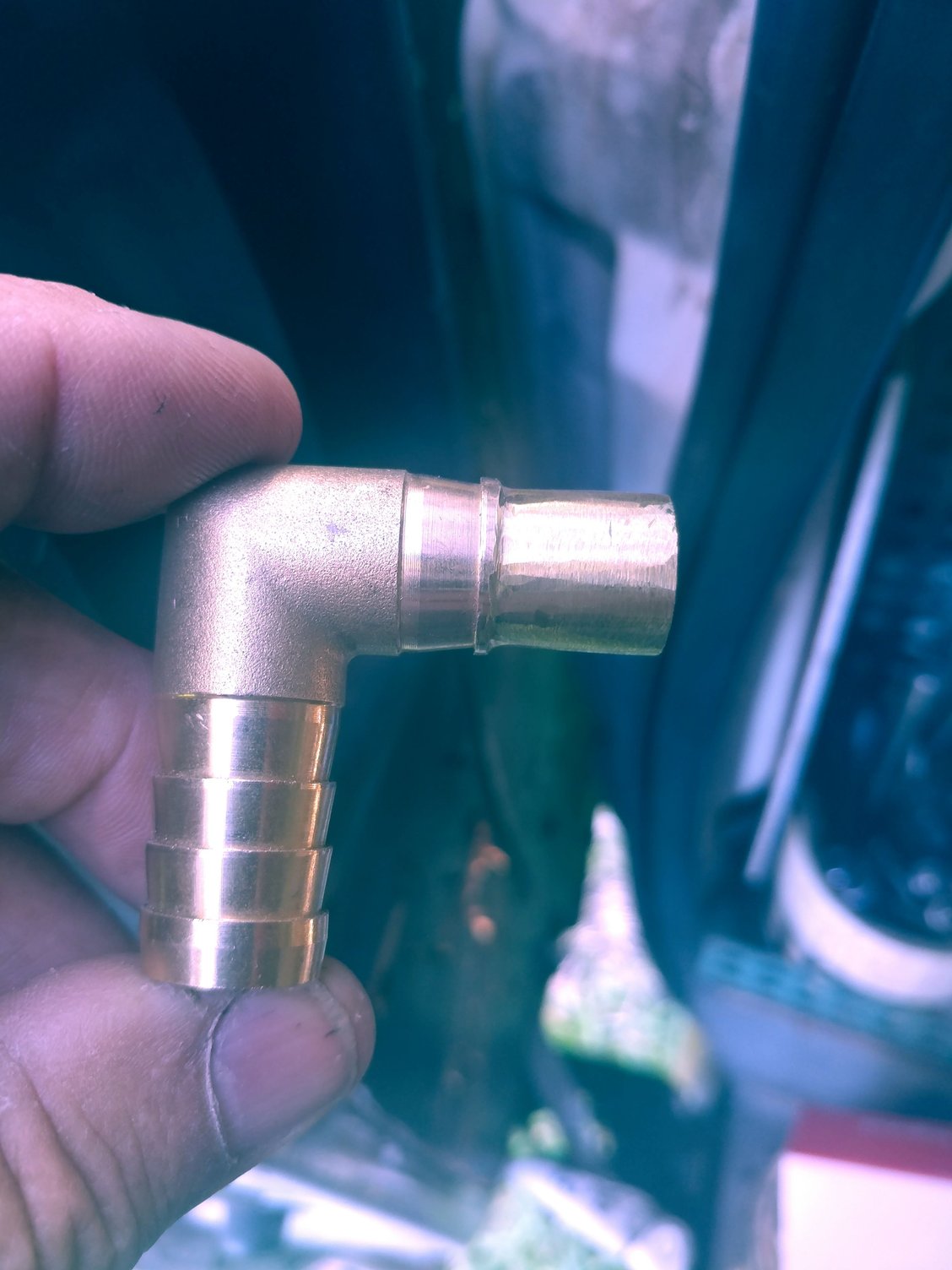

If it's a 5/8 hose this might work .https://www.napaonline.com/en/p/BK_6...pressionRank=1

That looks like the one.

Here is the fix I used. Purchased 5/8 brass barbed elbow. Ground down one side to fit intake. JB Weld to intake. Seems solid.
