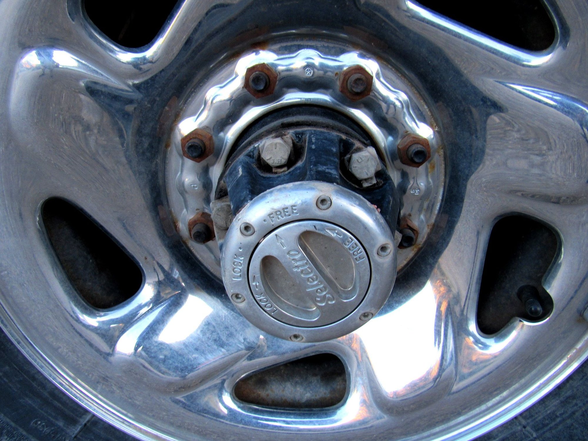

My truck came with these Selectro hubs. They work just fine but I would rather have a set of factory hugs like the ones you are replacing.
One of these days I will find a nice set of the factory hubs and they will replace my current Selectro hubs.
