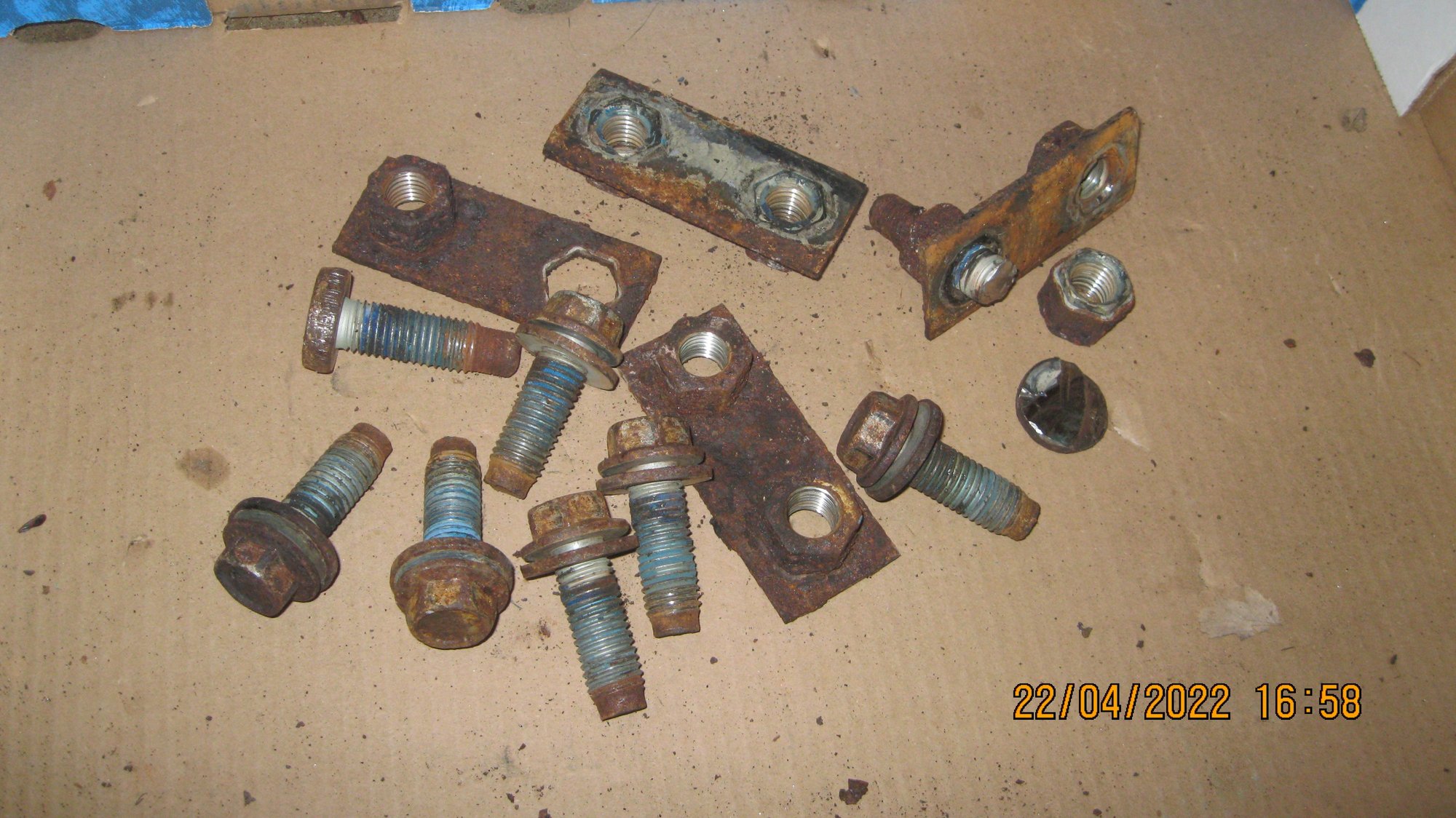

Also, have all the bolts off, using propane heat and a 1/2" breaker bar with a 3 foot pipe extension.
Bolt heads with round washers were on the bottom, nuts with rectangular washers on top, with two nuts sharing one rectangular washer.
The nuts were attached to the washers so you have to unscrew the bolt heads, not the nuts.
Was surprised I could start them turning with just the breaker bar and then knew that heat would do the trick.
On the two round head bolts the pipe wrench worked.
On one of the nuts it broke loose from the washer it was attached to so had to hold that one with vice grips after heating it to be able to turn the bolt.
Nothing worth showing in a photo here.
Will say it worked better heating the nut more than the bolt to melt the blue thread lock.
Also, used big C-clamps to hold the thing on while the last bolts were removed.

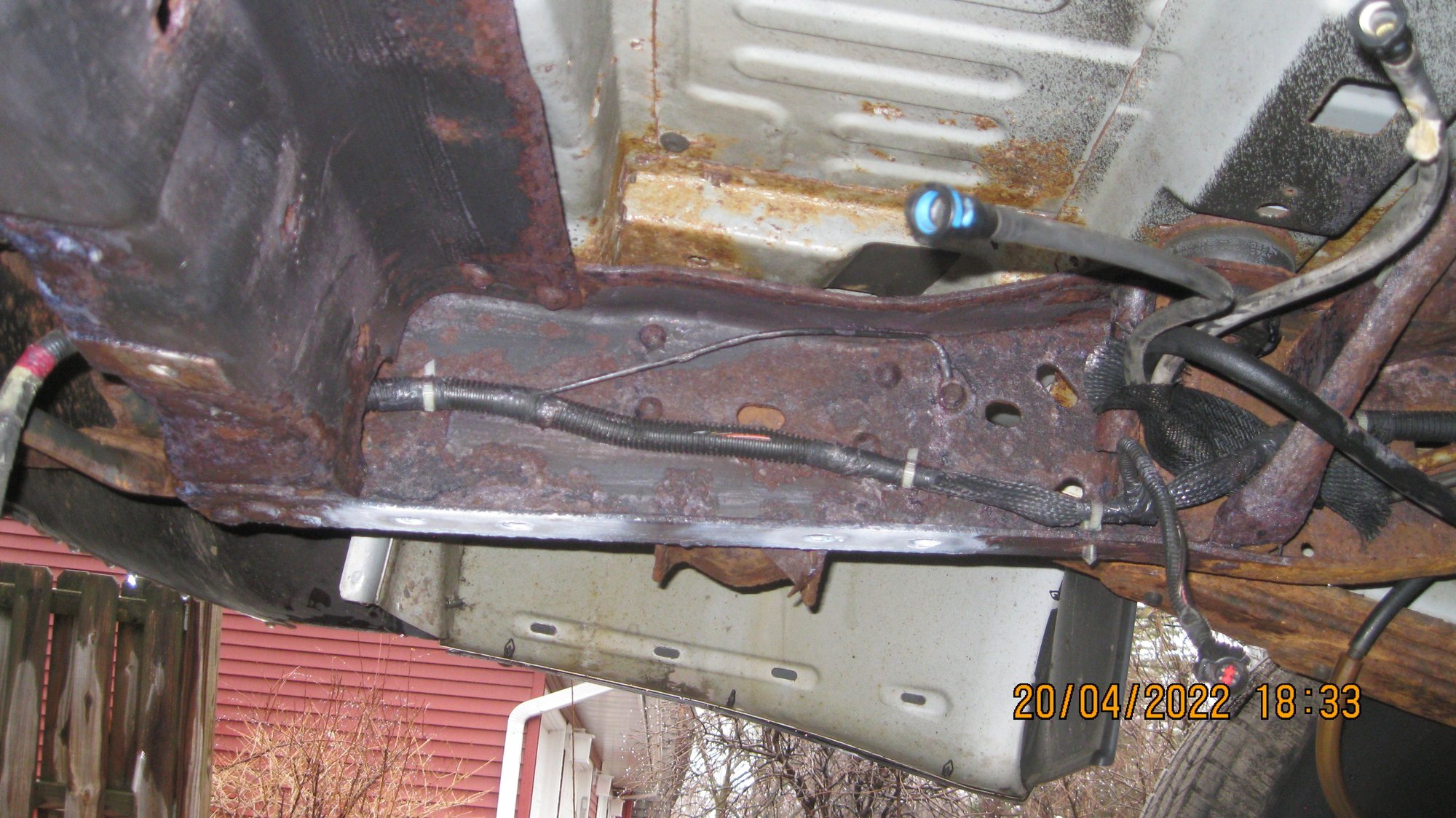

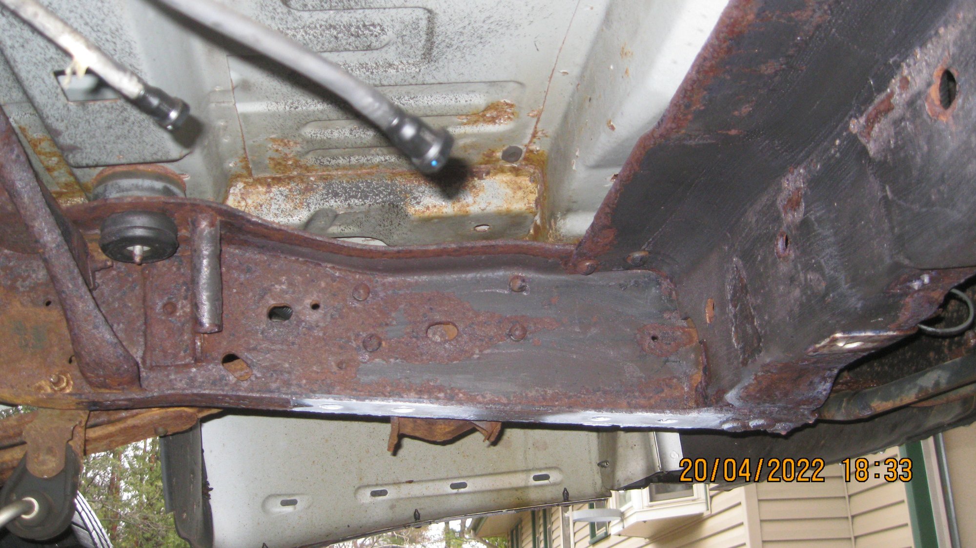

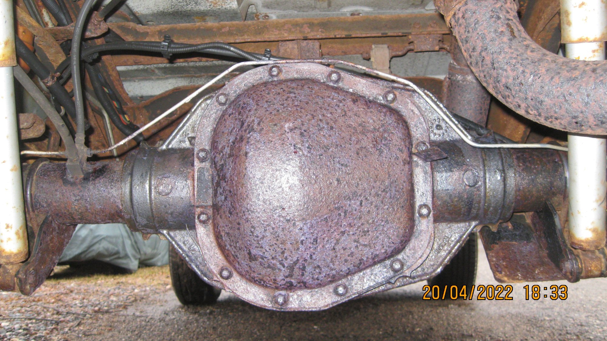

Been a frustrating time since last post, with cold rain and even snow, but did have a day or two to be able to apply one coat of rust preventive to some items, and got parts like the replacement fuel filler neck and 1 1/2" hose to the tank.
Made a cardboard template of the frame holes with white spray paint and they will line up with the hitch receiver holes just fine.
This weekend the plan is to finish the rust preventive and gloss black paint, and maybe get at least the hitch receiver bolted on.
The tank itself will be a bitch but have no doubt that it will go in.

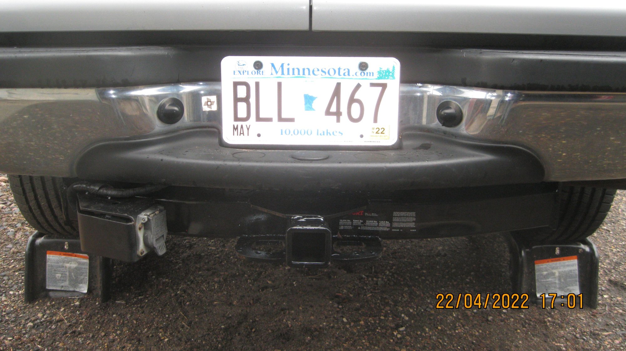

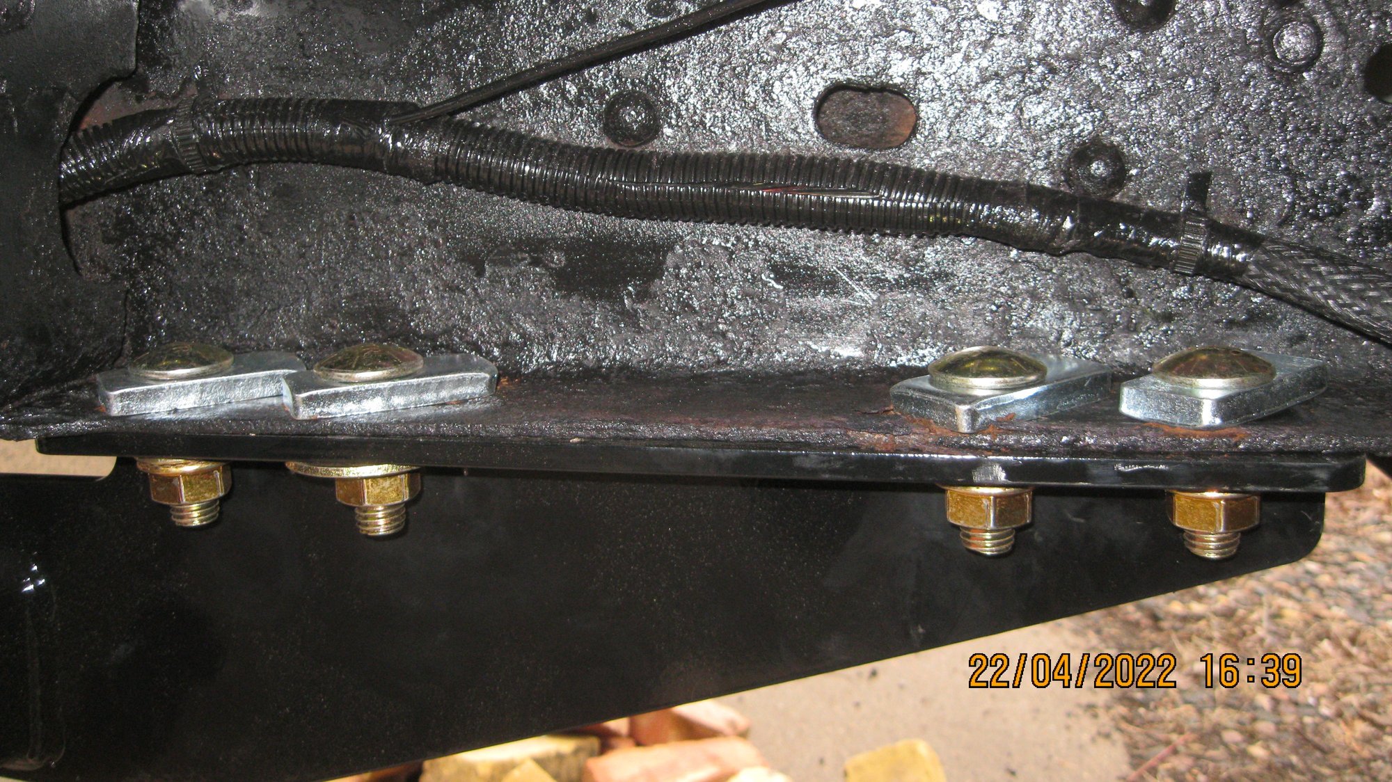

Hitch is in, weather permitting gas tank goes in this weekend.
Brushed two coats of the rust preventer on everything I could reach yesterday, today sprayed 3 cans of the gloss black paint on everything, including the installed new nuts and washers.
Torqued the carriage bolts to the specified 165 ft. lb. and used red thread locker, plus there were lock washers in the hardware.
This thing will NEVER come loose.

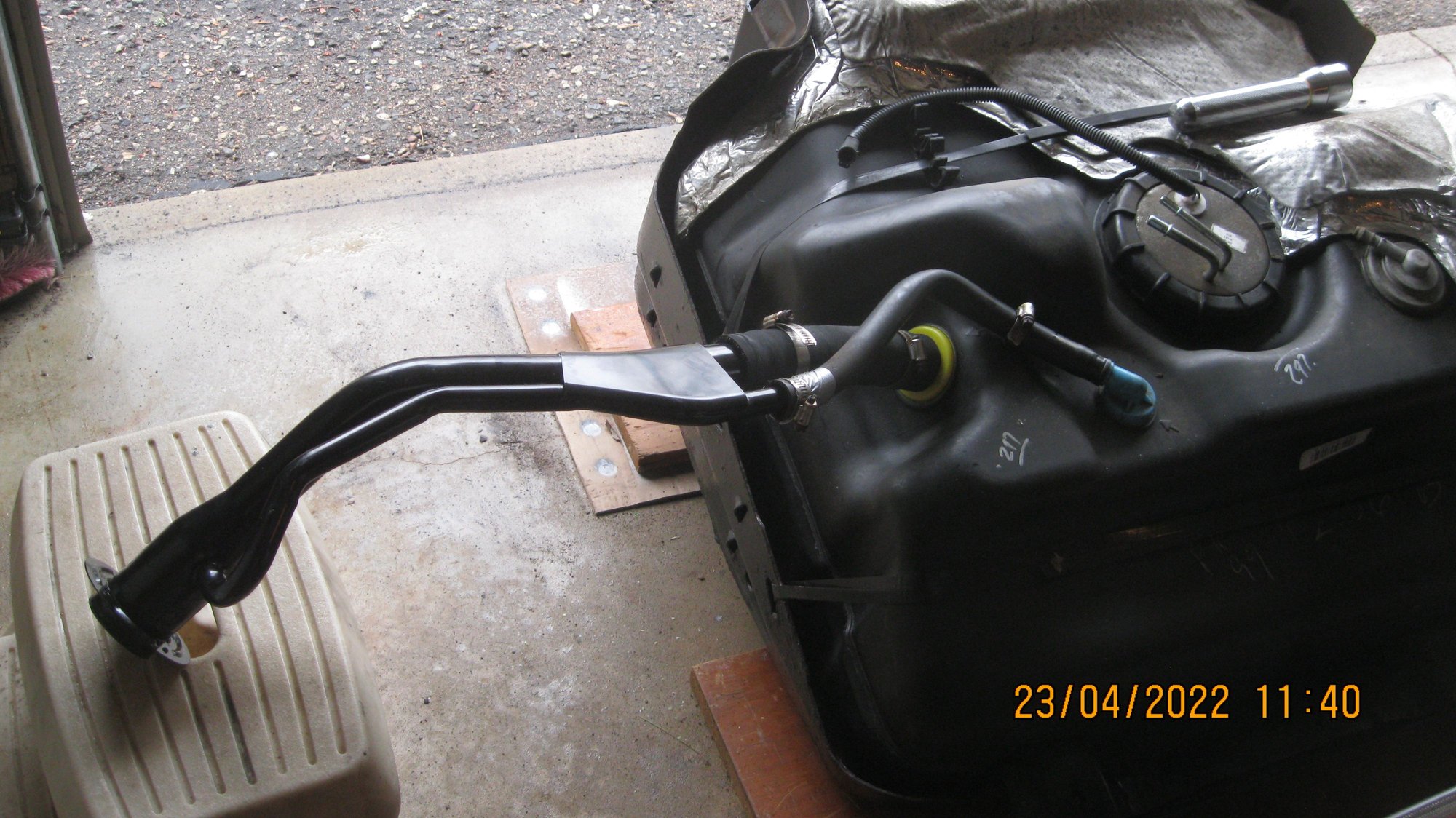

One last photo, this is a test fit of the filler neck with hoses on the tank.
You will notice that I installed the filler neck upside down in the photo and discovered that after lifting the tank in place.
Further, I had the 1 1/2" rubber line 180 degrees the wrong way so it kinked too much.
I had to re-lower the tank, undo the hose clamps and re-arrange.
I'm usually pretty good at anticipating problems but this one caught me.
Can't decide whether I am more steamed at myself or Ford, so I choose to blame Ford.
