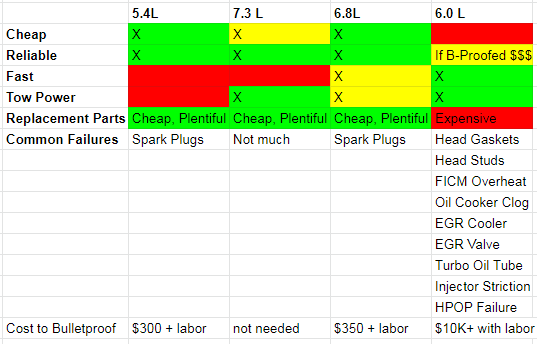

1. I use mine to tow a 30 foot trailer, it is what it is but mine is also quite far from stock.
2. I paid 7K for my V10 with 180K on it, there are deals to be had you just have to keep your eyes pealed. the 7.3 is the Bulletproof, Reliable, Tow monster, but its not fast, I love my V10, but for a Excursion "doing large amounts of towing" i would do a 7.3 if i had to do it over again, if i towed a lot, which i don't.
3. The 7.3 Diesels typically live longer than the rest of the truck, You can put 500K on them with regular maintenance and taking good care of it, and moderate part replacement could take it to 750K. V10, probably 350-400K again well taken care of. However the 6.0 has a nickname, 6.NO, there are a laundry list of things that will fail if not replaced with upgraded components, a friend has one and is constantly fixing something on it, they are also known for blowing head gaskets if i recall, some people swear by them, but usually not until after they have been "bulletproofed" as to say they have had all the detrimental parts upgraded and replaced with higher strength parts to prevent the long list of failures that are possible.

no riots needed, its as simple as this
