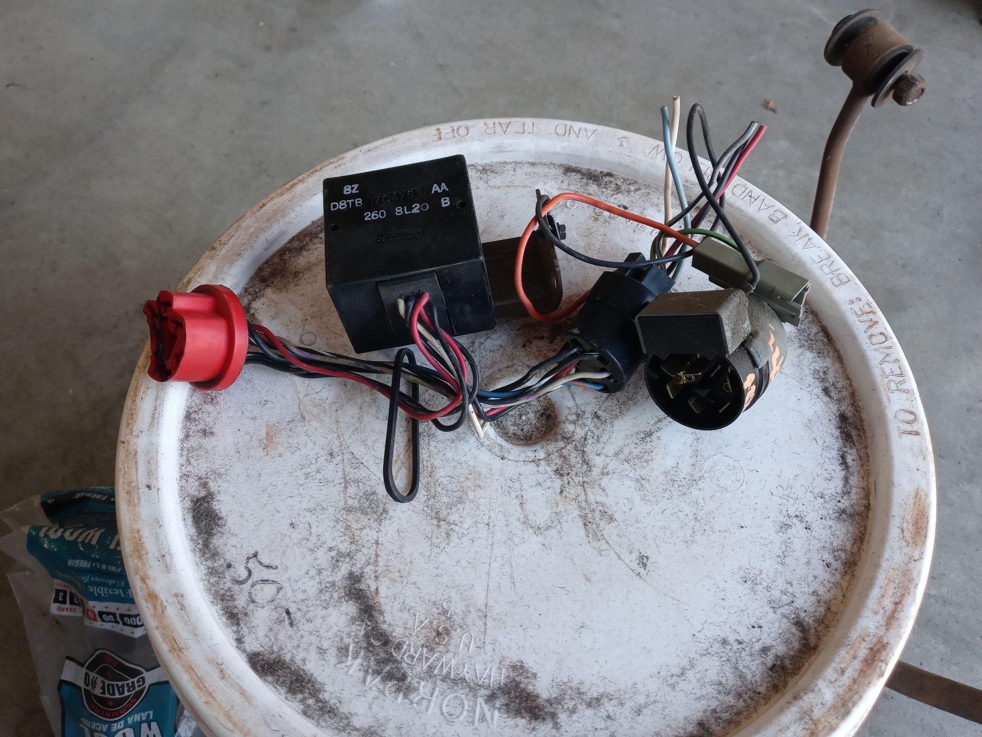

went to junkyard again today and found these
Rear Sway bar off 79 f150 sorry CreigN. Did not have a twin.
Sway bar clamps from 79 f150
Intermittent wiper switch

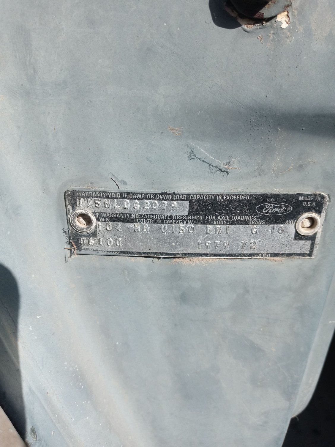

my truck is Style side long bed. If you search for 69 f100 brought home roadkill style I have photos of it there. Well I will still keep an eye out I'll message you if I find another one. I will try putting it on tomorrow to see if it will work or not and report back to you. It came off a 79 f150
This is the tag for the truck I pulled it off of

What vehicle did the Intermittent wiper switch come from ? Is it proven to work on 1971 F100s ???
YEs it proven. And mine came out of a 79 f150
Here is a link that shows how it is done.
