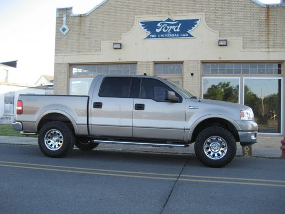

Yes about the only way is to lower it and go down to 33's...285/75's. In the end maybe get better gas mileage, better handling/braking and acceleration. And maybe easier on the knee getting up and in. Wide style OEM running board (black and ribbed).
I have an 07 4wd CC F150 and ditched the tube style nerf bars for the running boards. Also FYI the cab grab handles are prone to breaking when the little too short screws holding the metal plate to the plastic handle get loose and it lets the handle roll and breaks inside. When I got it it had the slip style nerf bars and them goofy rims...
Nice FX4 rims and OEM running boards. Sleeper stock look with 285 BGF's.

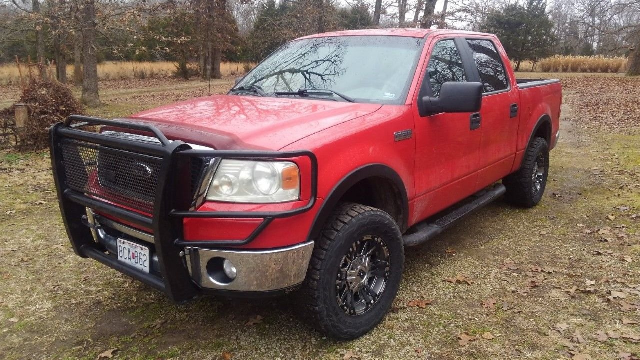

Hahaha I'm still laughing at the story my buddy told me about the grab handle. He used it a lot and one day... BAM Those little screws gave way and he about knocked himself out when he hit the deck. He reinstalled the handle with larger screws and rivets. It's not coming down anytime soon! You have a clean looking truck that serves it's purpose. Mine is clean, serves it's purpose, but is a PITA to get out of.
