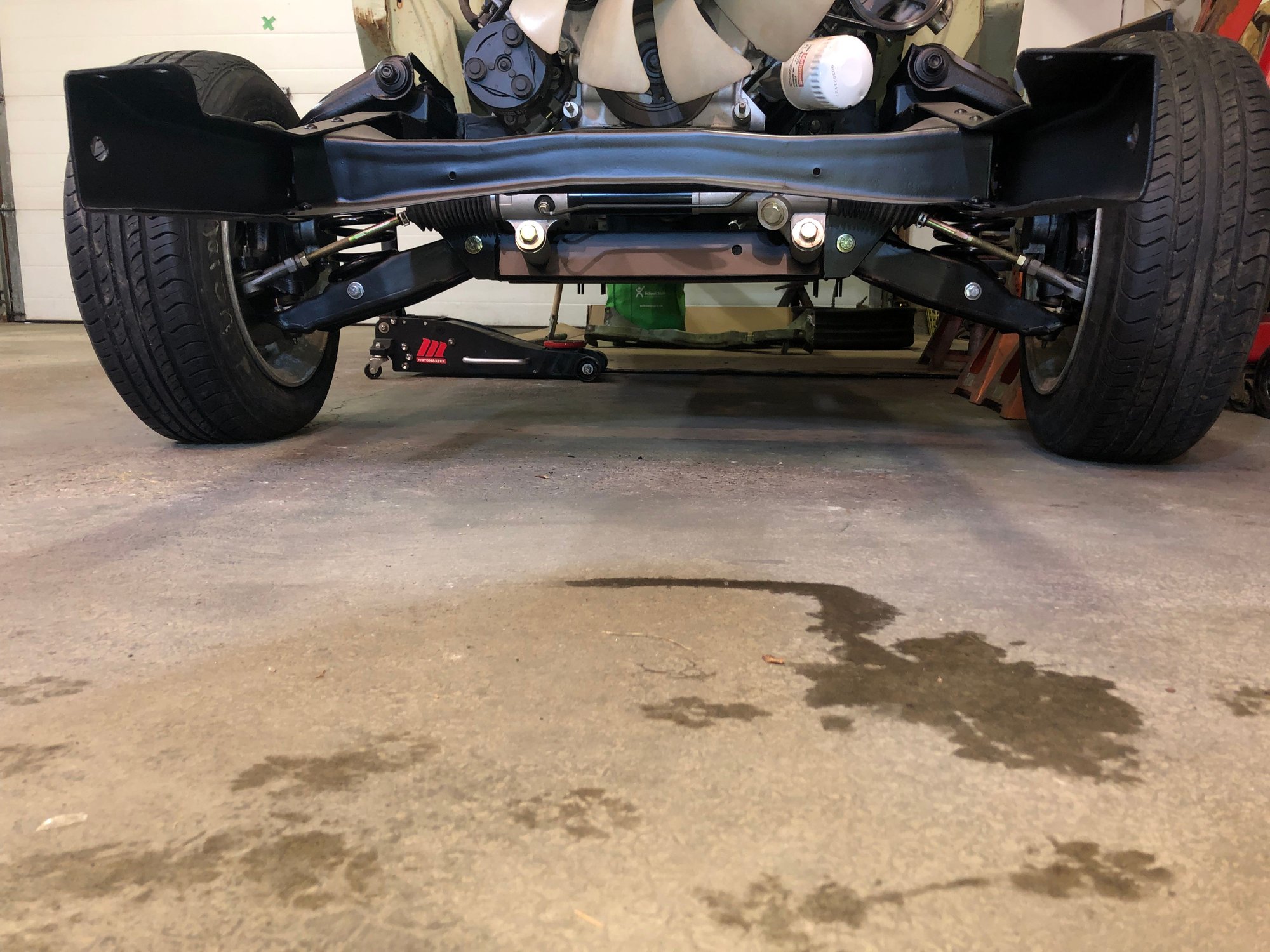

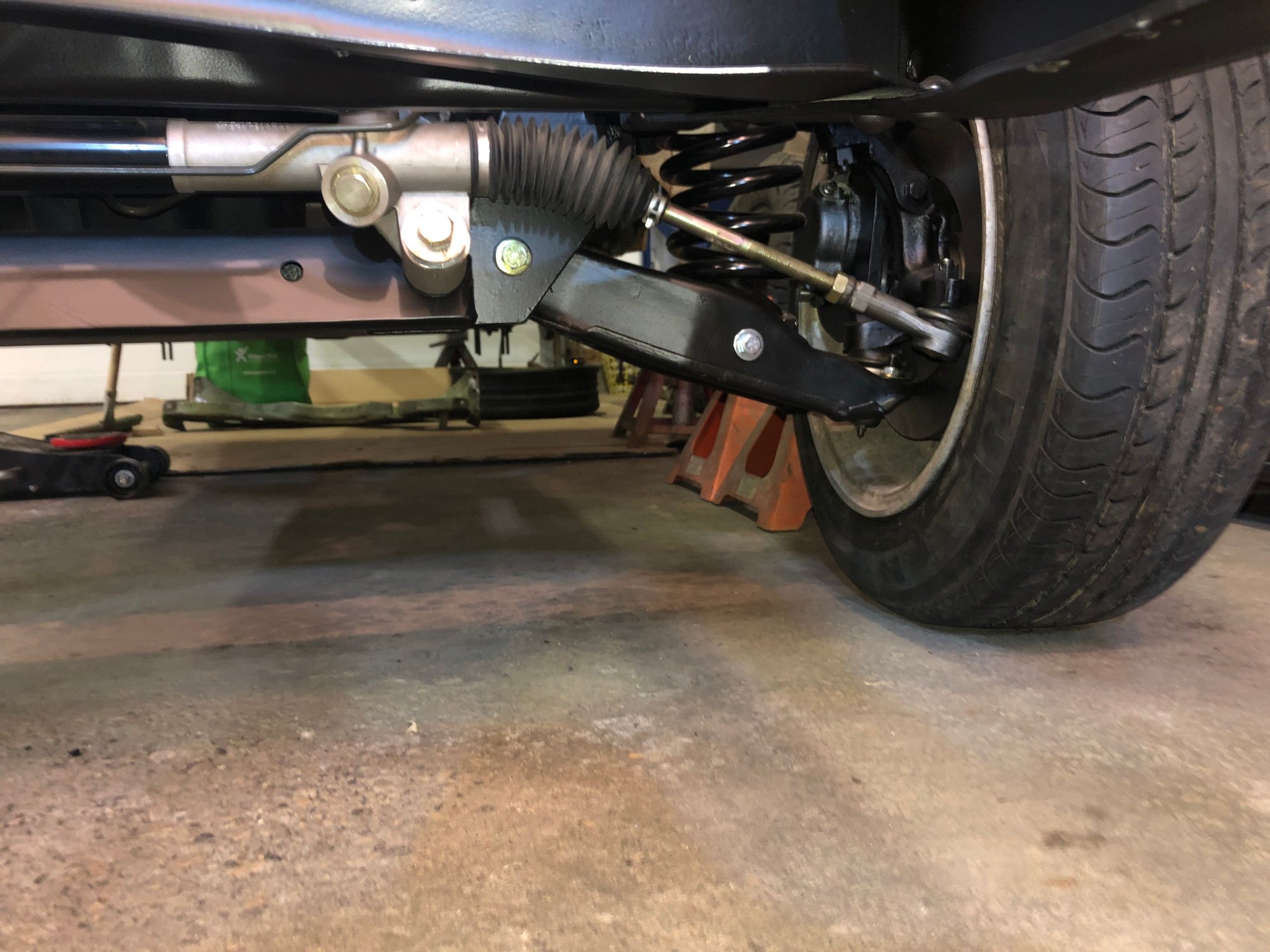

Does anyone know how much I can expect the front end end to drop once all the sheet metal and rad are installed? I am using stock Mustang II V8 springs. Here’s a pic of how it’s sitting with just engine and trans in it.

Ideally, your lower arms should be parralel with the ground at ride height. So whatever the difference is between the inner and outer side of the lower control arm is how much it should drop.

I agree the arms should be parallel. Is it normal to not be able to install the shocks until the suspension is at or close to its normal position? The shocks I have are also oem length Mustang II.

Looks to be way too much spring . I'm not sure what the front end will weigh ( 500 pounds ? ) but I doubt that will bring it down . You would think m11 v8 springs would be in the ballpark . Was this a complete kit ? I guess you could try loading some weight onto the front .

While it looks like the springs are the issue with the ride height, I'm not sure that the springs themselves are the problem. I can't see from the pics where the upper spring "top hats" are located but it looks like they may be too low in the chassis.

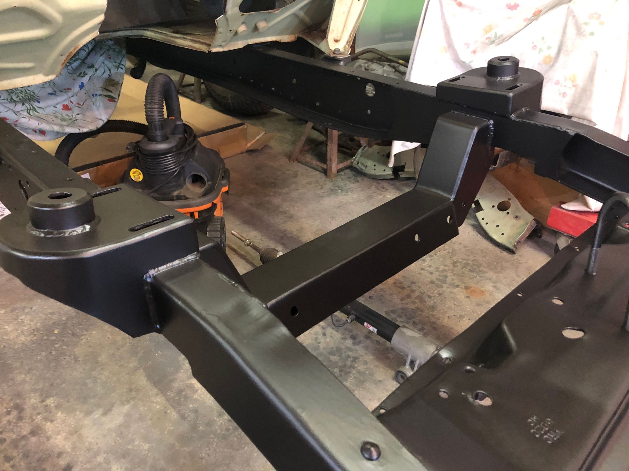

You can see the frame in his introduction thread and I would think it's ok .

I guess unless it was the wrong cross member for my truck but it fit quite nice when welded in. 🤷🏻‍♂️

Never seen the notch in the lower frame before in these trucks with this front end. Was it required in the manufacturer's instructions? Working with the springs looks like your path now. I do not believe the front sheet metal will bring it down. I am with Charlie there may be an issue with the hats and crossmember geometry.

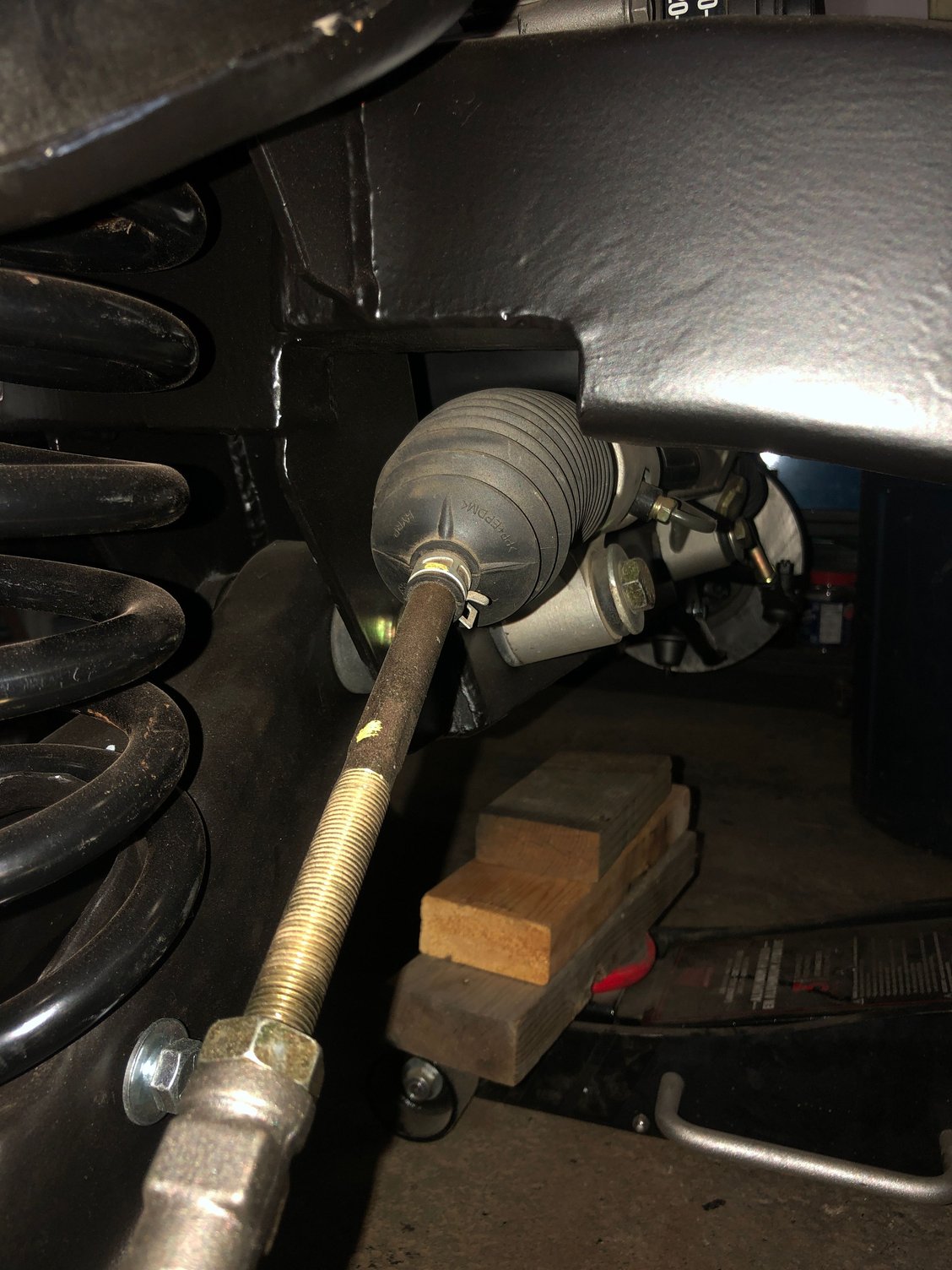

Yeah the notch was needed for clearance to the bellows on the steering rack. I guess we will see how it goes. I hope everything works out. 🤞🏻

The hats look good in this pic. The distance between the R&P and the LCA seems right but the whole crossmember just seems to be too high in the frame. Have you contacted any of the professional suspension manufacturers yet? Brett Vandervort of Fatman Fabrications is very knowledgeable and has some good videos explaining suspensions, here is one:
