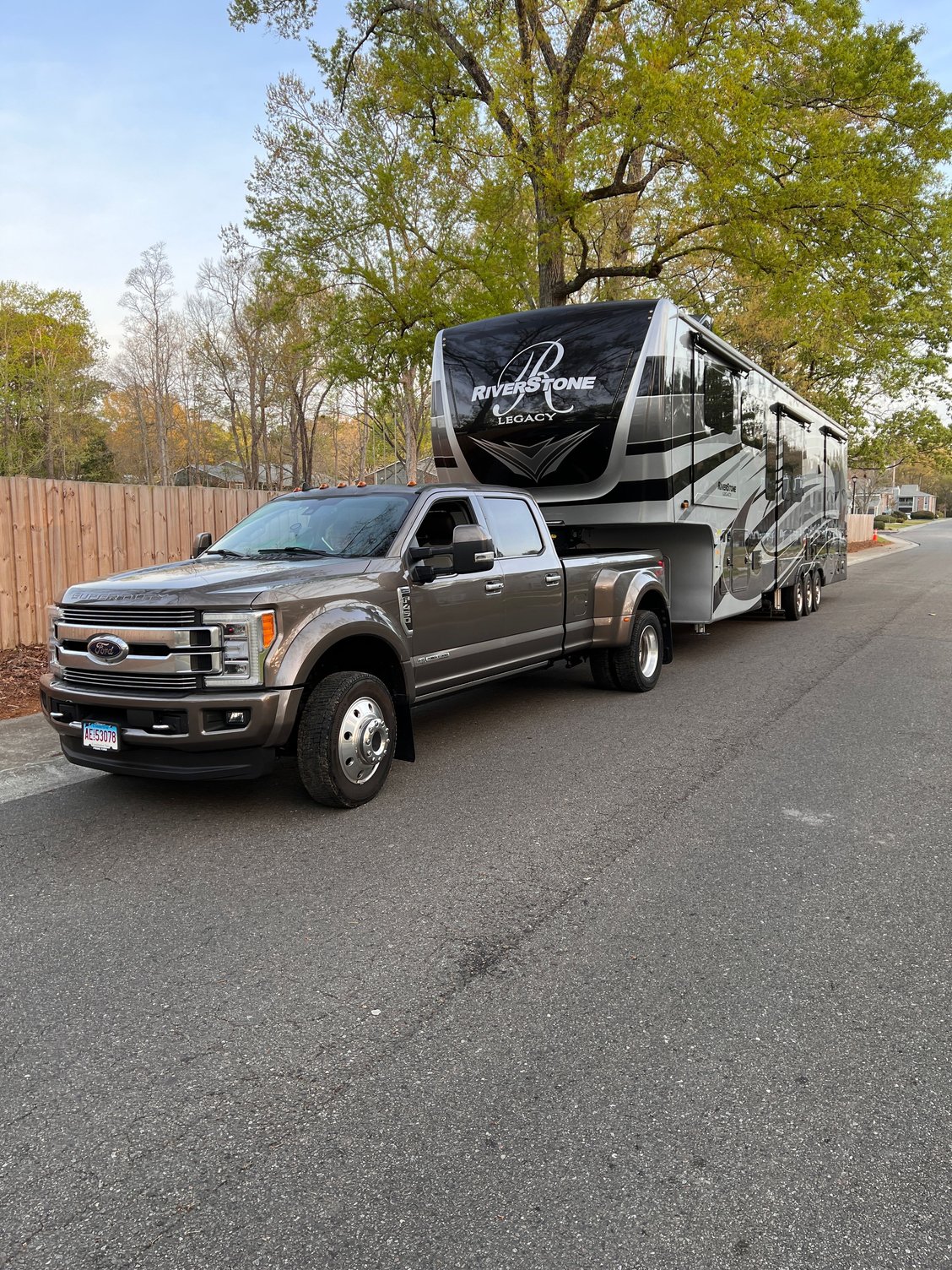

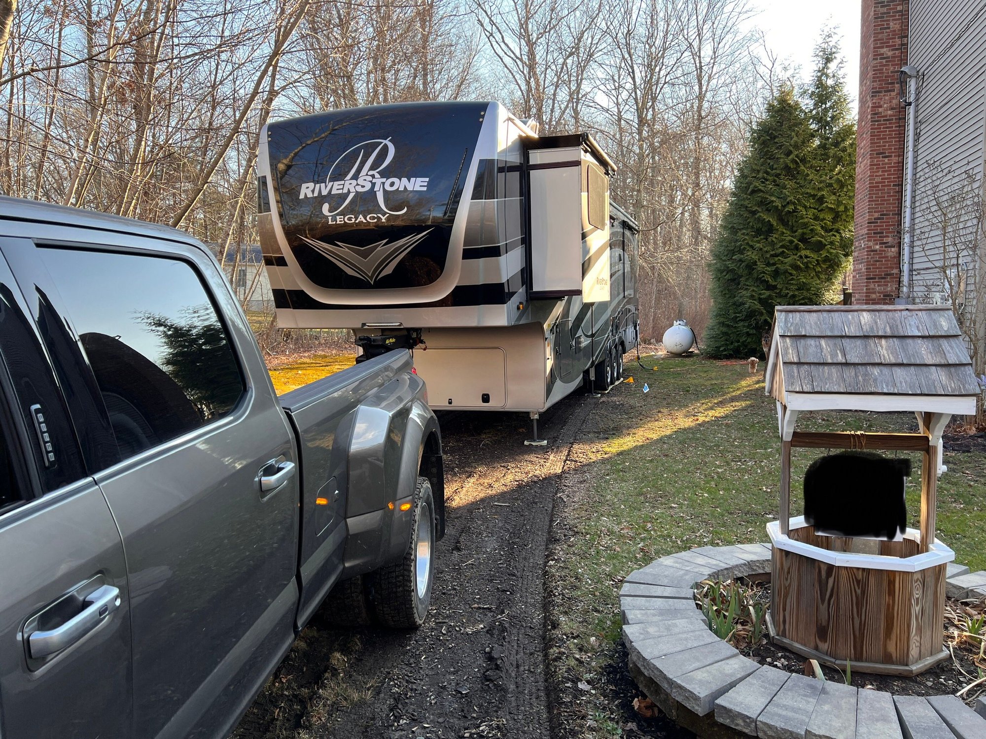

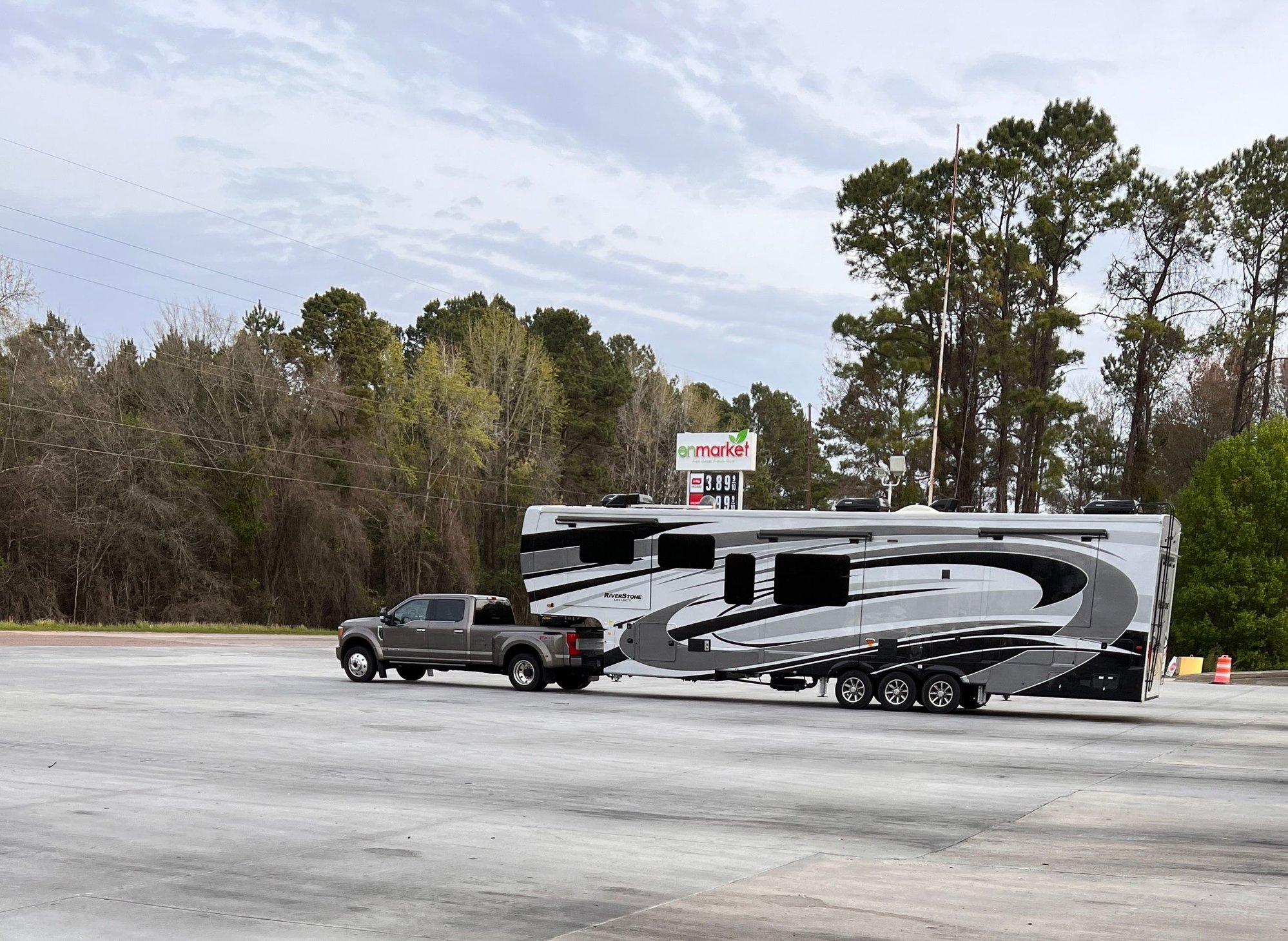

We purchased a 2019 F-450 back in 2019 and had plans to purchase a 5th wheel in the the Spring of 2020. Then Covid happened, and that put our plans on hold until we saw what happened with the economy. Then last September we came across a deal on a 2020 Riverstone 39FKTH with the Mor-Ryde independent suspension with disc brakes, and 4 BattleBorn lithium batteries, at a price that we couldn’t turn down.
We completed the purchase in Charleston, SC in mid-January, and paid the seller rent to keep on their lot (with full hookups) until Spring so we didn’t have to haul it home to CT during winter.
So we just got home with it yesterday, and had no real troubles on the trip home other than getting used to the chucking and bouncing around on some of the worse interstates. Planning to add air bags to the 2022 F-450 when it is delivered to us. Recommendations on airbags would be greatly appreciated.
Thanks for all the knowledge and insights here we didn’t have any real problems.
Leaving Charleston, SC
First time fueling up at a truck stop using the TSD Logistics Card
Home, safe and sound.

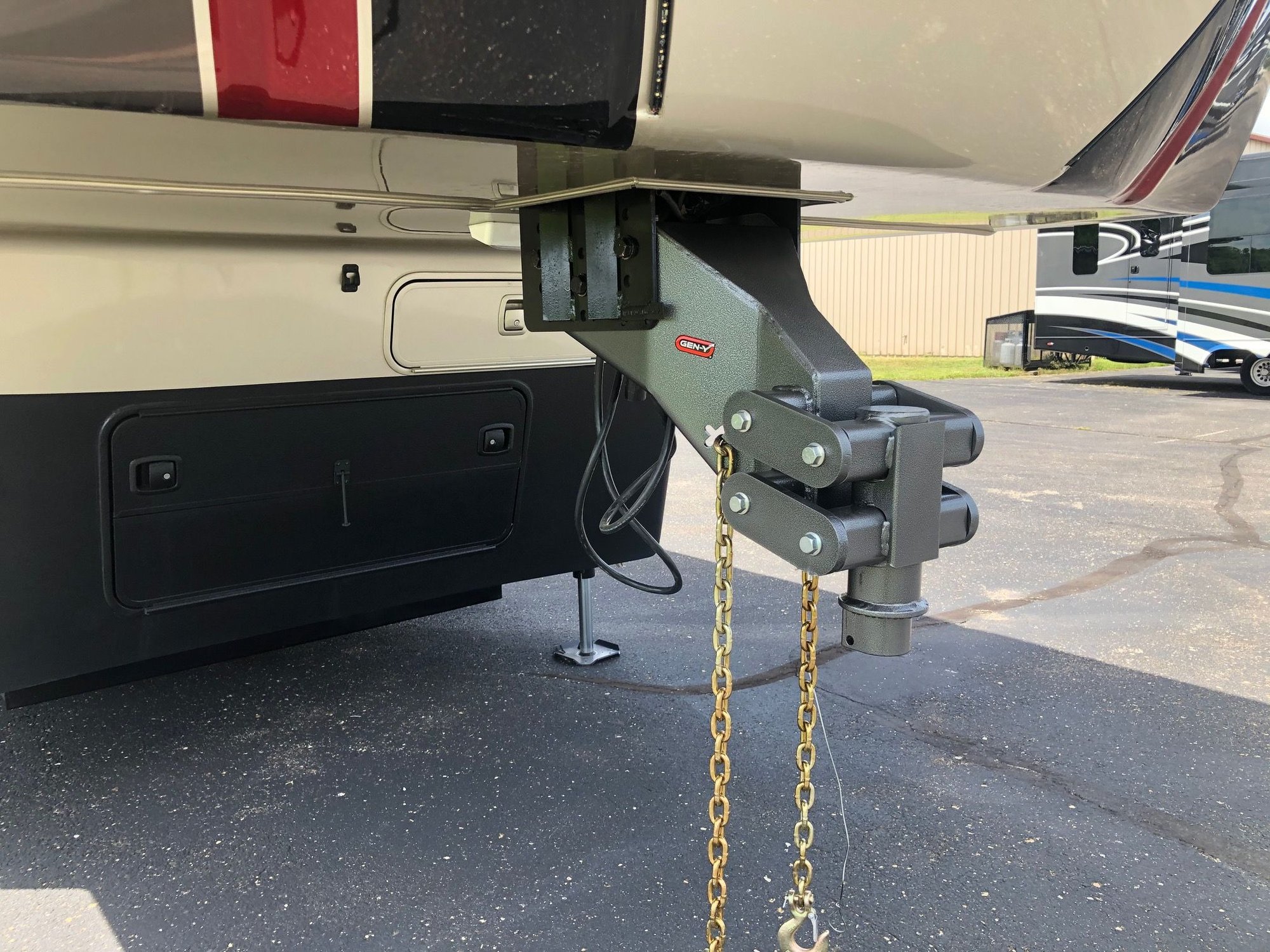

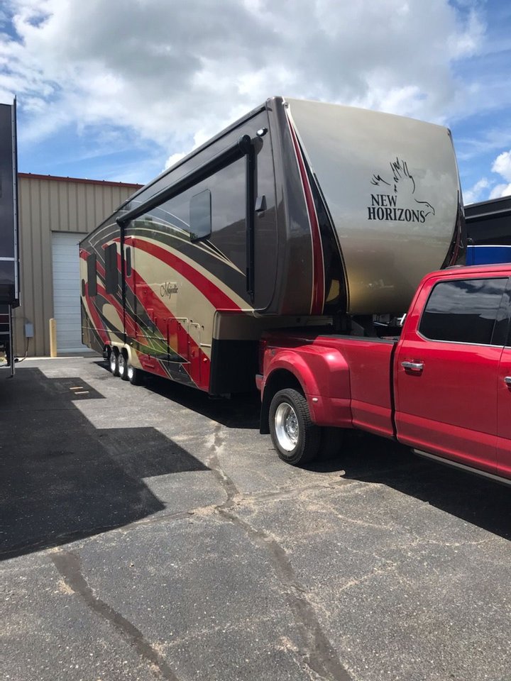

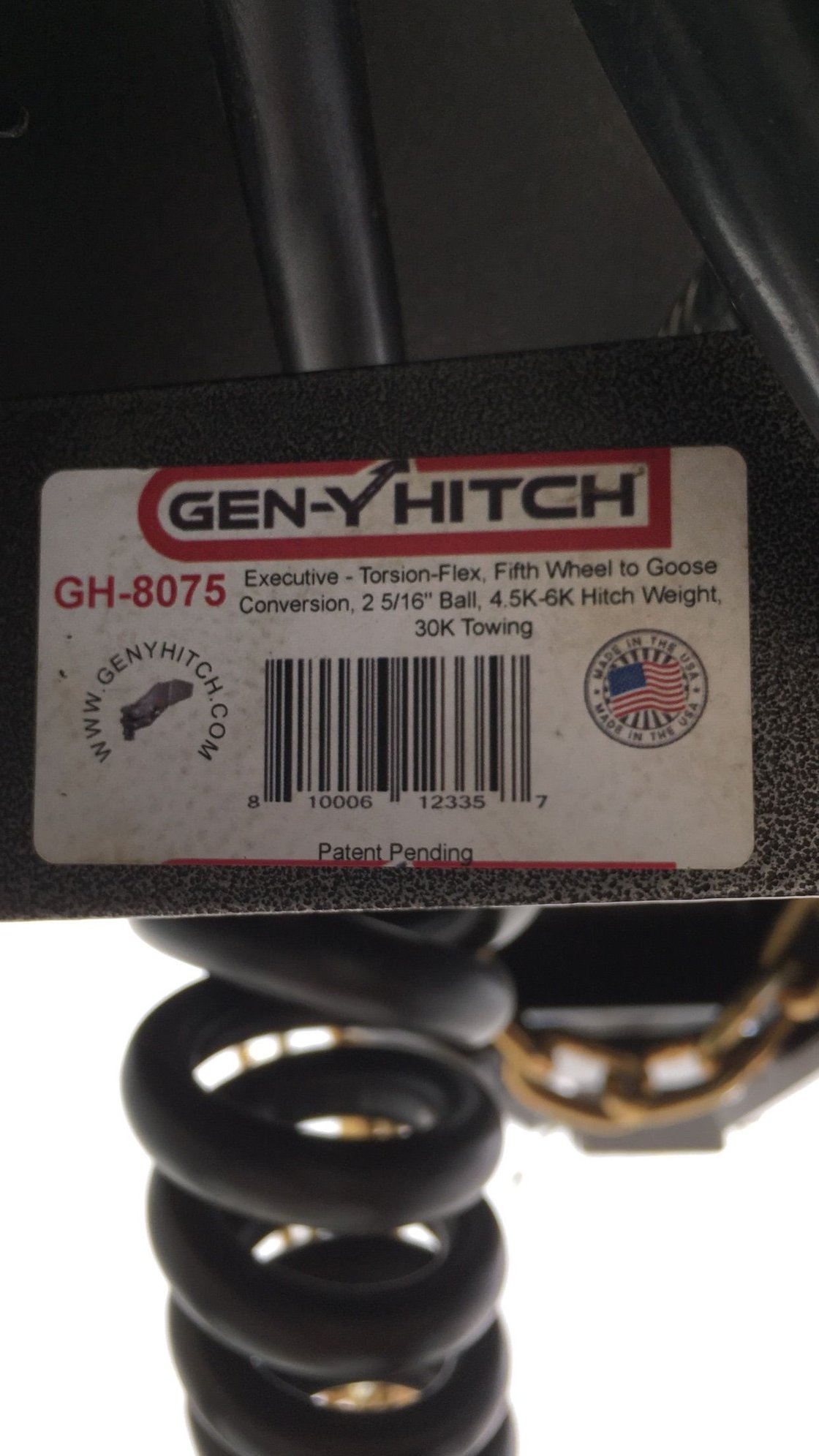

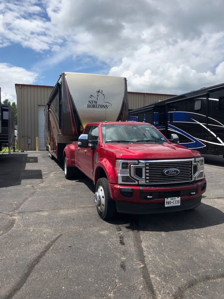

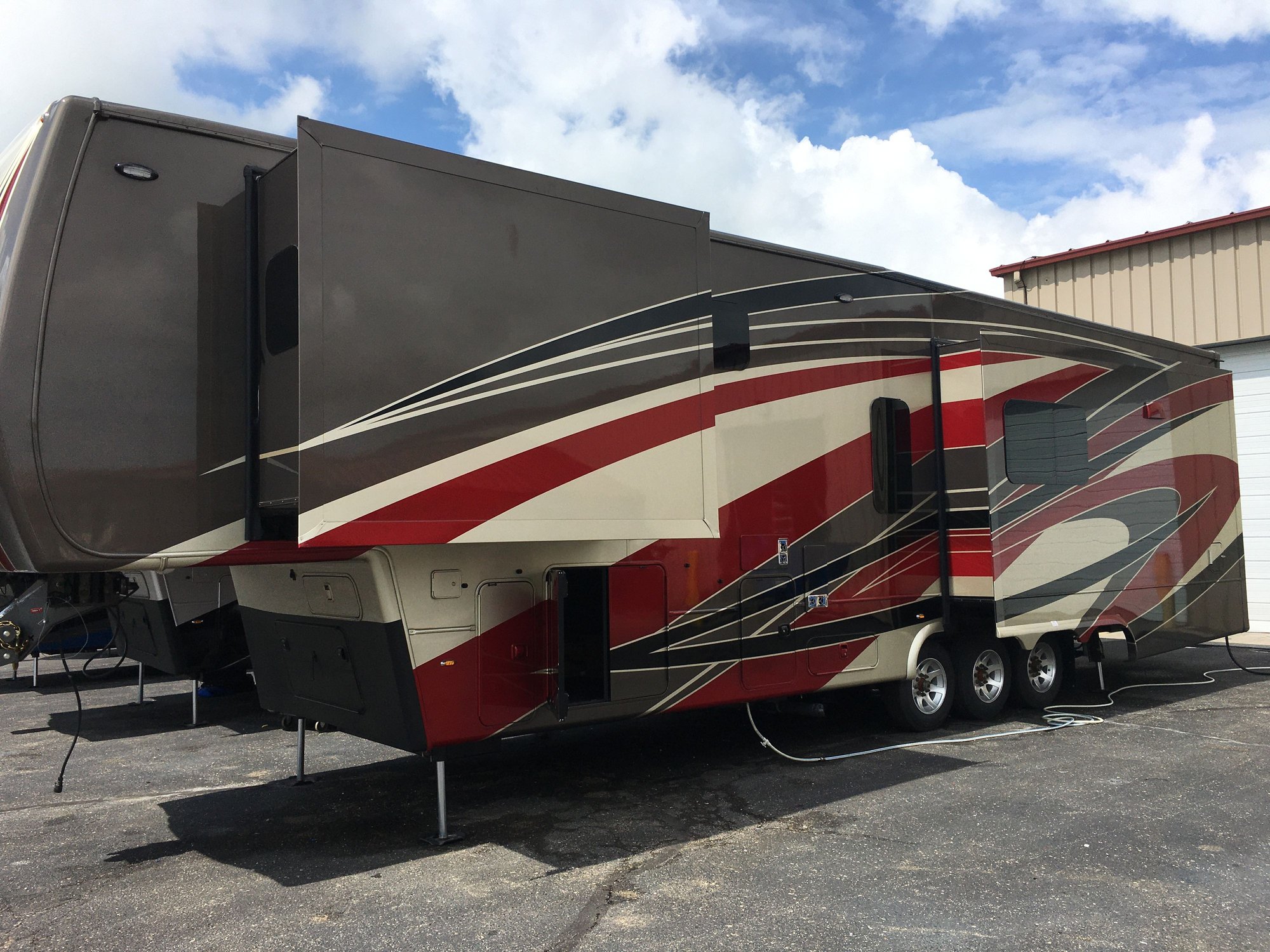

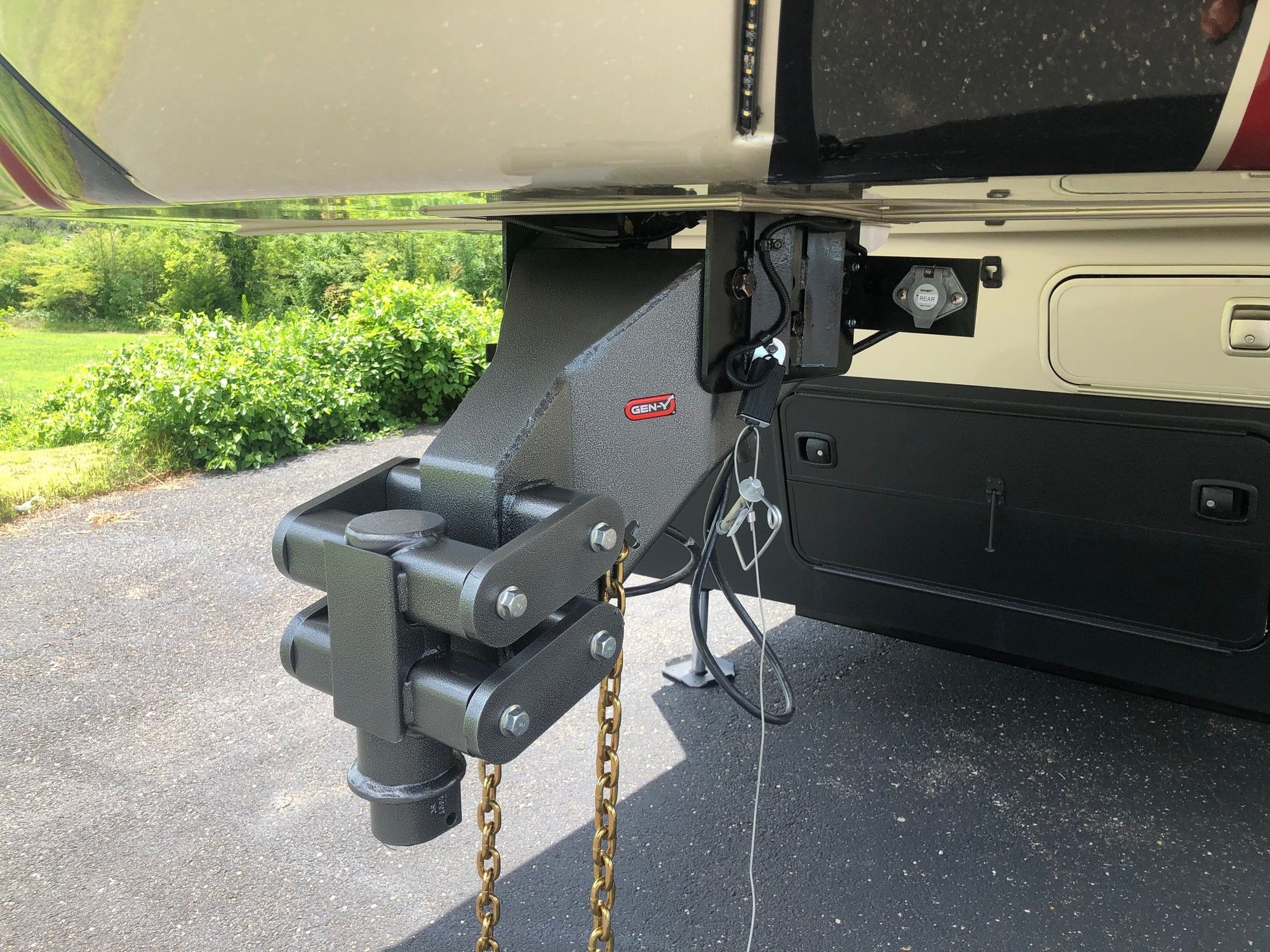

Congratulations on the new rig . Your story sounds similar to ours . We ordered our 2020 F450 and our New Horizons 5thwheel fall of 19 . Lost my job December of 19 and then Covid hit in 2020 . So needless to say we had some decisions to make . We decided to stick to our plan . Picked up the 450 in January 2020 was supposed to pickup the 5thwheel in March but that got delayed , We picked it up in July mostly due to COVID related delays. Didn’t really get to use it until last year due to wife and I getting Covid in November of 2020 . Anyway we love it truck pulls it great . We went with the GenY gooseneck hitch and love it . We didn’t have anything to compare it to since this is our first 5thwheel. Our 5thwheel weighs around 23 k the way we pull it . It’s max weight is over 26k but we will never be there . If you go with a GenY make sure you get the correct weight rating . They have standard weight rating or can go custom if needed . That’s what we did and I love not having a heavy hitch in the bed of my truck. I added airbags after several trips . Not really to help smooth out the ride but more to level front of truck some . I think it did help the ride a little but it wasn’t bad before adding them . I did Firestone 7500 airbags and aAirlift compressor.
